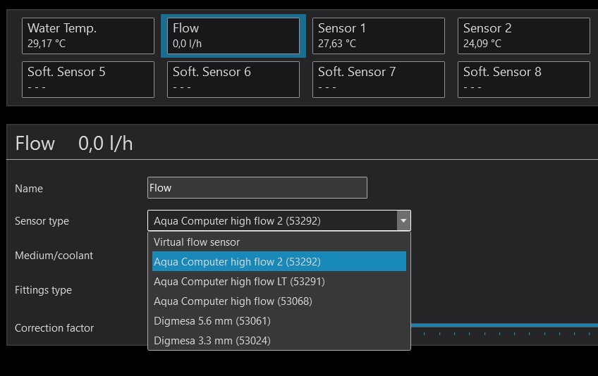

Looking in AquaSite at the Octo, Leakshield and D5 Next there's no option to set the HighFlow Next as the source for flow rate and they all report the rate as 0.
Is this coming or do I need to make some kind of workaround?
Freitag, 21. April 2023, 09:55
Please describe exactly which sensor is missing on which device.
Which source does not work with which device?
Take screenshots of your settings from the relevant devices.
In general, you cannot use flow sensors as a source for temperature control.

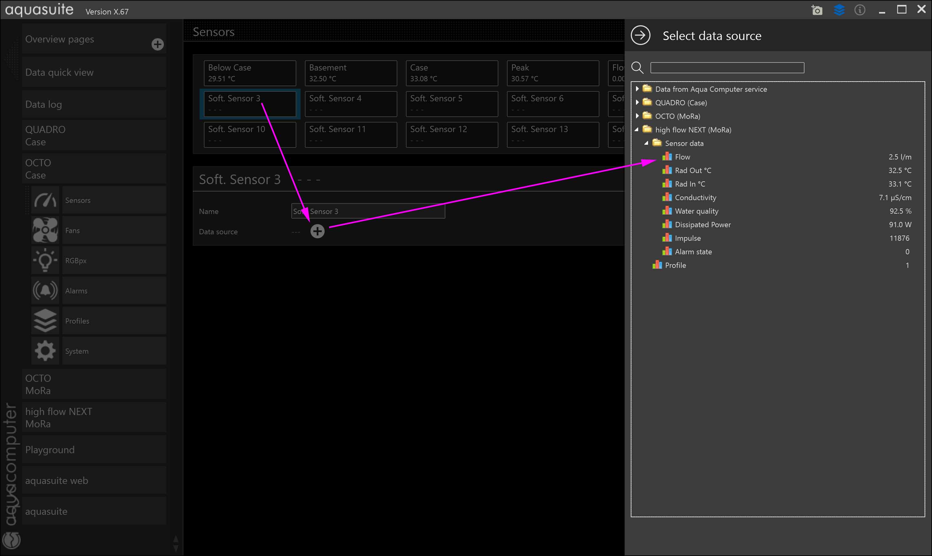

The default Flow sensor for the octo requires a physical connection between the octo and the high flow next.
The more common method used, if both have USB connections, is to Import the high flow next flow-data into one of the soft sensors on the octo [import_sensor.jpg]
The more common method used, if both have USB connections, is to Import the high flow next flow-data into one of the soft sensors on the octo [[attach]10220[/attach]]
Oh, that seems to work fine. Thank you kindly.

The Next isn't listed as an option, and all the available options gives a 0 flow response.
Samstag, 22. April 2023, 06:39
this is correct, you can not connect the High flow next. This is the pysical 3 pin flow input.
And when you connect the Signal Output with flow input, you have to select 53068 (look at the manual).
