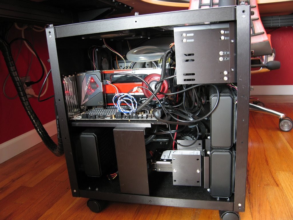

I've only had the Aquaero 6 about 2 years and when I built the system 10 years ago, I was using a 5.25" fan controller with a bunch of pots. It was three pin only so I got 12 of the DC 3 pin fans. Which was fine as I have three 360 RADs and the fans can mostly just set on the lowest speed.
You can't see in the pic but I have the three SPLITTY9s just setting on top of the from RADs and I have plenty of SATA connections but the cable management to their current location will be a pane.
I also see there is a pot on the SPLITTY9 Active. To set the base amount of power?
