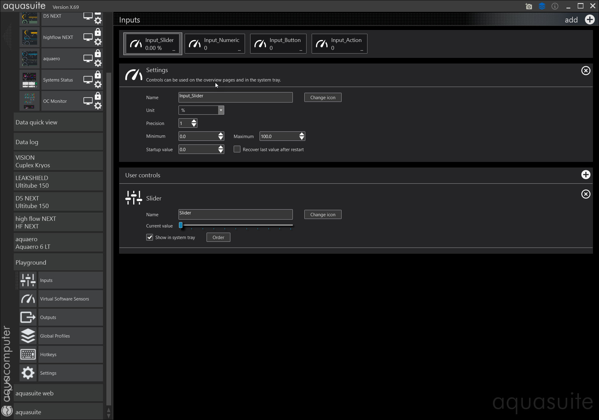

1. Create the slider
2. Use playground to create a virtual software sensor that accepts slider values as input and outputs the slider values as degrees C
3. Create a curve controller in the Aquaero that accepts the virtual software sensor as input, scales input(C) to output(%) 1:1 and outputs the scaled value into the target fan(s).

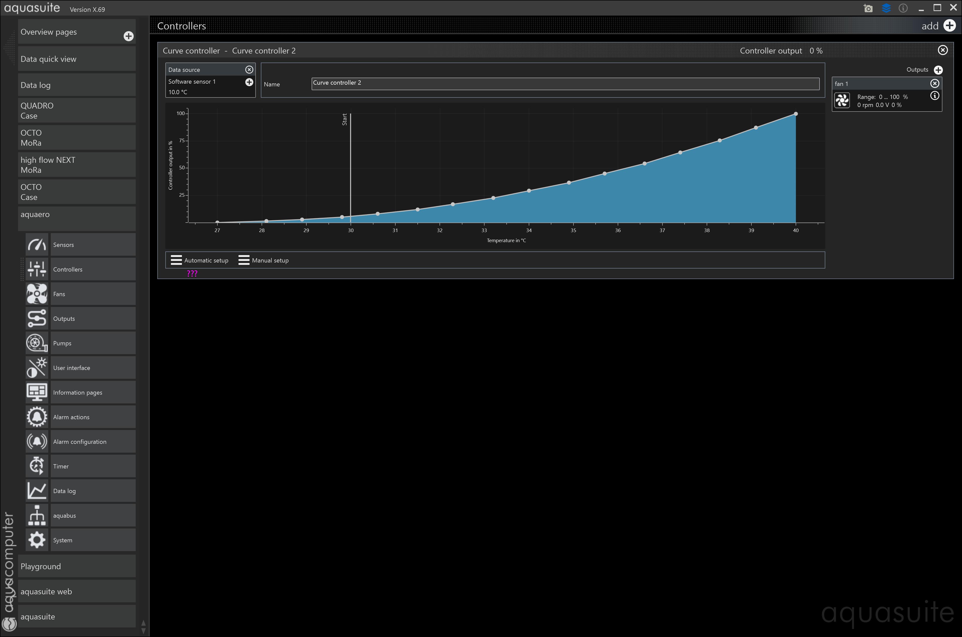

I had an aquaero 6XT in storage and attached it to the system today.
It appears the aquasero has not been updated to accept the Input function, or any of the Playground functions for that matter.
octo controller: octo.jpg
aquaero controller: aquaero.jpg
As to why, the aquaero 6 was introduced years before the newer octo et all, and upgrading the aquaero may not be feasible.

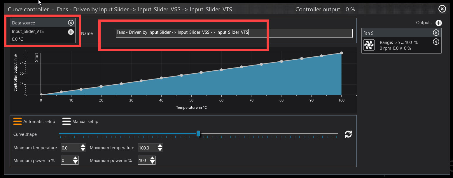

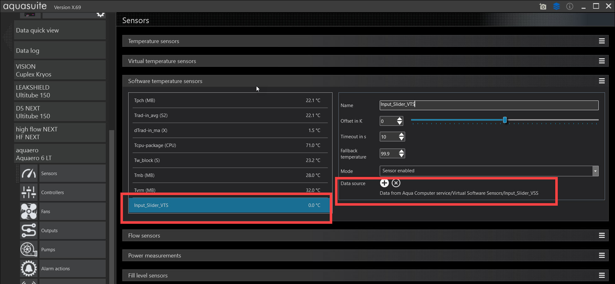

True - the Aquaero Curve Controllers do not accept Playground VSS DIRECTLY. But they do accept Software Temperature Sensors which may be Playground Virtual Software Sensors. So the "workaround" sequence is:
1. Create the Input Slider
2. Create the Virtual Software Sensor ( Input_Slider_VSS with temperature output ( C ) )
3. Define a Virtual Temperature Sensor ( Input_Slider_VTS ) as Input_Slider_VSS ( Correction: Define an "Aquaero Software Temperature Sensor")
4. Create the Curve Controller using Input_Slider_VTS as Input
See the attachments.

Thank you demilleroh, that works great.
My problem was I saw the Software sensor source 'virtual sensor' option and assumed it was the aquaero's internal virtual sensors.
