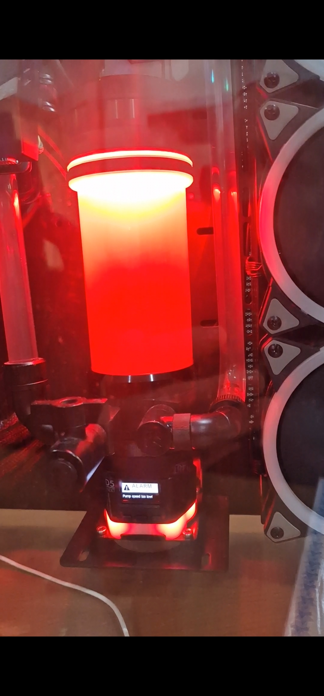

I had the following problem. About 6 months ago (I don't remember the exact time) I replaced the water pump with a new one (the base to the tank cracked on the old one and there was no way to replace it). I decided to get Aquasuite's D5 Next tank combo. The pump was working fine until about a month ago. The problem is that when I start the computer and the system detects that there is no rotation of the pump or Pump speed is too low. Blinks, write different each time between 2-30 seconds. Apparently, at different times, the current also starts, and I don't know what is happening. This happened since my last coolant change, but I don't believe it's because I updated the bios on the bottom the same day. I made all kinds of attempts, put in a new bios, changed the usb ports on the bottom for the controller, the cable to the power supply is independent, i.e. direct, and still the same. I looked around other forums for the same problem, there are similar ones, but not my case. All I have to do is reinstall the computer, but I'm looking for this to be the last option, because I have a lot of things to fix later, including settings for 3D printing programs. A lot of time wasting will take. I have a video of the problem, but I don't know how to upload it.
Edit:I just want to point out that after the alarm that I gave is between 2-30 seconds different every time, the pump starts normally and works normally without any problems.

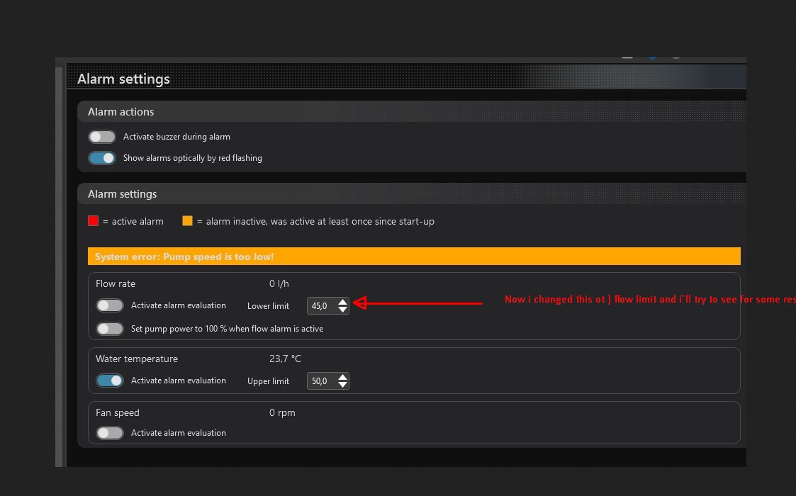

could you provide a screenshot of the alarm settings in aquasuite?
Maybe the min. limit of the flow is set to low when the coolant is cold?

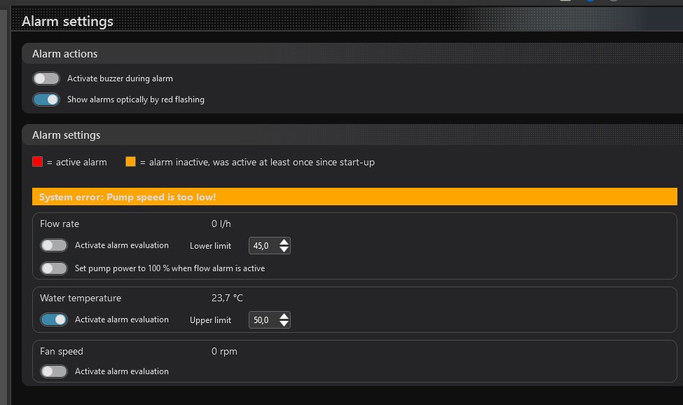

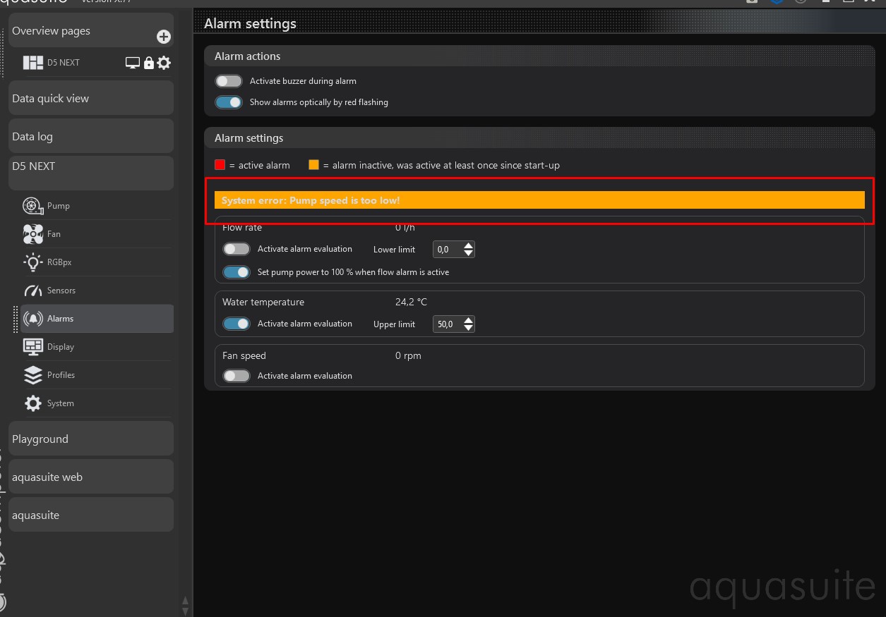

Do you work with different Profiles for the D5 next?
The flow is low, but it was like that before. I run it at 5% at 23 degrees and never had a problem actually. It still works like that right now and doesn't give me any problems. The only problem is when I start the computer. then it starts and runs perfectly increasing and decreasing revs and flow relative to fluid degrees
Edit: Now i changed flow to zero and i`ll see if there is some changes.
Result: Same alarm for 3seconds. (last picture)

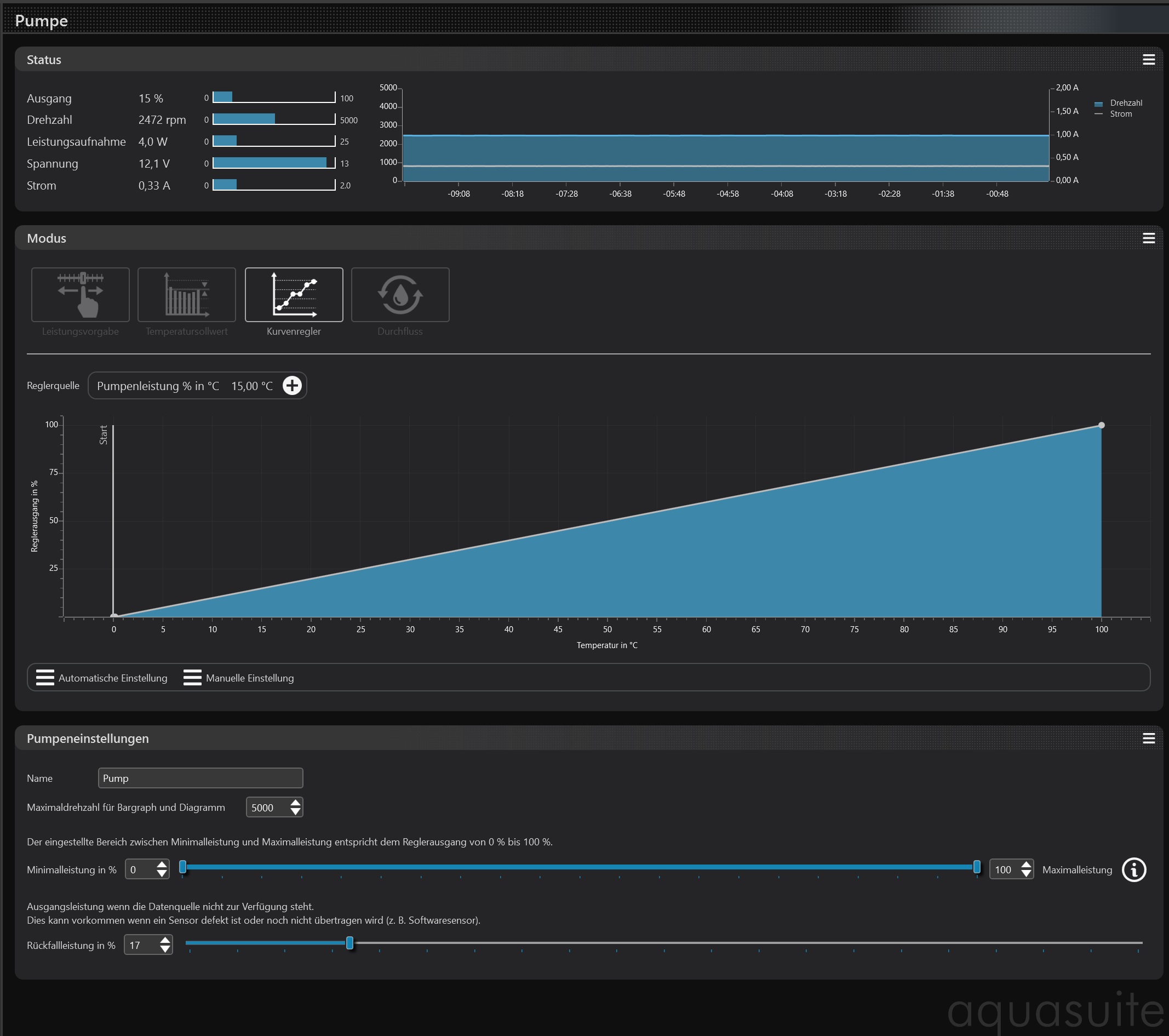

Could you show us the status page of the pump when the error occurred, including the Modus (see my example)?

I had a look at how my D5NEXT behaves, the last time I filled it a few months ago I was able to set the pump from 100% to 0% to support the venting without any alarms going off.
Now with the Aquasuite X.77 I can get down to 14% without any problems, at 13% and 2479 rpm the pump shows an alarm and starts flashing.
I don't think this problem is due to the hardware, as there hasn't been a firmware update for the D5NEXT for a while.
Aquacomputer should probably have a look at what is going wrong.
