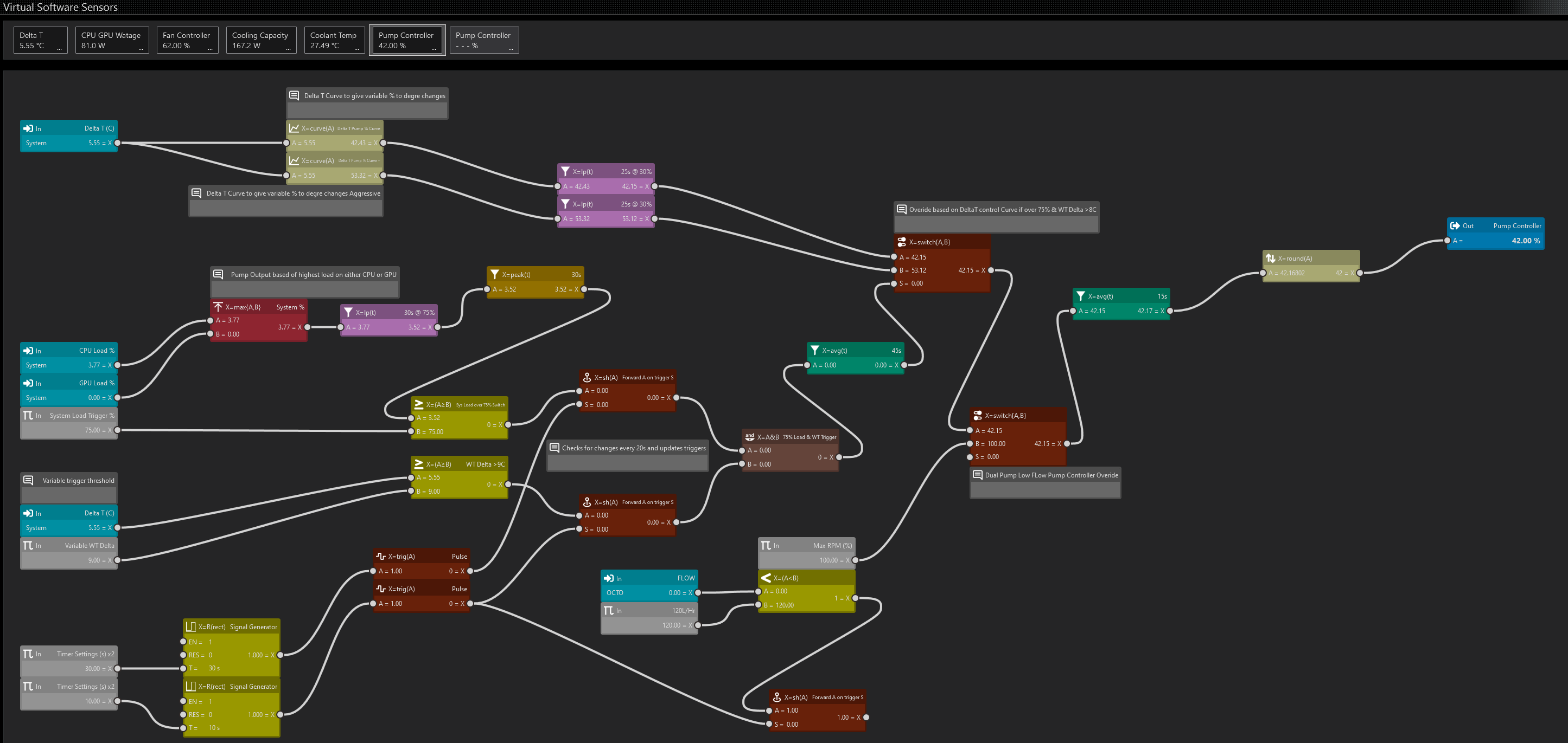

Aquasuite: Controlling your Pumps/Fans with virtual sensors and automatic condition based curve switching.
Dienstag, 16. Januar 2024, 07:57
This is a virtual sensor I came up with to allow me to run two or more curves on the same profile for a fan or pump header. Within the sensor I can configure triggers so that the fan/pump will switch curves when system conditions are met.
As im not as versed in posting to this forum here is a reddit post linked with the guide.
https://www.reddit.com/r/watercooling/co…s_with_virtual/

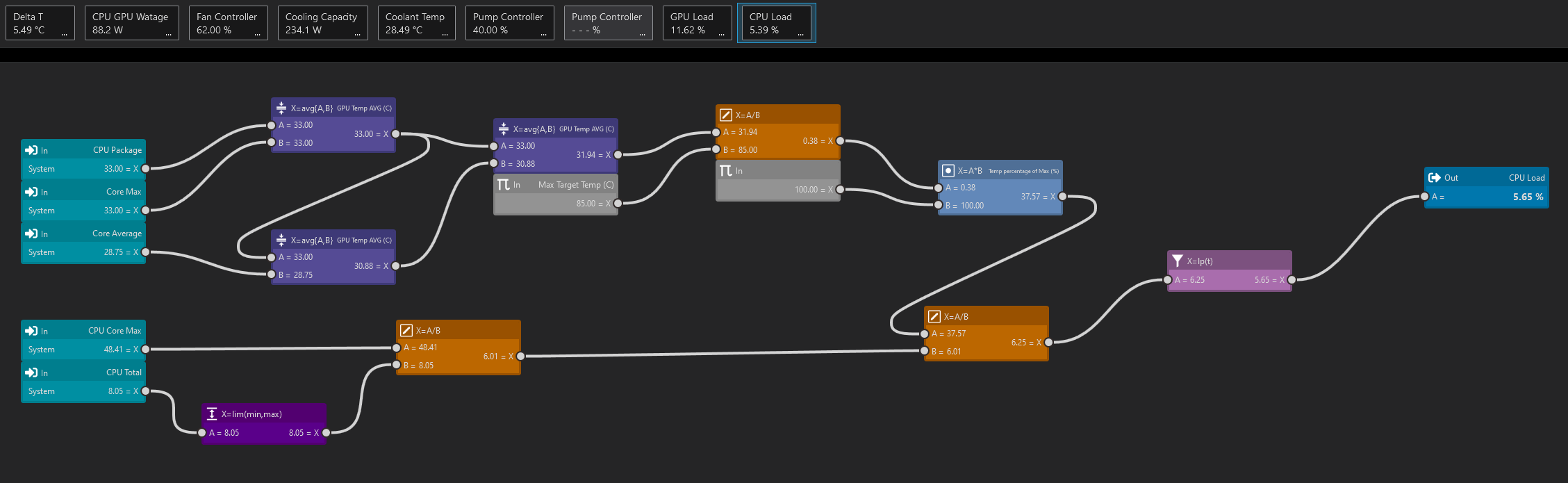

CPU/GPU load virtual sensors for more data driven load values.
CPU
GPU
https://pastebin.com/ASTEEz3S
Pump controller V4.1 Virtual Sensor XML code for importing into auquasuite
It's constantly evolving and it has changed already since typing this... mostly just playing with filters lol.
Enjoy ! Hopefully some of you can find a use or share with me what you would change/improve.

the first thing that came to my mind when looking at it is that Aquasuite already has automatic profile switching based off whatever you want.

It was quite fun. And funny enough I did make a Rube Goldberg machine years ago.
The main reason besides experimentation was to develop a way of increasing the pump speed when it’s needed most and only then. Increasing flow rate will move more heat from components to the radiator. If the fans are maxed the only thing you can do is speed up the pump or lower ambient temp to gain additional cooling. In the case of fans it can be used to shut them off completely when delta T is a value you set for silent operation until load or temp increases. I currently don’t have a flow meter installed but am building a dual pump parallel x flow rad setup that will utilize two flow meter. Both before the manifold to ensure I can tune equal flowrates through the rads, should I decide to split the manifold through waterblocks of different resistance. Something like this allows me to take full advantage of the higher delta T of parallel rads while also minimizing restriction for all the QDC’s. It’s a custom case I’m building in solidworks for minimal footprint and ease of maintenance. It needed an overkill virtual sensor to go alongside. :D
Creating this sensor also seemed less daunting then setting up two or more profiles to switch back and forth on conditions. But I certainly could use this to drive outputs and switch profiles and achieve the same result. It is much easier to tune it all being integrated into a single virtual sensor, less confusing as well.

Time to do some tests and log.
  • Delta T waterblock-coolant
  • Delta T coolant-ambient
  • System Wattage
  • Pump speed
  • Flow rate
  • Fans set at a constant 100% so my radiator will be performing at its max given ambient temp
Since its so heavily dependent on your radiator surface area and fan's CFM(CMM).
What Delta T are you getting at your radiator?
edit* stupid question lol
What Delta T are you getting at system Idle? and under system Load?
Since the temp plays such a large factor for efficiency i'm curious what number you are seeing.
Dieser Beitrag wurde bereits 1 mal editiert, zuletzt von »DeathToTheWind« (19. Januar 2024, 16:08)
