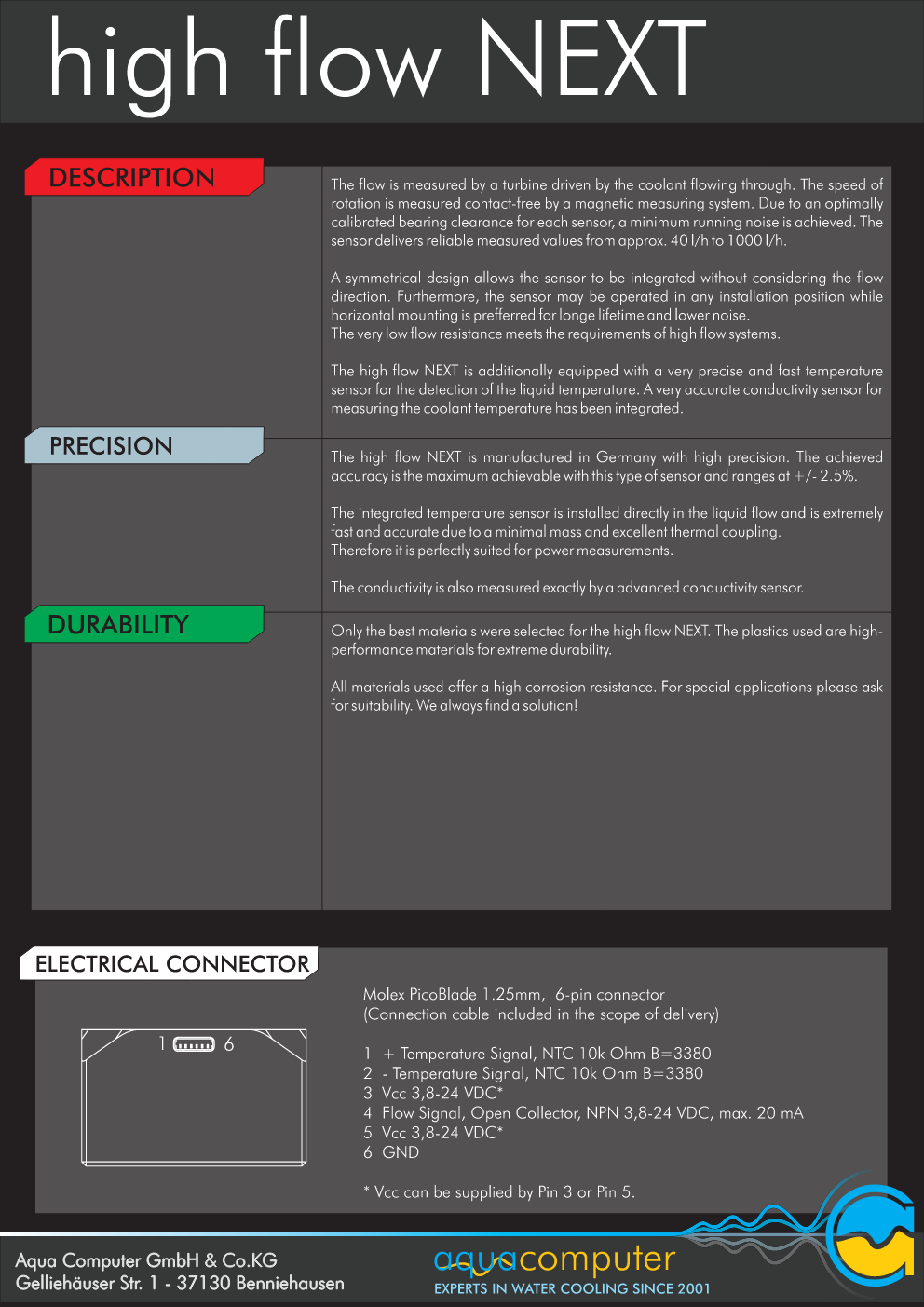

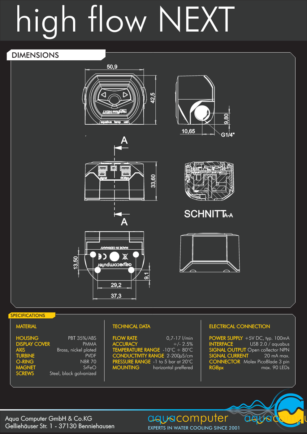

The High Flow Next spec sheet says it can be operated in any orientation but horizontal is preferred. If it worked fine when mounted vertically but stopped working when mounted horizontally but upside down, then perhaps horizontal upside down is the problem. A picture of the device with the cover removed is below, along with the specs. Maybe the rotor is making contact with the top of the case and cannot spin properly? I suggest inverting it so its is horizontal but not upside down. I can't see your loop but it seems to me that you could loosen the fittings a bit on each side, spin it 180°, then tighten the fittings back up. If you have to take it out of the loop to RMA it, you could replace it with a short piece of tubing that is the same length as the High Flow Next. The device is 50.9mm wide (2.00"). You could also probably replace it with a 2" or adjustable extension fitting.

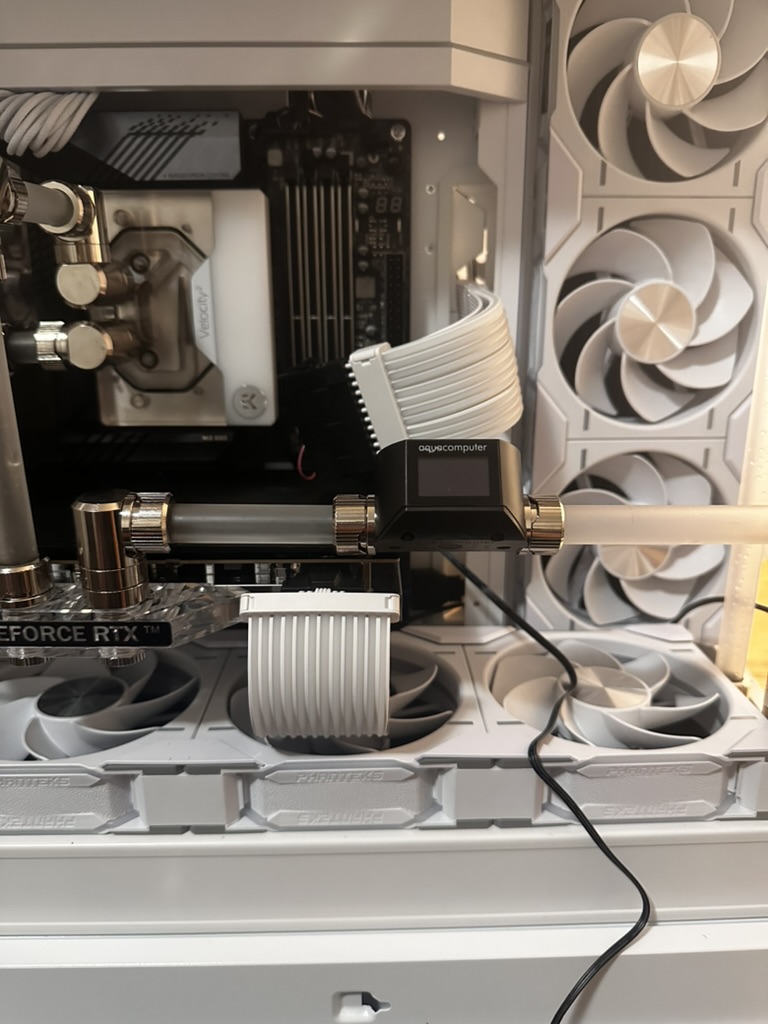

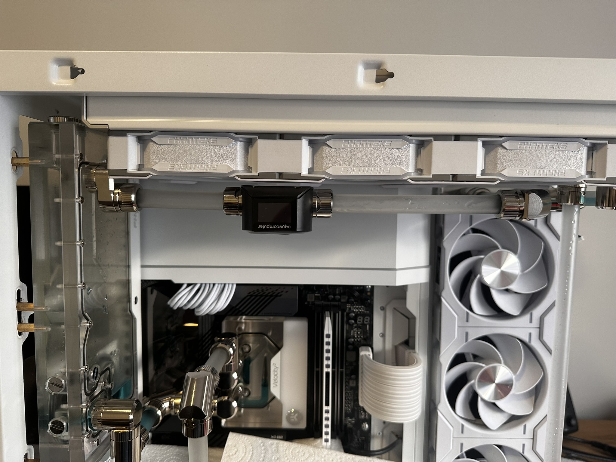

Hi thanks for the reply, I really do appreciate any help I can get with this one.
I have uploaded several photos one of the old orientation and one of the new orientation.
In any case if I spin the unit 180 degrees I won't be able to see the screen at all. However I could potentially do that just to see if it starts registering the flow but It wouldn't help if it's internally making some kind of connection.
I can also hear the rotor spinning its like the unit has just decided to stop counting the flow even though it clearly has flow moving through it.

So all good points, but I can't flip it the other way around because it hits the fans due to the thickness and where the ports are as they aren't centered on the unit.
I originally tried to do It from the gpu to the radiator but this unit is so thick it hit the glass because the GPU block stands out further than average. After that I tried vertical but it was making a ticking noise at 150 Litres per minute which is why I assume they say they recommend doing it horizontal appose to vertical. That and I didn't like the screen being sideways.
Which is why I ended up mounting it where I did as it was the only other place in my loop. I also know your meant to have about 10cm run between angled fittings to give it the most accurate reading.
So I absolutely would flip it if I could even just to test it. But There really isn't anywhere I can.
