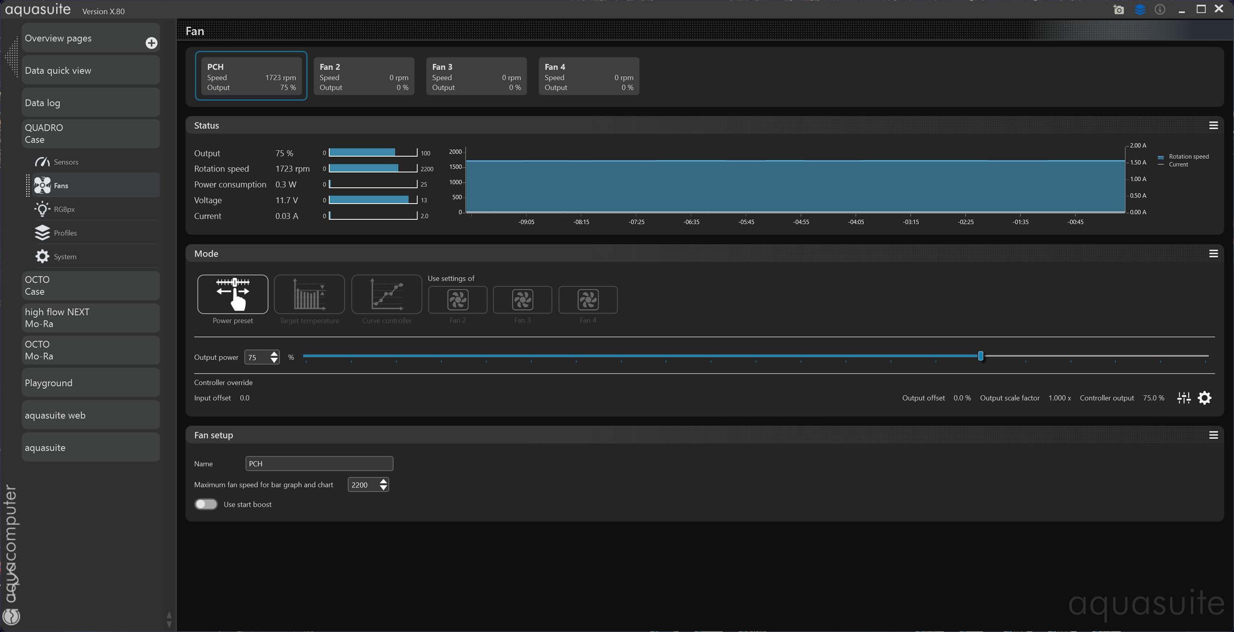

Yes, the quadro shows in the aquasuite as you suspect it should [quadro.jpg]
Check if your USB connector at port 4 on the hubby 7 is properly centered
The sockets for ports 2,3,4,5,6 & 7 are wide enough to allow the connector to be shifted left or right by one pin.
