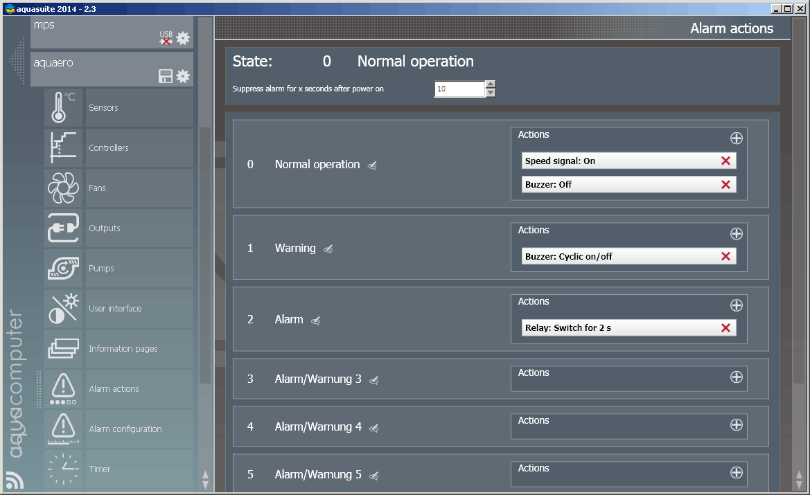

Make sure that the extended green wire of the adapter is cut and the ends are connected to pin 1 and 3 of the relay plug.
The rest only depends on your alarm configuration. Here is a simple example for a shutdown based on a temperature alarm:

solved, only it is a pity that I can not find it in the firmware
Freitag, 14. November 2014, 16:06
It can be also configured directly with the device.
Main menu -> Alarms -> Alarm and warning levels -> Alarm (for example) -> 1st action to be performed and so on.
Pretty much the same way to setup the alarm limits.
