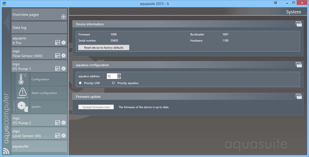

Freitag, 22. Mai 2015, 03:30
Your Pump Controller starts at 35 and has start up at 35.5.
Your source, "Liquid", is at 28.5, so the controller is set to zero.
Can you give a screen shot of the Pump>System tab?

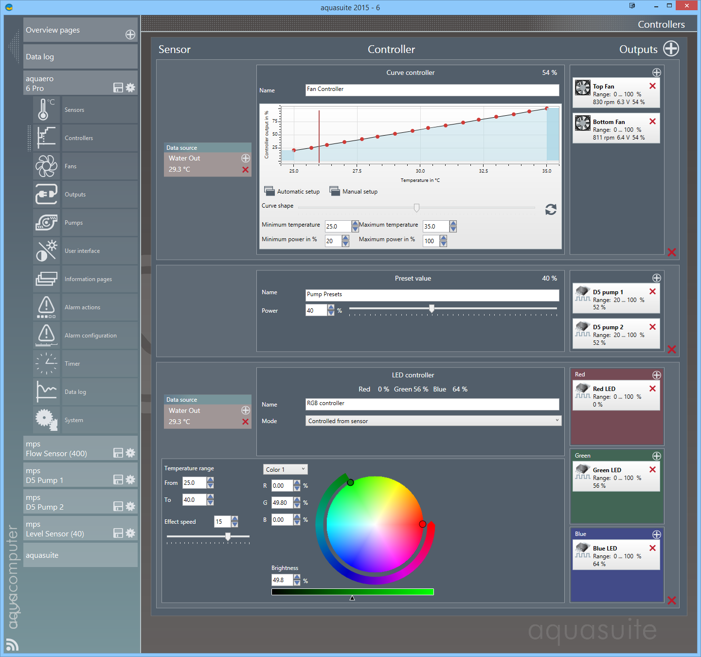

Freitag, 22. Mai 2015, 13:25
After connecting the USB cable the showed mps panel... Now actually heard that pump slows down.
1. The question to which turnover set the pump - what to give a maximum flow (l/h) and what minimum flow (l/h)?
2 I've heard that people buy pwm pumps 1-5 and set the switch to the 2-3 and already leave forever. In our case it will be 35-50%?
]And what of the fans?
1. What can be the minimum liquid temperature and what the maximum?
I want to set halfpassive mode.
There are many theories on how best to work a WC loop. I'll share my thoughts and maybe others will share theirs.
The loop setup depends on the loop makeup, and also on your ambient air.
During the summer my ambient can be in the 28C to 30C range, and since the radiator cannot cool below ambient, my loop will not be cooler than that.
I have my pumps on a Preset Value controller... I adjust them for a water flow around 200 L/H, and leave them.
I am still playing with the fans, and tried to tie them to the Water Out vs. Ambient Air, but the range is too small and noise probably influences the controller.
At the moment I have them set on a range from 25C to 35C, so they are 100% when I get 35C.
I also do not like my fans stopping and starting all the time, so I have a 20% minimum hold on them.
If your ambient is lower, you may want to drop the lower temperature to have more control.
