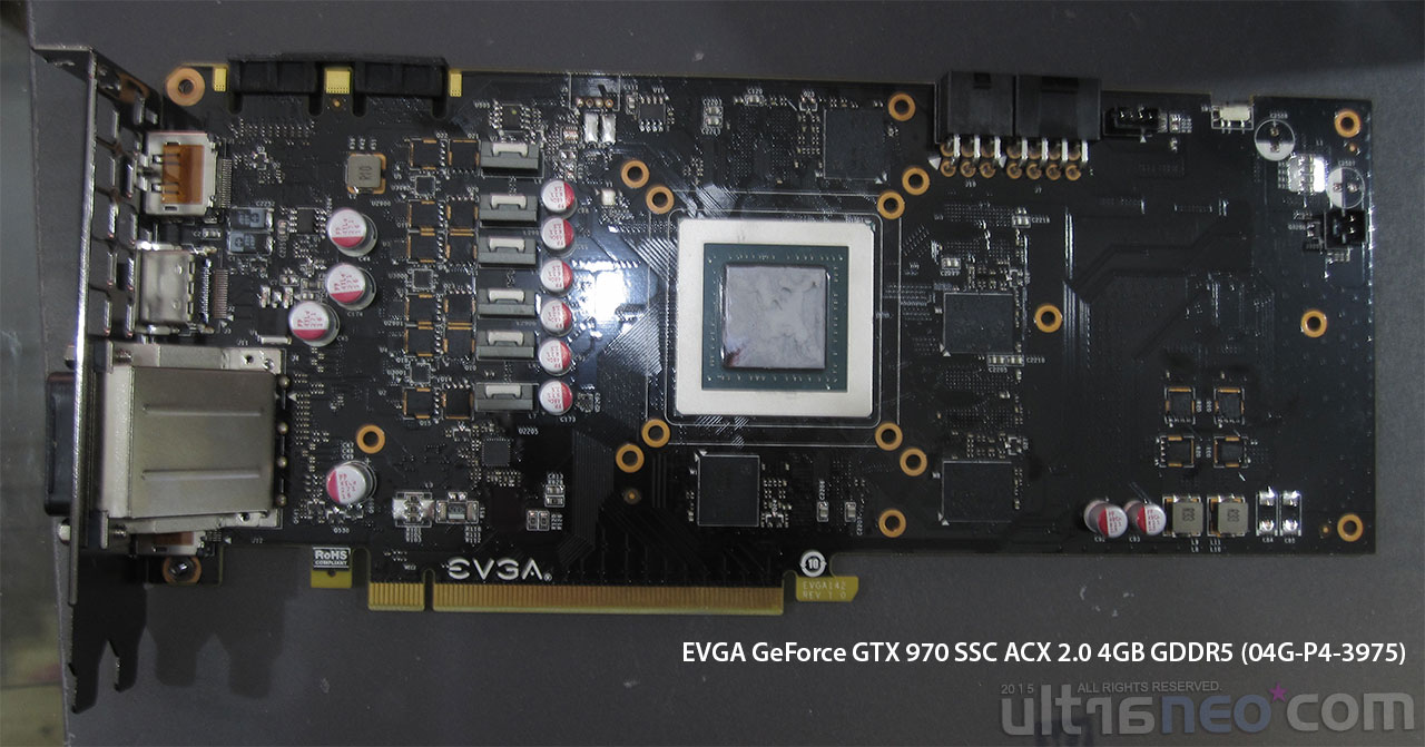

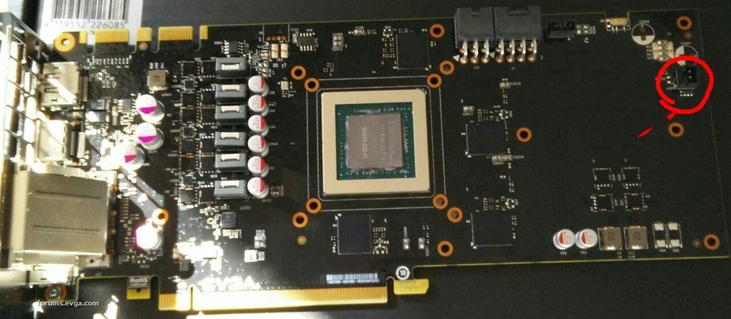

Here's two pictures of the PCB (I know the BP full-cover block will fit it if the led header is removed and the Ek have been claimed to work too after some unknown mod).
Mittwoch, 26. August 2015, 11:16
That will not work at all with our block. Even the locations of the mounting holes are completely different.

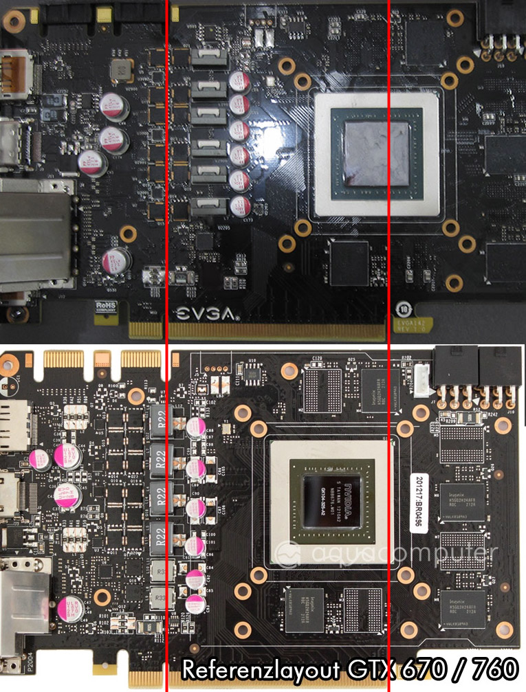

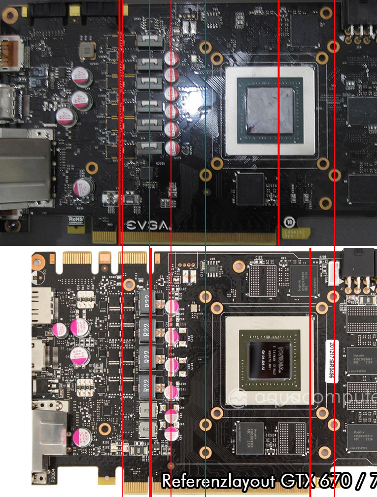

Yes, the card is longer so everything have moved a bit to the left, but on the pCB there's little difference between the components relative to each other (this is why the BitsPower block will work with both variants of the card and the Ek one with some modding on the lefthand side). But I guess arguing this is moot because it's pretty clear that no company (not just AquaComputer) will make the adjustments needed. I will just have to either dremel it myself, trade my card for a 2975 variant or run on air until I upgrade.
I edited your picture to show how well it lines up if you base the comparison on components and not the edge features (but why compare with a 670/760?).
Anyway, might as well lock this thread as it's going nowhere.

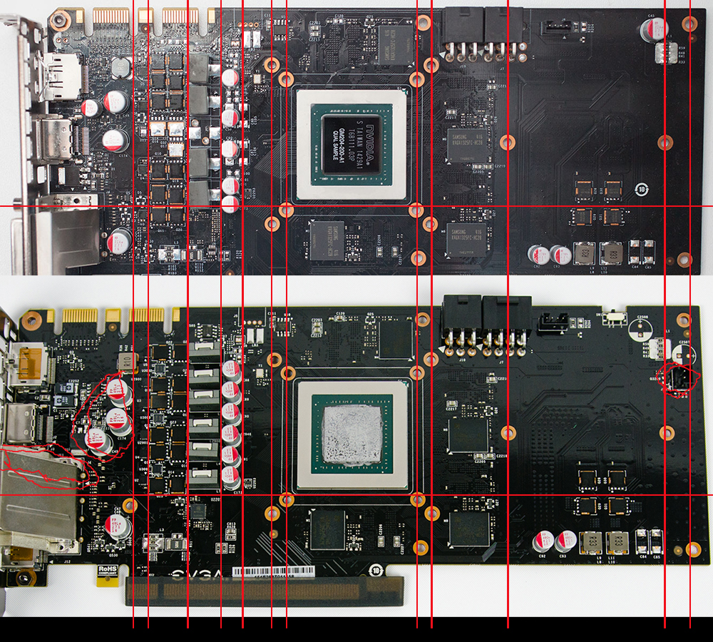

SteinerKD
Freitag, 23. Oktober 2015, 02:13
Made another mockup similar to your showing you the regular and ACX2.0+ eVGA 970s's side by side, how mounting holes and components match up with the exception of the DVI port and condensators on the far left.
Sorry, now I'm done.

Freitag, 23. Oktober 2015, 08:39
Will not work. There is almost no GTX 970 card that will work since NVIDIA has no official reference layout for them. Most manufacturers did their own layout based on the GTX 670/760 cards. In most cases it looks similar but it is not the same nor compatible to our block.
By the way: the "regular" card is also not compatible because it is longer and has additional voltage regulators on the right. I also see that some mounting holes are different.
