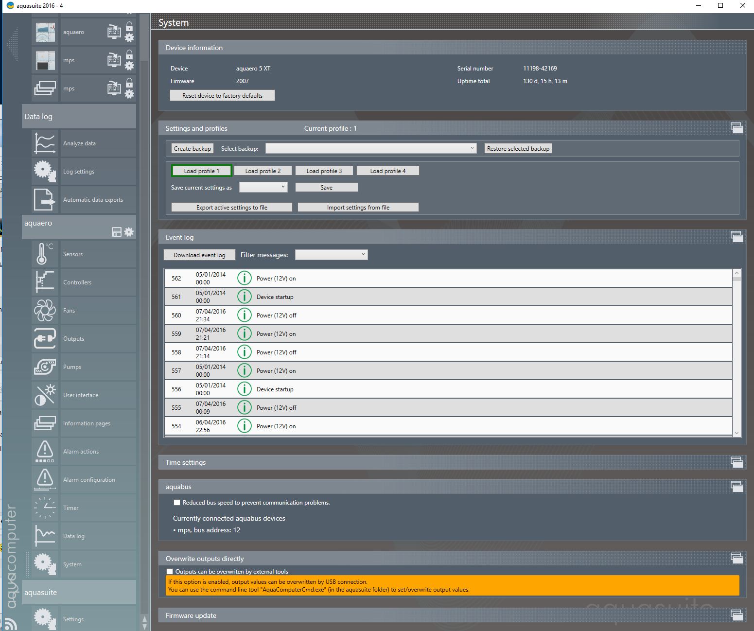

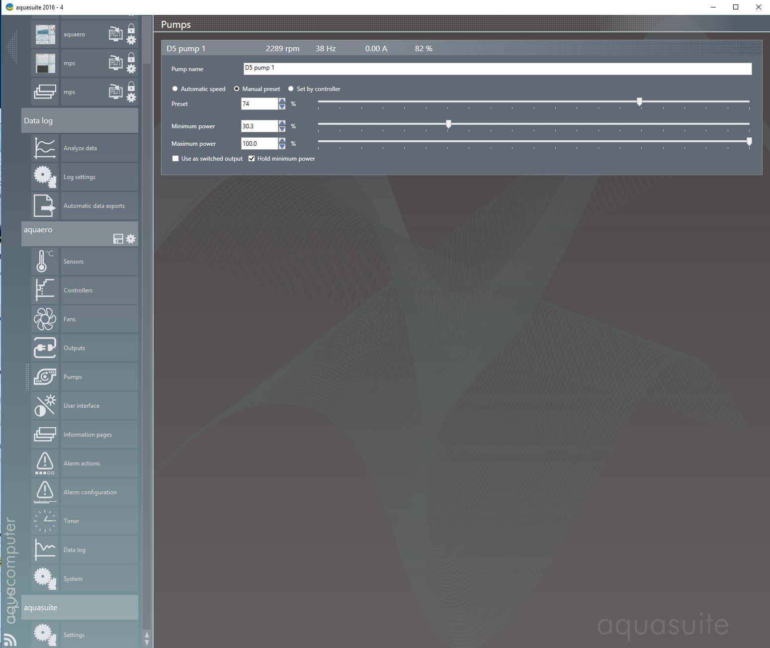

»The Asgard« hat folgende Dateien angehängt:
The Asgard
Donnerstag, 7. April 2016, 23:16
Hi there,
I think I have sussed it. You need to have both aquabus and usb connected. Then set the priority to aquabus under aquabus configuration on the mps section. I then could unplug the usb connection. Not obvious to be honest. Is this correct?

Looking at your screenshot of the Pumps tab under the aquaero, I see you have the pump set to Manual preset. Select the Set by controller option and see if that helps.
And no, both communication options can be active at the same time without issue. If you don't have a USB connection, the aquabus connection is defaulted to.
Freitag, 8. April 2016, 14:05
No, you have to select the interface that can control the device.
Readouts are possible with both interfaces at the same time.
Freitag, 8. April 2016, 15:59
Thank you, I was not aware of that.
