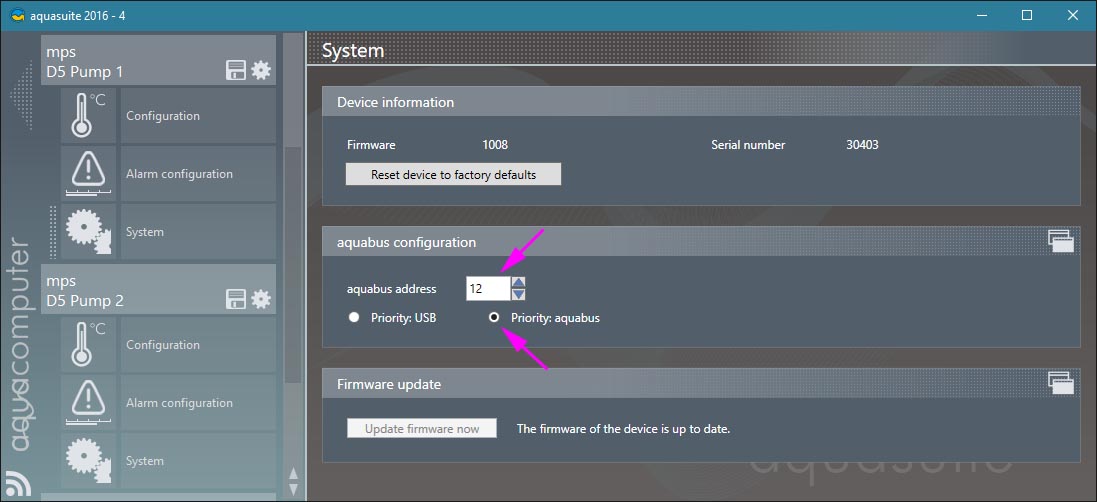

You will have to connect both D5 USB pumps via USB and aquabus initially to set the aquabus addresses and priorities.
Then you can either remove the USB cables, or leave them... your choice.

The two D5 USB pumps and the two High Flow USB flow sensors must be connected via USB to the motherboard initially to configure them in aquasuite. After they are configured, you can remove the USB cables.
You will be able to fully control/monitor the pumps/high-flow sensors in aquasuite using the aquabus connection only.
