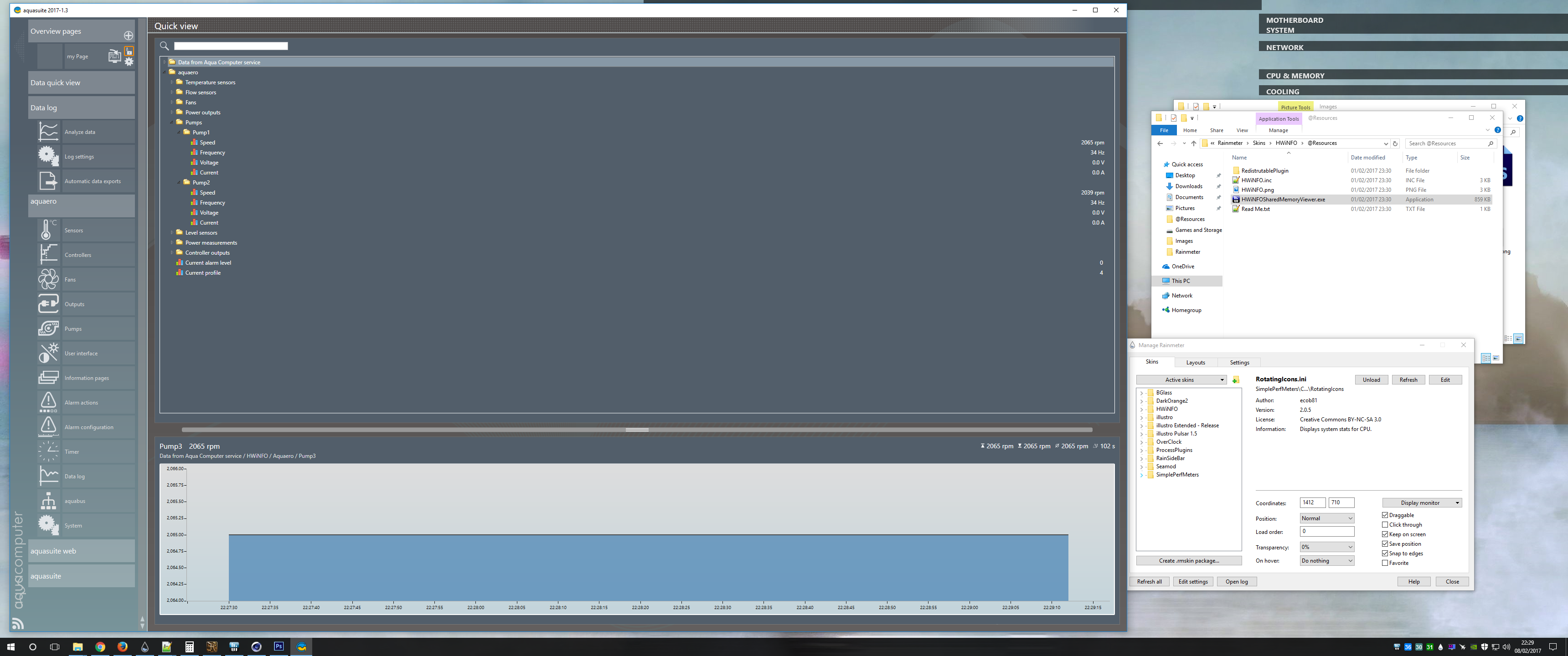

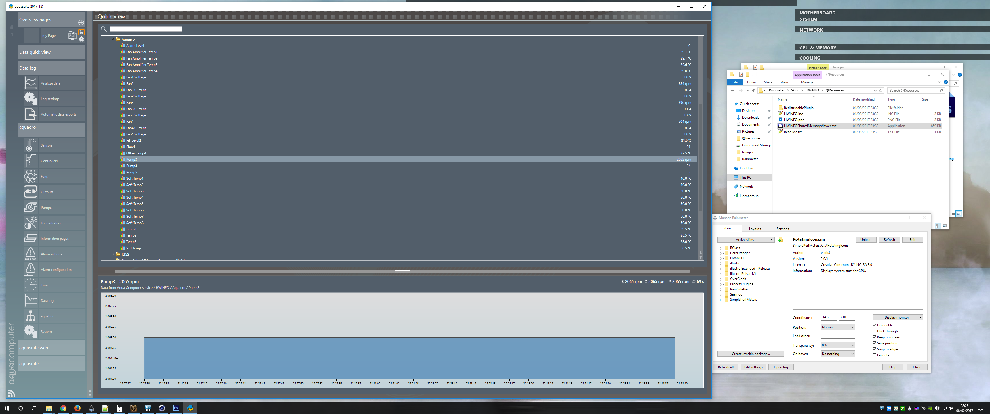

I have a problem getting RPM value to go into shared memory from a 2nd D5 pump connected with aquabus. Everything is working properly in Aquasuite and both pump RPM's show up there but they aren't making their way into the shared memory. The labeling also looks a little messed up for the values that are present such as frequency's which you can see in the screen shots. Any ideas what I could try to get it to show up? Have tried re-installing aquasuite and connecting/disconnecting pump but no luck. Wasn't sure if there was a config file somewhere that I could modify to choose what sensor values are exported and what I.D's are assigned to them etc ?(

Hi @InfoSeeker, It's definitely an aquasuite issue as the same thing occurs in Aida64. The info isn't making it into shared memory from aquasuite. Is there anything I can check with the Aquasuite config/data files?
