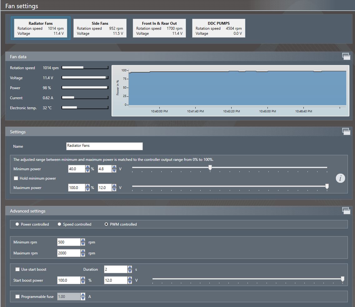

Radiator Controller Curve
Note: 94% Controller Output - @ 58c - RPM 1051 @ 11.4v and 96%
Radiator Fan Settings
Note: 1014 RPM @ 11.4V and 98% Power.
The problem: only 0.62A current with 4 EK Vardar EVO 140ER fans connected (max 2000rpm @ 0.321A)
The question: Why isn't the 2.5A 30Watt Fan Header pushing these 4 fans to 2000RPM @ 98% power and drawing 1.3A?
