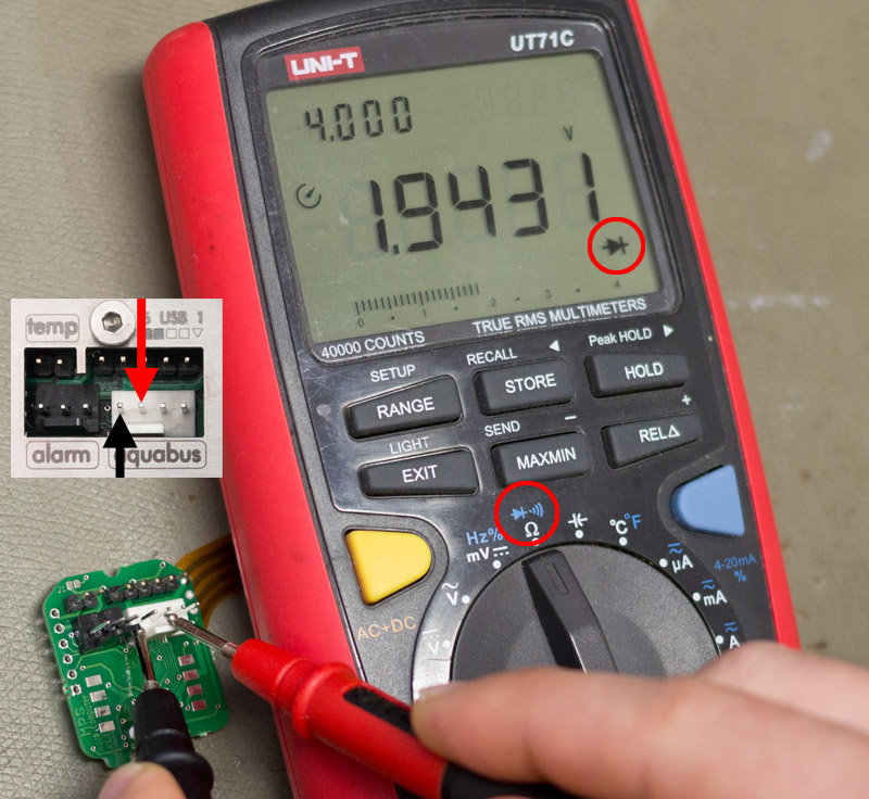

That would damage the aquabus port for sure and can be also determined yourself if you own a multimeter.
Remove all connections from the poweradjust. Set your multimeter to the diode testing icon that I have marked with red circles.
Put the black ground tip to the first pin of the aquabus port and the red voltage tip to the second pin of the aquabus port. If the aquabus port is OK you will get a reading of about 1,9 volt. Some cheaper multimeter devices can read only up to 1,5 volt. In this case you will see "OL" (overload) or something like that to tell you that the measured value is too high for the device. Well, you can still consider it as OK in this case.
A reading with a voltage below 1,0 volt indicates a damage of the aquabus port.

You showed me how to test Aquaeros aquabus, I do have good multi meter (Fluke) is there way of me testing PA3 if its damaged or not, if you could show me the same way you did with testing of Aquaeros that would be great
Just checked my USB flow meters, it shows 1.62v that should be OK right
Also, very strange because when I checked both of my Aquaeros and one is brand new both showing just over 1v ?( I assume take the power source cable off as well right?
Might be my meter, but fro a brief moment it shows the same reading as for USB flow meter 1.6xx and goes back to 1v on both of the aquaeros

You can check the poweradjust aquabus port the same way as the mps aquabus port. Please note that this method will not work for the aquaero.
When you really forwarded 12V to the aquabus ports you can be pretty sure that it damaged the I/O ports of the CPU.

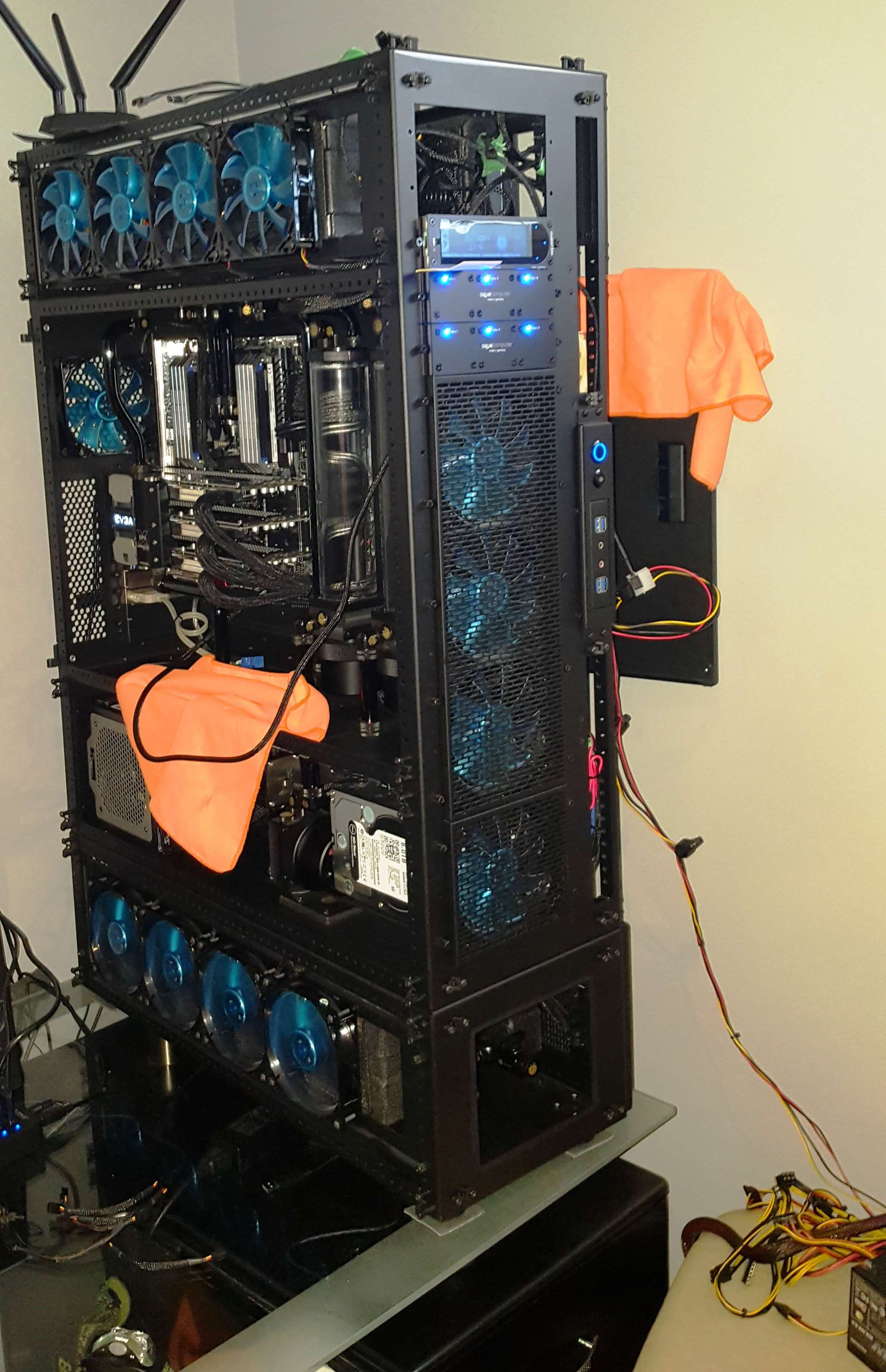

My goodness that thing is a beast! How in the......wow so much work for such a massive rig. I can only imagine.
How does that glass still stay intact? Shocked you'd use glass to hold up such a massive rig.

Thank you for your kind words. Even thou I have this system for few years now I still love it,its dead silent, yet lots of power it works pretty much 24/7 except when I do maintenance, it serves me and my wife's work.
Its remote data collection, 99% of the time it downloads ton of Law work backups (100-150TB per night) from several law offices in Ontario,than during the day this thing is for my work.
Sometimes I'm wondering if I should change my desk, this is very hard tempered glass, it can handle over 300lbs, but still it's almost there ( easy over 200lbs) :P :P

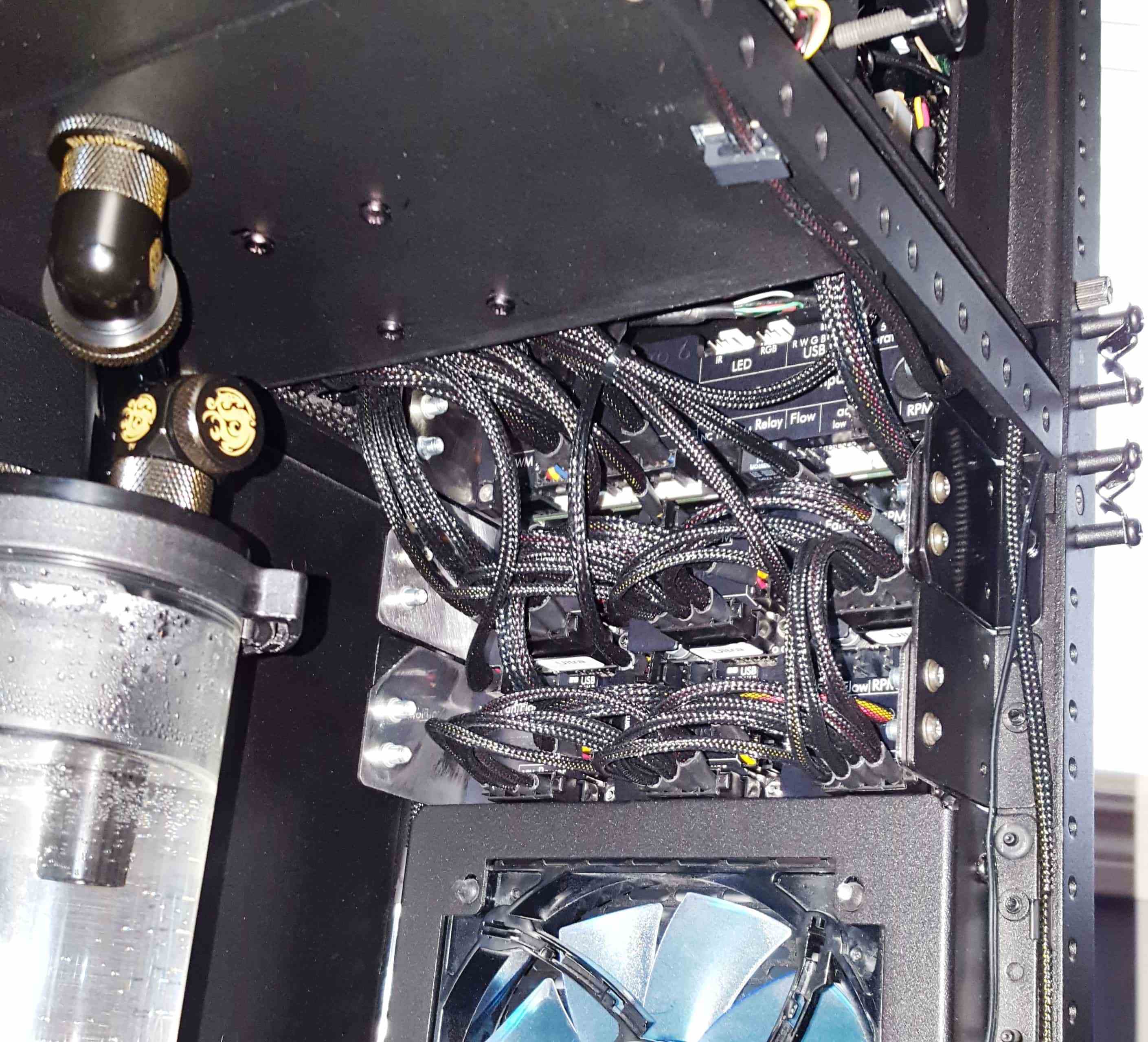

Freitag, 6. April 2018, 18:36
One positive thing came out of this, I want to clean up my cables so I did a bit it might not look much but there is ton of hidden wires now, despite what it shows :P
