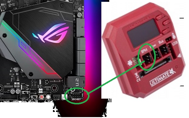

You have to connect the cable from the Aquastream Ultimate RPM Connector to the mainboard PWRBTN connector.
see the attached picture.
Please read the Mainboard Manual (section is called the "System Panel Connector" ) to find the correct Pins for the PWRBTN on the mainboard.
Warning: Before connecting the cable, make sure the RPM/alarm header of the Aquastream Pump is configured correctly!
Configuration for aquastream ULTIMATE (aquasuite Software): Tab "Alarms": "Power switch (53217)" has to be activated.
»Hufeisen« hat folgende Datei angehängt:
Dieser Beitrag wurde bereits 3 mal editiert, zuletzt von »Hufeisen« (11. Januar 2019, 17:59)
