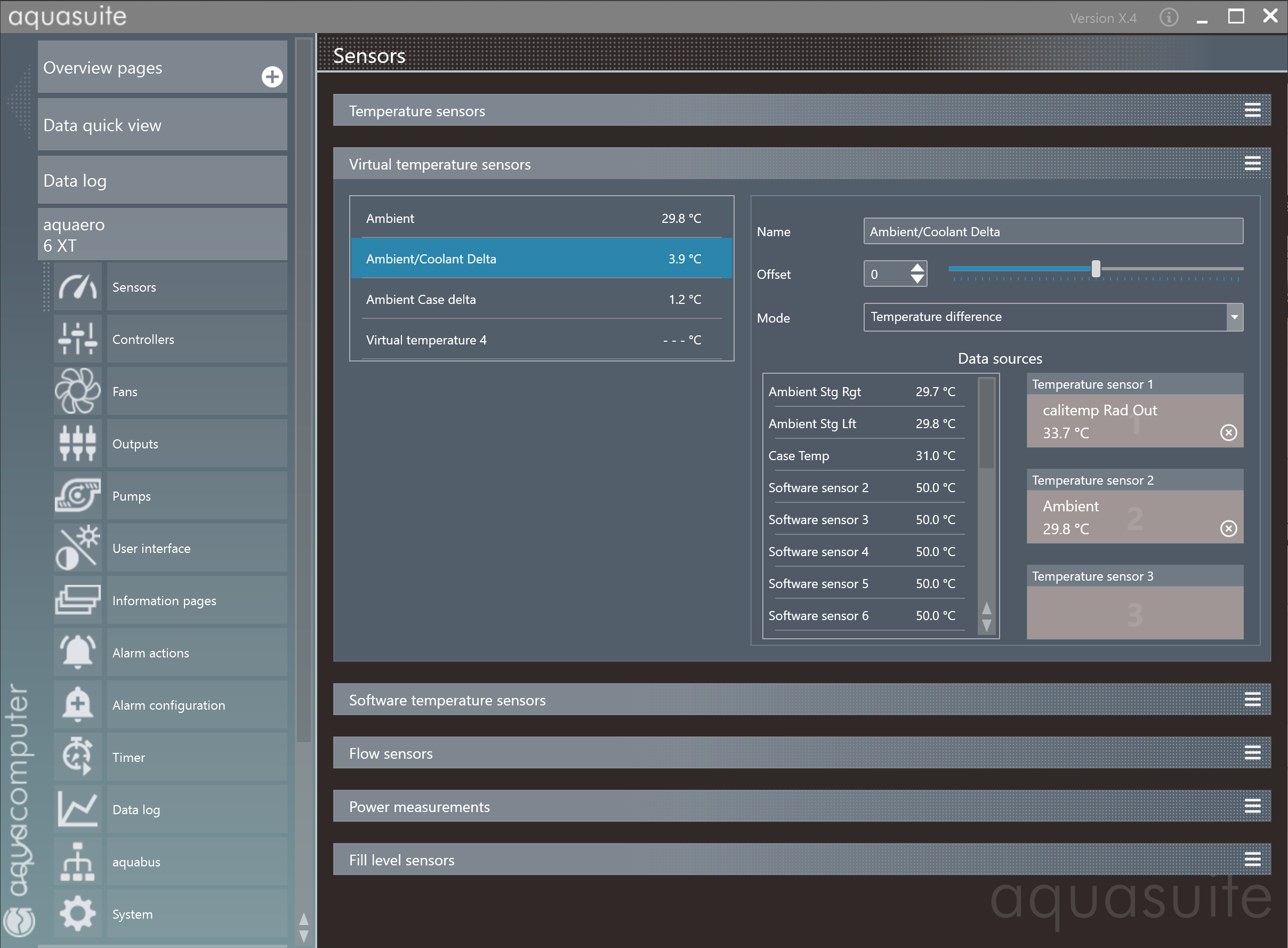

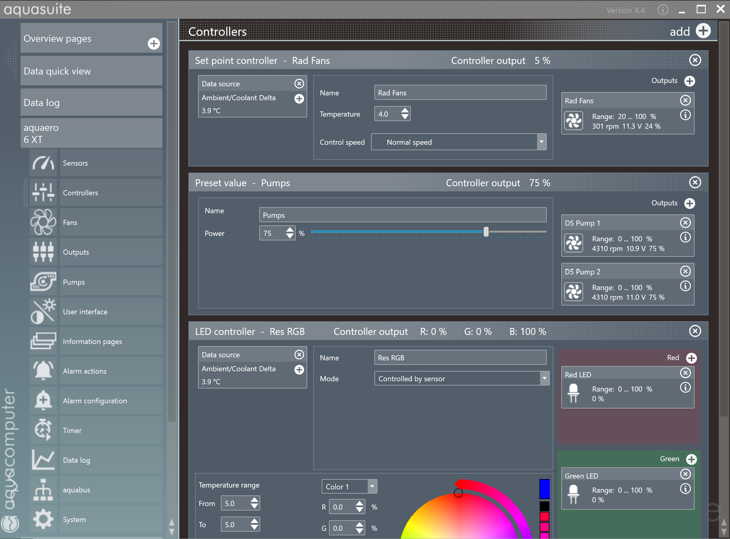

I use an aquasuite "Set Point Controller" set at 4°C to drive the Radiator fans
I use an aquasuite Virtual Sensor with the Delta between the Radiator Out Temp & Ambient Air Temp as the Set Point Controller Source

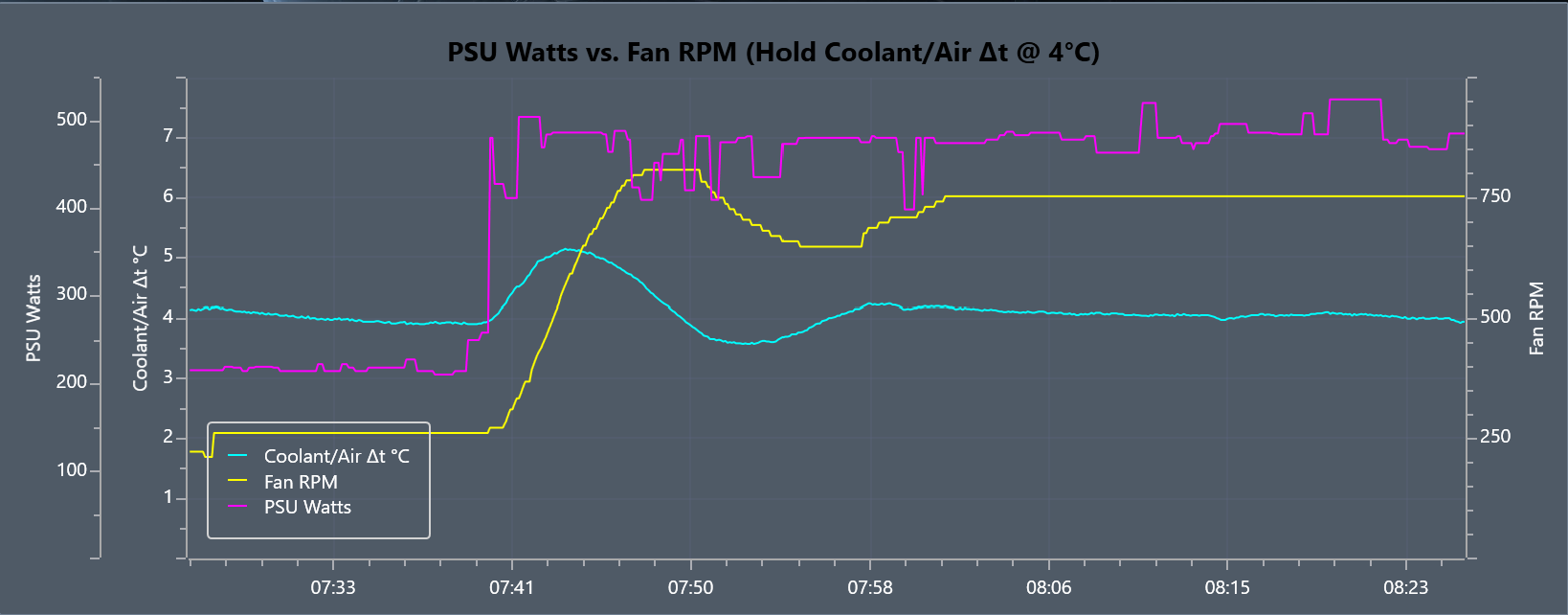

I have my fans set to 20% Minimum Hold, which is about 210 RPM, so when the controller is zero, the fans are 210 RMP. Less than 20% and the fans stop.
In idle mode the Coolant/Air Δt run in the 3°C range, which satisfies me.
Under load, the Δt may spike to 5°, but is quickly brought back to the specified 4°.
In the chart below I logged the PSU Power Out, vs. Coolant/Air Δt, vs. Fan RMP.
As the system load increases, the Coolant/Air Δt moves up, the fans ramp up, the coolant/Air Δt drops and after a bit an equilibrium is attained.

The virtual sensor is an aquasuite Virtual sensor that I defined to show the Difference between the Coolant and Ambient temperatures, it is not an physical sensor.

I have an RGB LED in the reservoir that glows blue until the coolant/ambient Δt reaches 5°C, when it switches to red.
