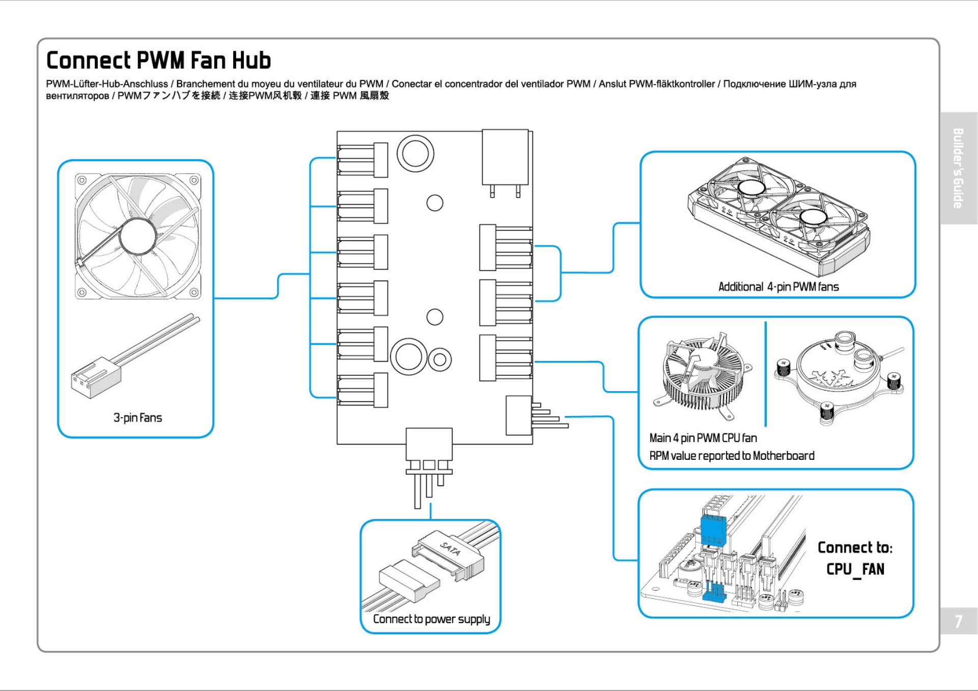

You said Design R6 in the OP, did you mean Define R6?
If so, I guess you are talking about their Nexus+ Smart Hub fan controller (picture below from the manual). It looks to be able to be used as a triple splitter for PWM fans. I am not sure how you would control the 6, 3-pin ports.
Curious, how many pumps/fans are you planning to use?
Dieser Beitrag wurde bereits 1 mal editiert, zuletzt von »InfoSeeker« (5. Februar 2020, 19:53)
[attach]7202[/attach]
Yes I meant Define R6. I am looking and try install dual EK D5 for redundancy and mostly flow rate through restrictive Hardware Labs Rads. I am only researching my options at the minute haven't got case in front of me.
