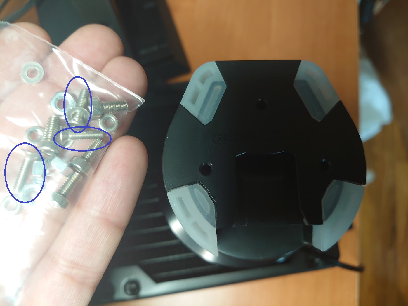

Hello.
I bought the D5 Next pump. It came with 3x M3 and 4x M4 screws. I want to attach the pump to a mount at the bottom of the pump using the 3 holes in the bottom of the pump. But the 3 screws included are too small! They just slide in and out. The other 4 set of screws are too thick.
Maybe I am misunderstanding something but how is it possible that they supply 3 screws that don’t fit the 3 holes in the bottom of the pump?

I don't own that pump but from the looks if it, they supply washers and nuts.. Aren't you supposed to unclip the bottom plate, screw it to the pump mount (with the screws that slide in) and then clip the whole pump in place?

cptninc
Sonntag, 16. Mai 2021, 00:50
The three countersunk screws (angled seat) go into the bottom plate from the top side. Washers + matching nuts go on the opposite side. The pump then presses on top of the silicone.

Tasky
Sonntag, 16. Mai 2021, 02:12
The three longer bolts should go down through the plastic plate from the top, and then through the metal bracket, with the corresponding nuts going on beneath the bracket.
In the second photo you're using one of the four shorter bolts. Those are for attaching the bracket to the case.

cptninc
Sonntag, 16. Mai 2021, 03:13
Yeah thanks I finally realised I had to pull out the weird rubber thing and the bottom panel is just held in by that! But the problem is that the screw are so short that they don't even come out the other side of the thin plastic bottom! So there is nothing to attach the bolt to!
https://1drv.ms/u/s!ApDZ5zl1onU8gto0NNkiy8NAQQH4Cw
That's upside down and those are the wrong screws. That bottom plate should sandwich the silicone against whatever the other mounting surface is. The three longer screws with the cone heads should go through the plastic piece.

If they're M3, they're not the ones from the D5. The heads are too large and stand too proud, which means they will impinge on the pump and negate the silicone dampener.

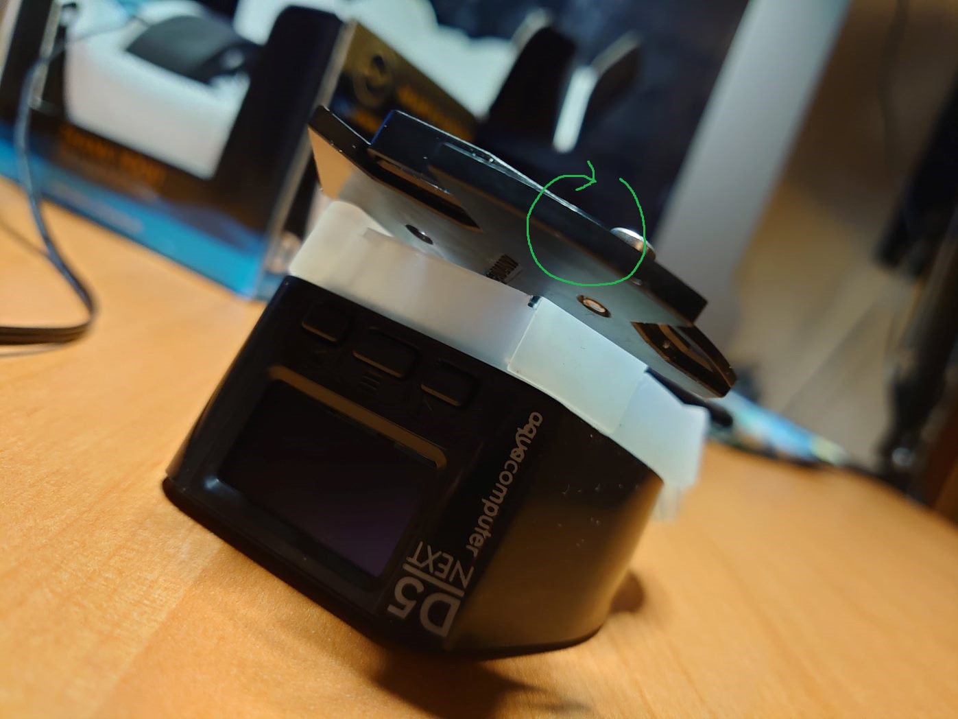

cptninc
Sonntag, 16. Mai 2021, 15:07
  1. Use the circled screws.
  2. Flip the mount plate as noted.
  3. Remove silicone from pump.
  4. Mount silicone to mount plate.
  5. Place mount plate against the mount.
  6. Insert the circled screws through the mount plate and through the mount. The heads of the screws should be completely flush with the mount plate.
  7. Use a washer and a screw on the backside of the mount to hold the screw in place. The washer goes between the mount and the nut.
  8. Righty tighty, lefty loosey.
  9. Push D5 controller onto silicone.

kensaundm31
Mittwoch, 19. Mai 2021, 18:30
[attach]8411[/attach]
[attach]8412[/attach]
Thanks. Bizarrely I had the wrong bag of screws, they must have been the screws from the additional aqua mount I bought and they were literally not long enough. I ordered new screws but also found the screws that were originally supplied which work fine! So to answer the original question I'm dumb :)! But to be fair I bought all this other stuff 7 months ago and only now just putting it together.
