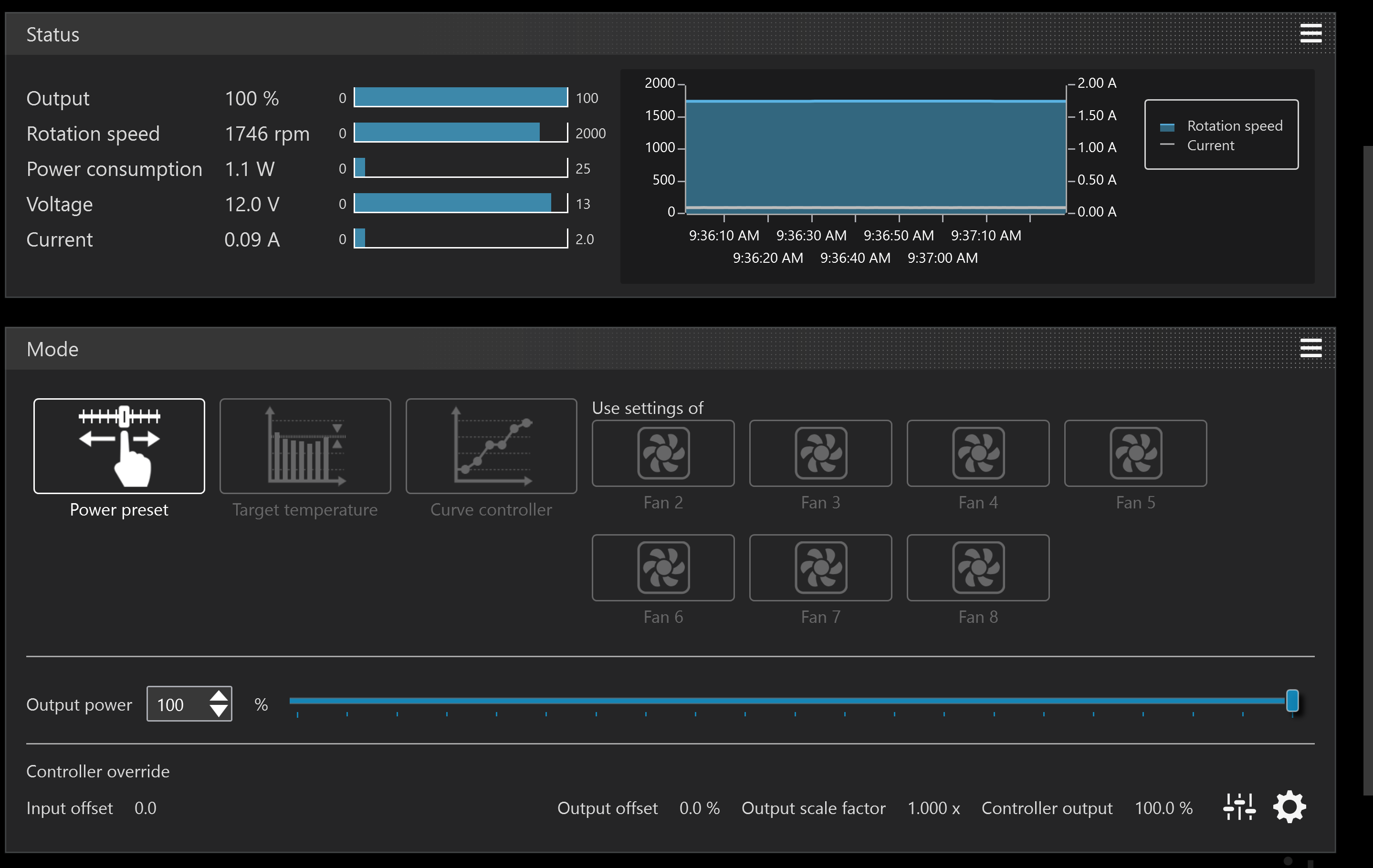

Here after opening software. It is defaulted to 100%

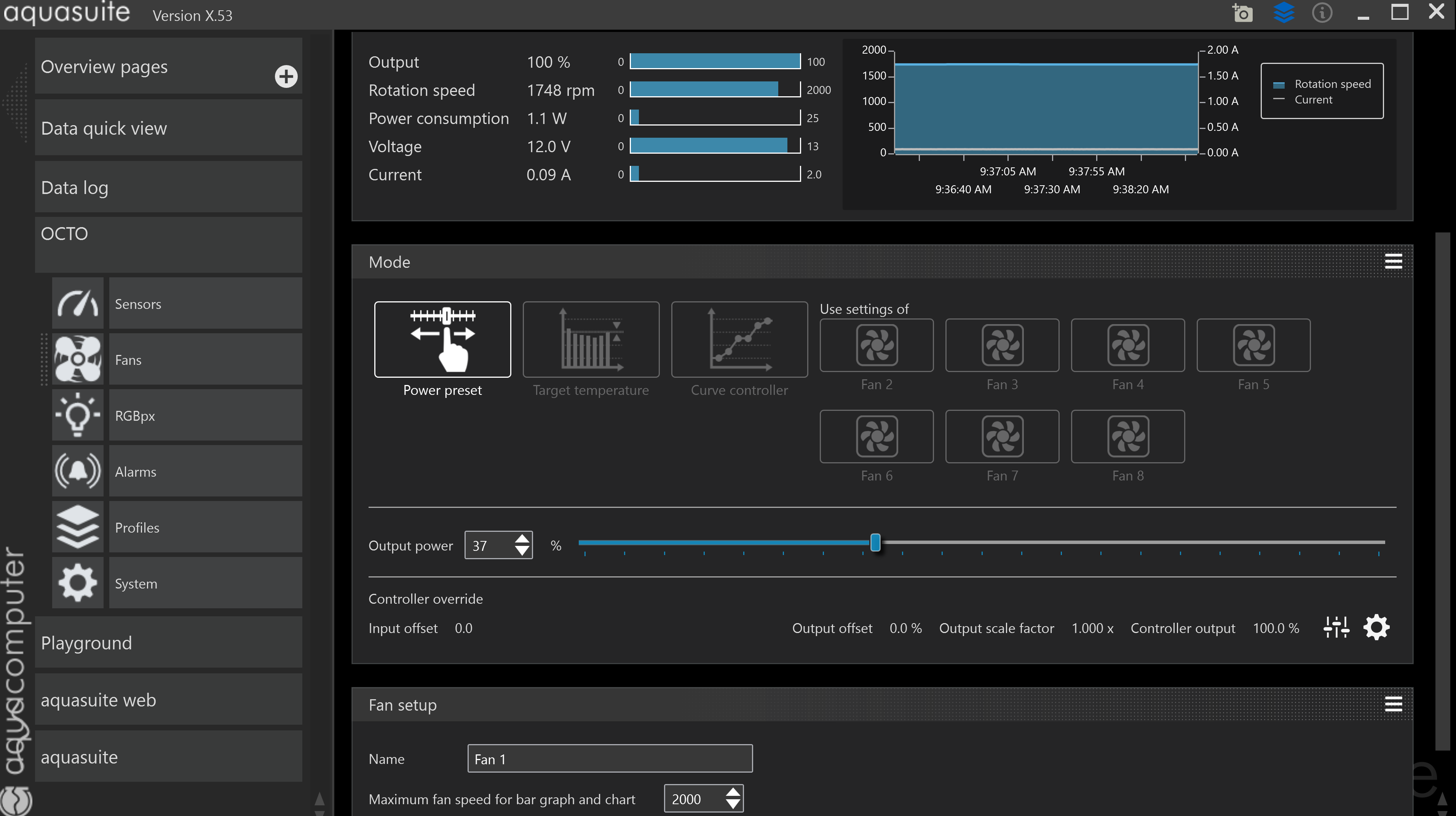

Here I've changed the settings and the output doesn't change

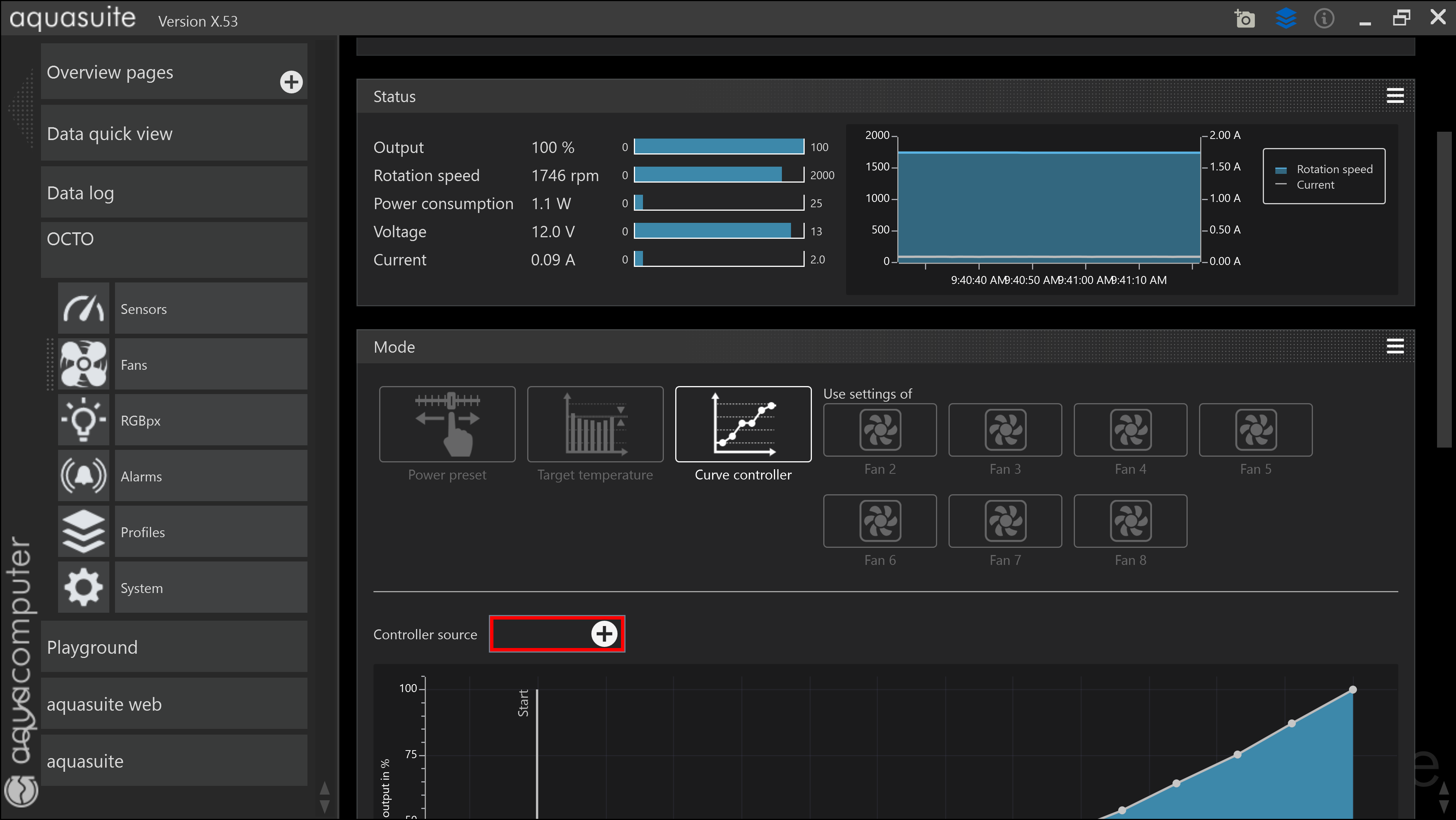

Here is what I see if I click curve. It is defaulted to not having a source
Here I have added a source but it doesn't matter because again the fans wont reflect any changes made

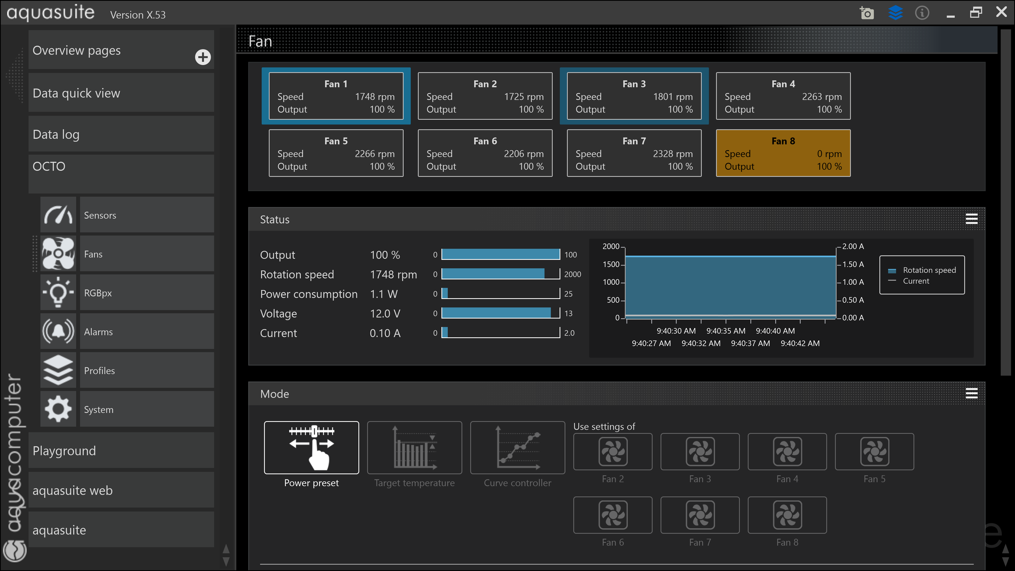

And
again here is me opening the software again after closing it (and yes I
click the save icon every time) back to being defaulted to power output
100% and the profiles I've saved (just for seeing if it's a profile
issue) are not loaded so it says the profiles don't match, but if I
click a profile the settings will change to that profile but again
nothing actually changes. Fans still just blasting 100% like a jet
engine.
