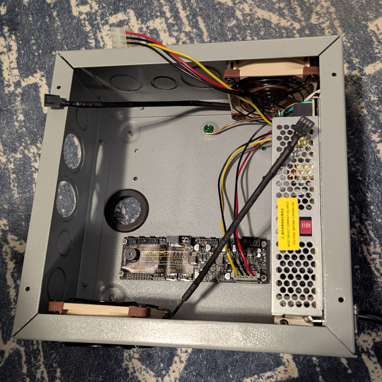

4.) The Aquaero setup I am in the process of building will be a little different than what most probably use. The Aquaero's are in a customized dedicated electrical box with their own dedicated power supply:
The box has a couple of fans that in turn are controlled by the two Aquaeros and keep everything inside the little box cool.
The second Aquaero will be mounted above where the one installed unit is right now.
This box then controls a couple of large radiators and fans, that in turn cool several computers.
The initial plan was to use the virtual sensor feature to get the maximum temp of all of the fan amplifier sensors, and then control the fans based on that max temperature, to ensure the Aquaero's fan outputs don't overheat.

It probably goes without saying, but I'll state the obvious. Since these Aquaero's are in a box of their own, and are being used to cool many PC's, they cannot rely on Aquasuite or the Aquacomputer service running. They must be able to handle things on their own without an active USB connection. US and the Aquasuite client in this case will be used for setup/configuration only, and will the n be disconnected.
