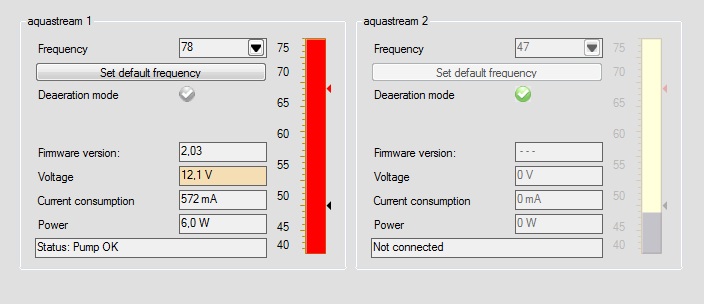

The de-aeration button is grey, changing it doesn't seem to do anything. As I type it appears to have negogiated 78hz and sat there ever since. I'm unsure how to set the frequency manually? All I have is a "set default frequency" which doesn't seem to respond in any way I'd expect. I set the "frequency" to 55 just now, pressed the button and after a few seconds it shot down to 45hz and gradually made its way back up to 78.
Here's an SS of my panel attached.
»Flareon« hat folgendes Bild angehängt:
