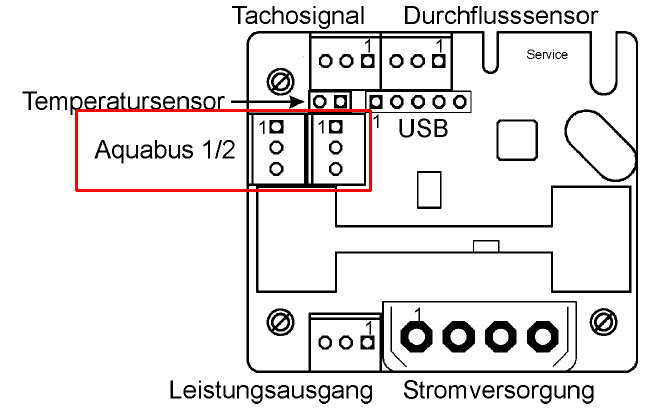

hi guys,
As it stands im using a single loop with laing pump controled via USB poweradjust 2. Im familiar with most of a computers electronics to maintain and monitor. The rig i own originally had two loops thus two controllers. Where poweradjst 2 sits there are two cables with one connected, showing the old loop disconnected.
Aquasuite shows rpm and i run at 70% all of the time. i believe the old temp sensor is disconnected also. do they typically run (two pins) from Poweradjust 2 into the reservoir? Without manual im guessing and im wanting to get it plugged back into Aquasuite. im comfortable with just the one loop.
there is a worklog available here. im trying to email mac1as...
Ace Adey
Sonntag, 30. Oktober 2011, 20:27
[img]http://www.techpowerup.com/forums/attachment.php?attachmentid=44167&stc=1&d=1320002740[/img] hmm so this is poweradjust 2. if i have a two pin temp sensor probe, can you tell me where to connect it to please?
Montag, 31. Oktober 2011, 15:10
The red one is the connector for the temperature sensor:
You will have to use a 10kOhm NTC sensor, otherwise it will not work or provide wrong temperature values.

Greetings all:
I am new to this technology. I have a Poweradjust 2 connected to my AE 5. I have all of my fan headers loaded on the AE5. Where do I plug my 3-pin fan into the Poweradjust 2 so that AE5 will recognize it?
Thank you in advance.
Donnerstag, 10. November 2011, 11:53
The aquabus connectors are marked red in this drawing:
