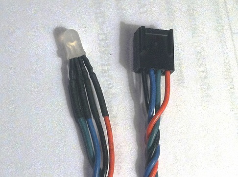

I have an Aquaero 5 LT running Aquasuite 2012 beta 12 and can not get the RGB LED to function correctly. As a test I've set up the LED controller to use the Aquaero CPU as sensor with the red, green and blue LEDs as the output. I have a true RGB LED that I've tested to make sure all three colors work correctly. This is wired to a 4 pin plug and plugged into the LED controller.
After some testing I quickly found out the user manual appears to be wrong. It shows pin 3 as ground when it is actually pin 4. Pin 3 is the Blue LED.
Setting the temperatures so that only one LED will go to 100% shows my Blue LED works fine. Green has the LED light blue but very dim. Red does not work at all.
So, I broke out the meter and tested voltage across the pins with the various LEDs activated.
When Aquasuite says Blue is at 100% pins 4 and 3 show 4.66v.
When Aquasuite says Green is at 100% pins 4 and 2 show 0.0v
When Aquasuite says Red is at 100% pins 4 and 1 show 0.0v
Do I have a bad controller?
Also, what are the pinouts for the RGB LED? So far I have the following:
Pin 1: Red ?
Pin 2: Green ?
Pin 3: Blue
Pin 4: Ground (Black)
Attached are pictures of my LED Controller config and a LED itself.

You need a led with Common Cathode. Your wiring is Wrong.

This is the LED that I have:
If I understand you correctly then, my LED is backwards from what I need as this one has a common anode (+) and 3 different cathodes (-) ?( ?( ?(

Your Led is not working with the aquaero.
You need an LED like this: http://www.sparkfun.com/products/105

Well, crap.
You're right. My LED is exactly backwards from what's needed. The sad thing is I actually looked at those LEDs at SparkFun but decided to buy them local instead. Should have been more careful.
