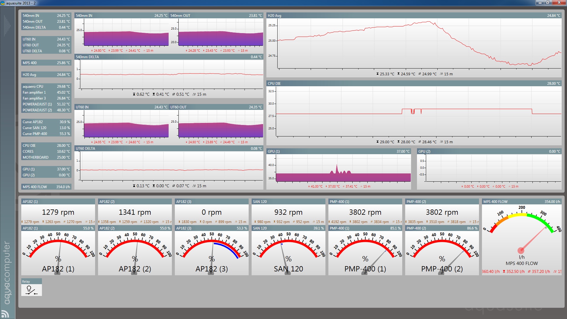

I have the aquaero 5 with optional waterblock, running 3 AP182 fans from channels 1-3 respectively and a san ace 120 on channel 4. Fan amp temp sensors are fine (45 degrees) The problem is that I am unable to run the AP182 fans at anything lower than 1300 rpm without the fans constantly ramping up and down or just simply stopping. The current is wildly fluctuating all the time. Has anyone else tried controlling any of these fans with the aquaero?

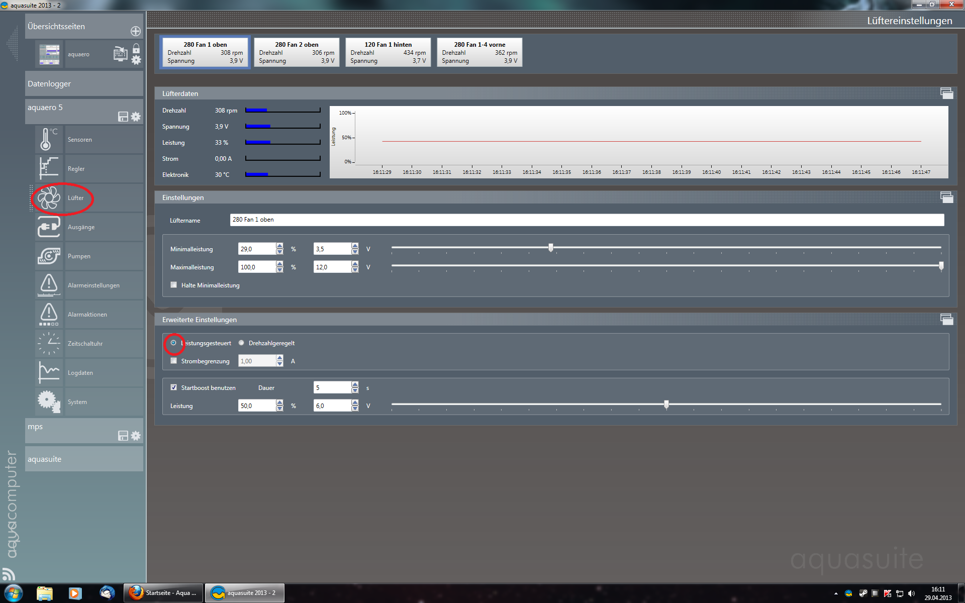

Montag, 29. April 2013, 16:10
Try to use target voltage not target rpm.

Thanks for the speedy reply guys, but that is how it was at default, power controlled. Tried it with RPM controlled as well with no benefit, including setting a minimum voltage with "hold minimum power ticked"

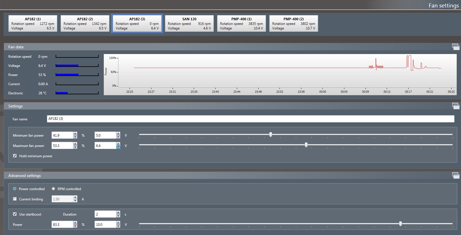

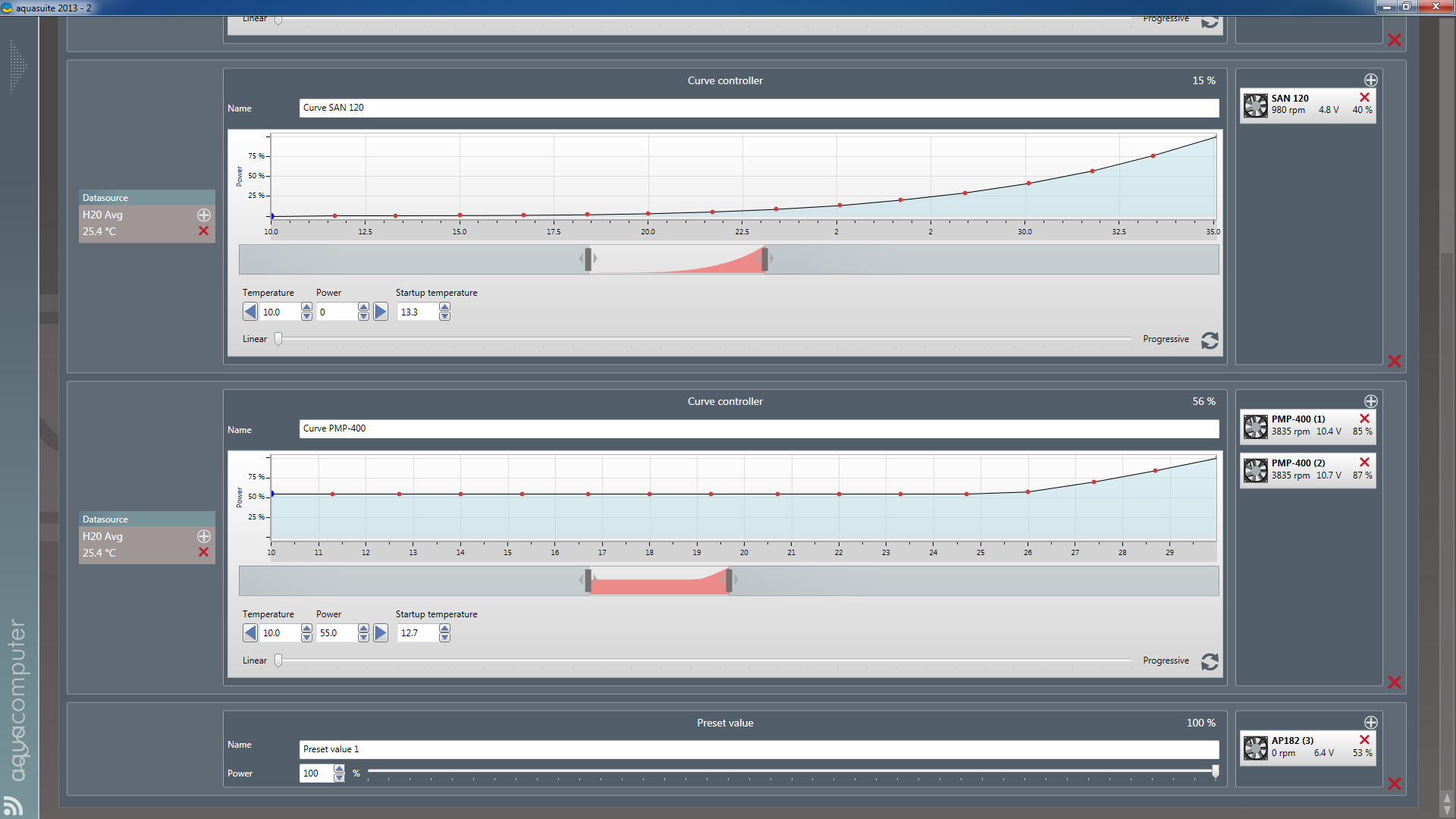

]I am currently (for demonstration purposes) using a curve controller with the first two ap182 fans, rpm controlled. I have set a limit on the hold minimum power to 6.6v to keep them running. I have tried using a 'constant value' of 100% and using the fan power sliders and can confirm that the fans simply stop when the voltage is less than 6.6v. As you can see in the picture, I have 3 ap182 fans. The first two are running from the curve controller with a 'Hold minimum power' of 6.6v and so are running at the lowest speed I can get them to (around 1270rpm) whilst the 3rd ap182 fan is running on a 'constant value' set to 100% Now when I reduce the voltage down from 12v on the 3rd fan, when I get to 6.5v the fan simply stops. Here's the screenies.

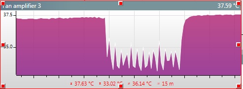

Pilo, I have the waterblock for my aquaero attached with the supplied thermal pad, integrated into my loop. I created a graph to monitor the temperature of fan amp 3. At 6.6v fan amp 3 is settling at about 37.5 degrees. Fan amp 1+2 runs at about 45 degrees with two ap182s running at 6.6v which I think leaves me plenty of headroom, does it not?
This is what happens to the fan amp temperature when I lower the voltage to 6.5

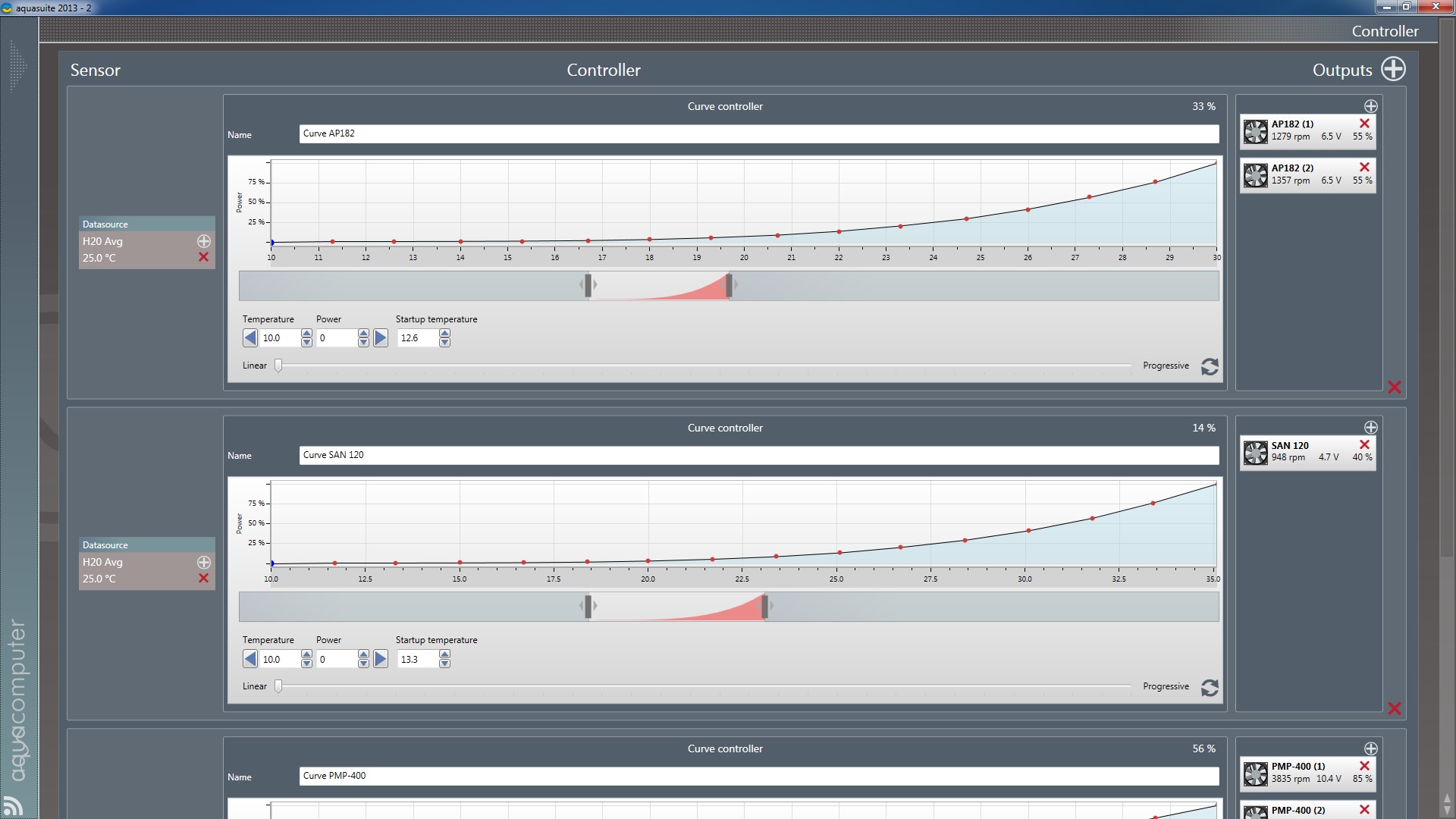

And this is the graph of power fluctuation I am getting when trying to run the fans using a controller curve, with a minimum fan power of 5v rpm controlled (from 23:32 onwards)

In the second screenshot under "Advanced settings" first line, the setting is "RPM controlled".
Have you tested it with the setting "Power controlled" yet? I would recommend it for all your fans.
Perhaps that's the reason your fans are showing such strange behavior. Just a guess, though.

Pilo, when the setting is on power controlled, the fan just stops at anything less than 6.6v which means I can never get the fan slower than around 1270rpm The fan specs should allow for 500rpm@ 5v

Today I attached the supplied fan controller to the third fan, and connected the rpm wire to the aquaero 5 and it does indeed allow the fan to go at 500rpm, here's proof! I don't know what voltage this is unfortunately :(
