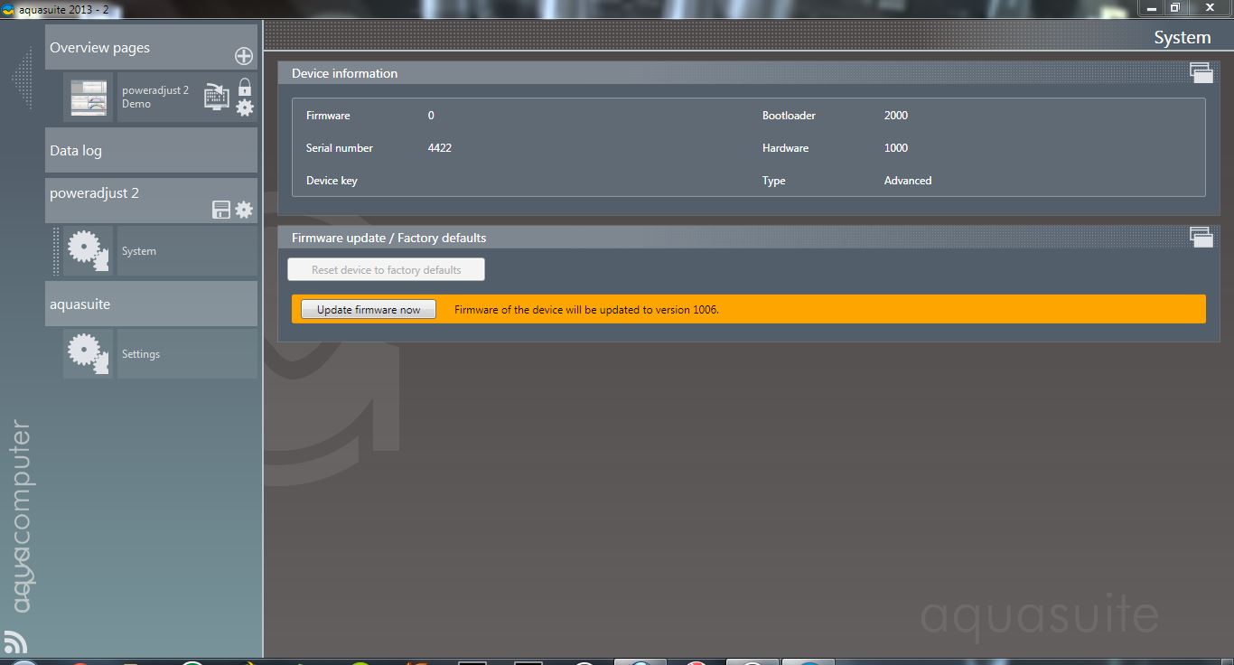

liberato87
Samstag, 25. Mai 2013, 17:10
today I tried a loop with only pump, flow meter and reservoir.
the flow looks great so It is impossibile pump got problem.
The flowmeter still not work. Now it is on 0, like there is no signal.
Strange thing if I plug the flowmeter cable the poweradjust 2 restart, like there is a contact.
and now the poweradjust 2 not work, red link blinking!
It is now recognized as poweradust 2 advanced not Ultra and there is firmware 0! I already had updated to firmwre 1006 but now it is 0.
I tried to update, update good but when I restart aquasuite, it still ask me update because the firmware is still 0.
I tried also to update t firmware 1003 (using aquasuite 4) but same problem... firmware still on 0!
please help me.
Dieser Beitrag wurde bereits 1 mal editiert, zuletzt von »liberato87« (25. Mai 2013, 17:53)

liberato87
Sonntag, 26. Mai 2013, 12:00
flow meter cable doesnt work and if i touch it to disconnect, PA2 turn off and restart.. very strange.
now as I wrote in the post PA2 is stucked to firmware 0 and I'm not able to update it.
I tried removing aquasuite 2013 and reinstall (new installation) but not able to update firmware 0006.
Tried to remove power and wait (also this morning I tried after leaving all night turned off) but nothing changed.
I also installed aquasuite 4 that got firmware 1003 in the folder, but same thing. It says update completed but after restart It asks update again.
I think there is something wrong into usb connection.
I tested in this way to see if flowmeter broken or my loop is too restrictive.
Flow meter showed 0 so.. but now I think poweradjust 2 is dead.
Red led blink when i turn on power.
Aquasuite recongize it but with firmware 0000.
Dieser Beitrag wurde bereits 1 mal editiert, zuletzt von »liberato87« (26. Mai 2013, 12:02)

LarryWill729
Montag, 3. Juni 2013, 15:39
I have had many problems with the High Flow sensors.
Bottom line, they were all due to faulty (Very Cheap/POORLY Made) cables.
PA2 flow sensor connectors read flow poorly compared to AQ5 flow sensor connection. This from Shoggy a while back.
To reset the PA2 firmware, it must be connected ONLY via USB to MB, then run AS2012 and re flash or set to factory defaults until it works. If it does not, it is toast.

liberato87
Mittwoch, 3. Juli 2013, 11:44
find out the problem.
cpu waterblock was COMPLETELY obstructed.
I cleaned it and now i have a flow around 180 l/h.
<img src="
But poweradjust 2 ultra is bricked and need rma.
Dieser Beitrag wurde bereits 2 mal editiert, zuletzt von »liberato87« (3. Juli 2013, 11:46)
