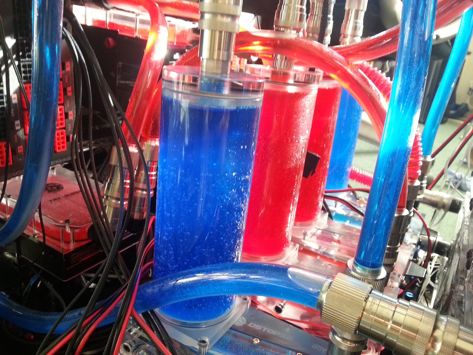

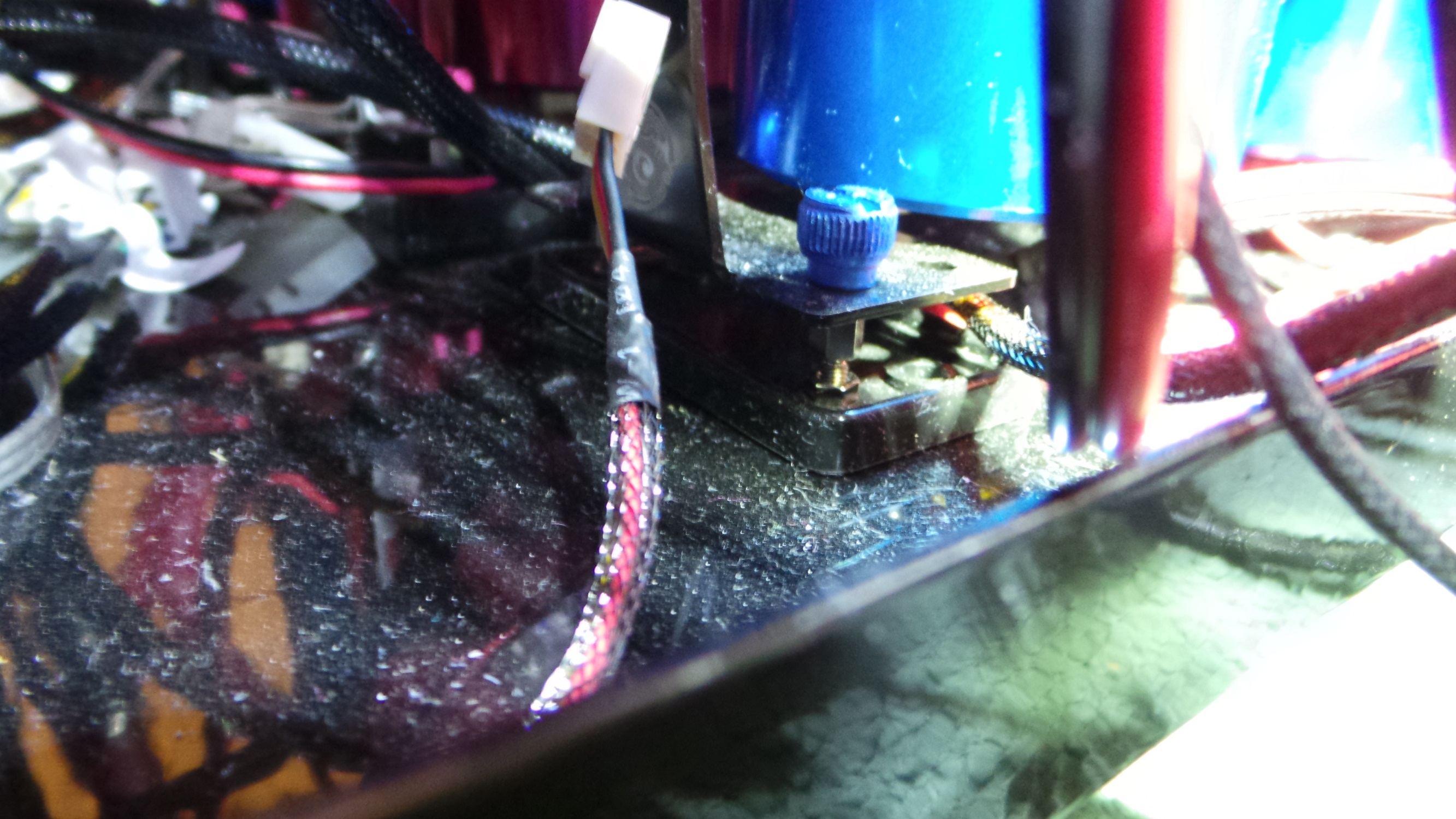

I also have these dual D5 pump mods and the aquacomputer D5 pumps.
There is no way you can leave the back plate on. It will work just fine without it.
Have a look at a few of my pics, it won't cause any problems.
I struggled to find a place to mount them in my case and I have 4 dual kits (8 pumps)
I ended up buying the pump top mod kits from frozen cpu here.... http://www.frozencpu.com/products/16074/…150AC-CLCL.html
Check the last few pics to see the dual version.
I bought them as they raise the pump off the ground which enables access to the ports on the bottom of the pumps.
I used motherboard standoff screws to raise them higher as I still couldn't gain access.
