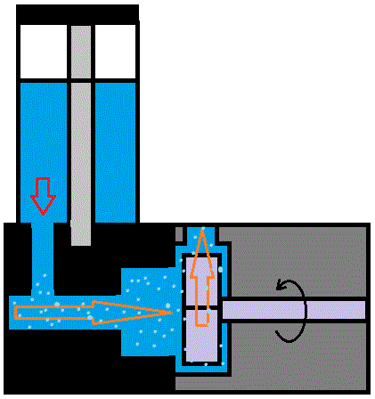

Just be patient, it will work. The drawing below shows, that the bubbles probably just circle constantly past the reservoir.
The reservoir is just a supplier for 'spare' water and not a catch tank.
There is no direct flow into the reservoir and the bubbles don't get into direct contact with the water-to-air surface.
That's the reason, in my opinion, why the bubbles need much more time to dissolve.
