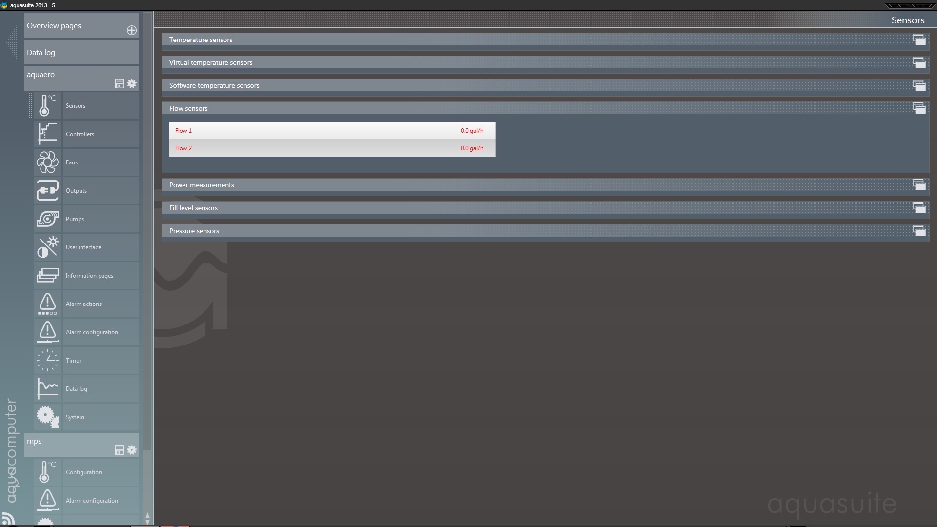

Yes, in the screen shot you posted, I see you have more than just the Flow 1 and 2 devices. For some reason though, I don't get that. I only see Flow 1 and 2 - the MPS flow sensor doesn't show up.

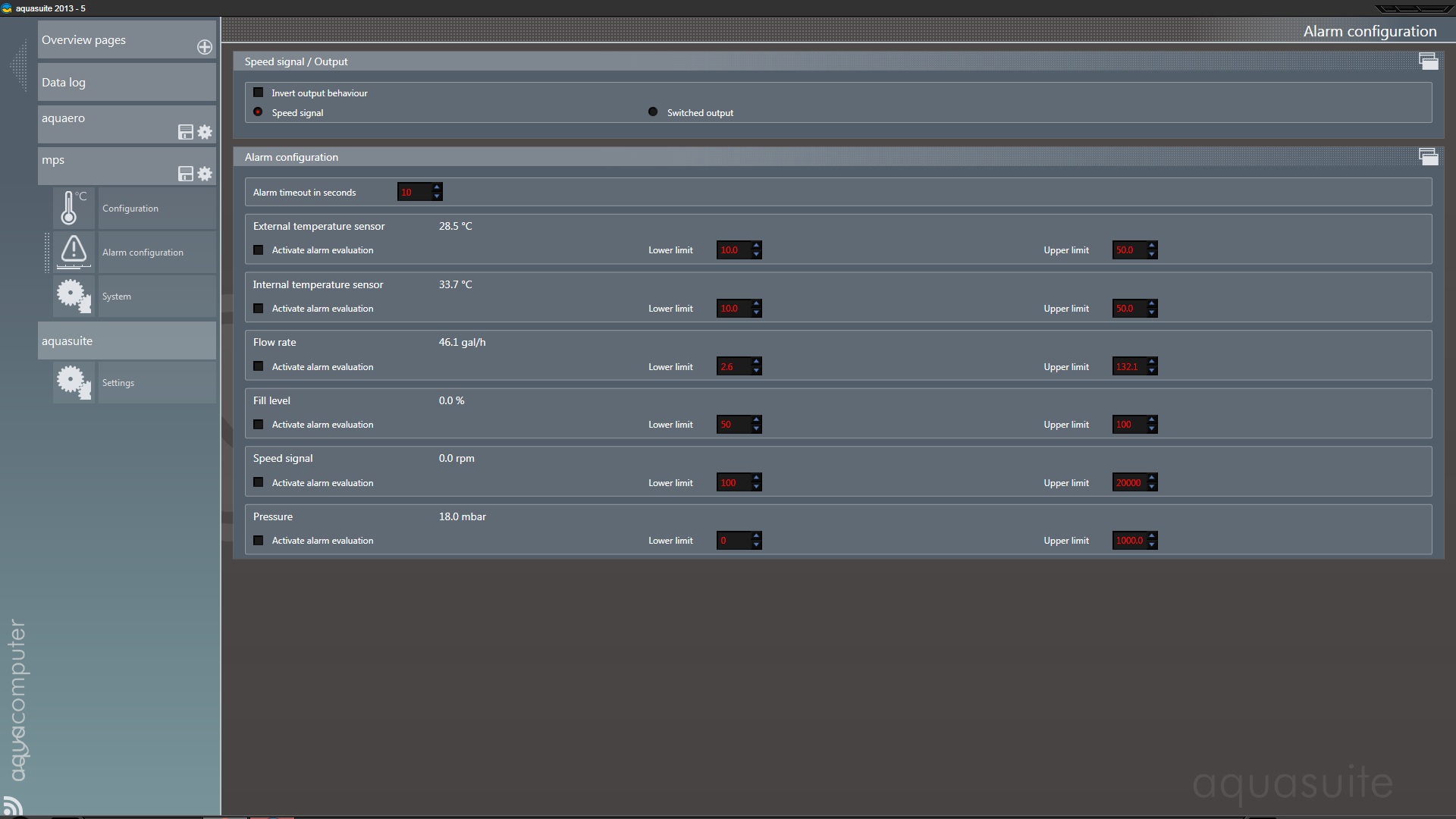

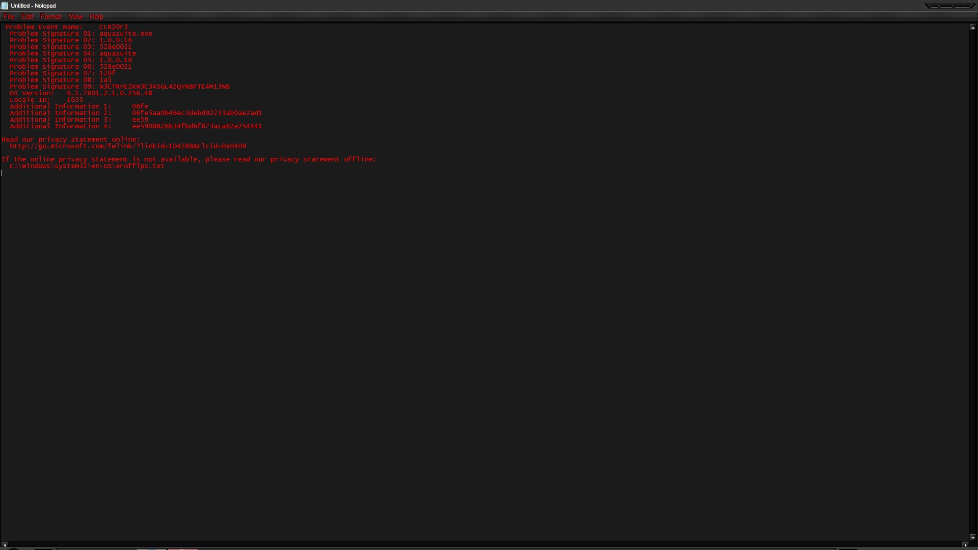

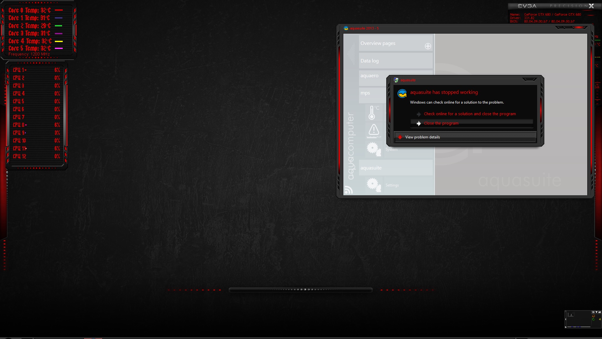

I do not see flow 11 or 14 just flow 1&2 aquasuite 2013-5 keeps crashing on me done it twice 2 me just taken screen shots.everytime i click mps will crash.

Sonntag, 1. Dezember 2013, 06:46
in this case is your mps not connected corretly to the aquaero (via aquabus)

yes it is connected to the aquaero right using aqua wires. aquaero high flow to the mps using the 4 pin wire. I have just hooked the mps up all by it's self and i get nothing in the aquaero.But when i hook my aquastream xt pump to it, it's fine,it use to work don't know what happened to it.Sebastian can i just get the board that goes in to my mps or do i have to buy the hole thing again ?
