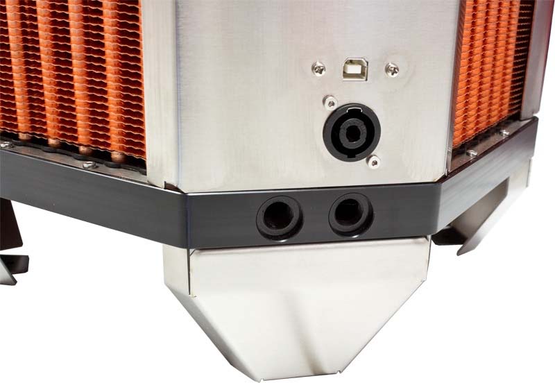

Also, the Gigant has the power & a USB 'B' connector integrated in one of the panels, and I wanted to stay as clean as possible on the outside.

[attach]4967[/attach]
I see now why you are doing what you are doing InfoSeeker. Makes sense. Excellent that it's all working and Great set Up. It must be impressive.
Does the Gigant make coffee by any chance or better still Beer?? ;)

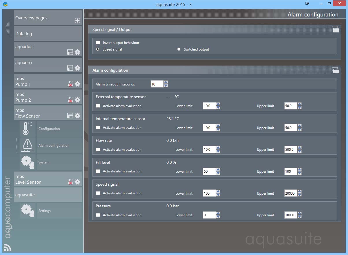

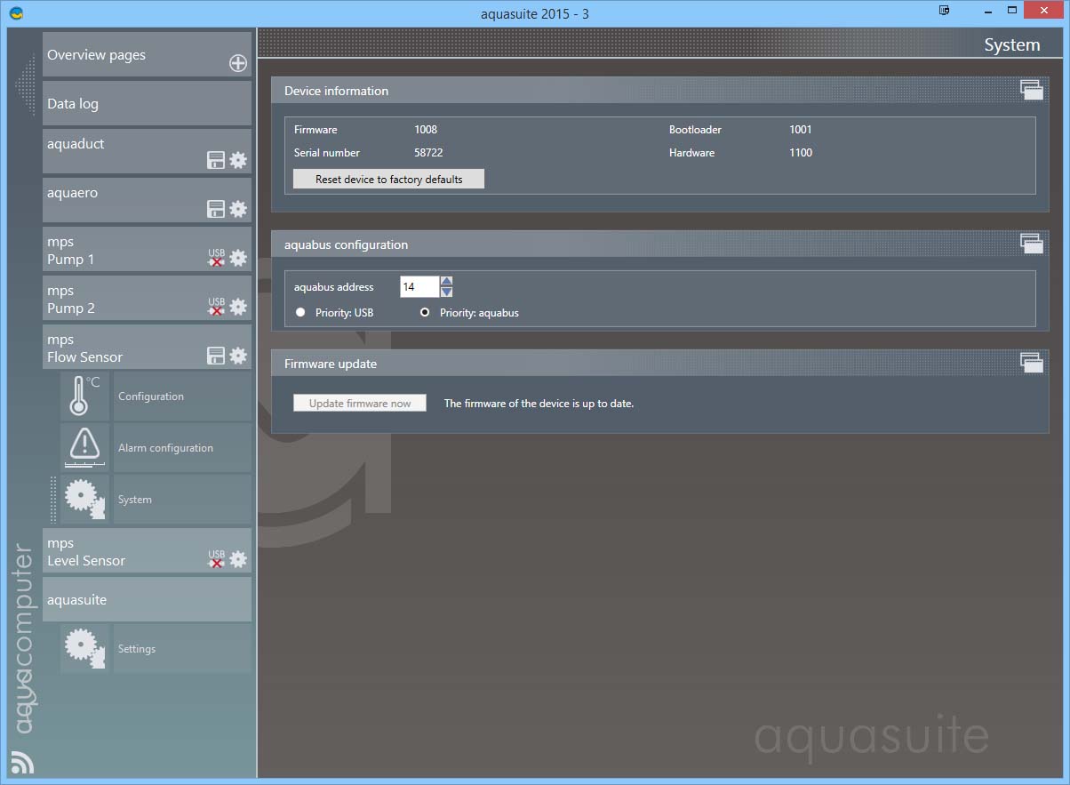

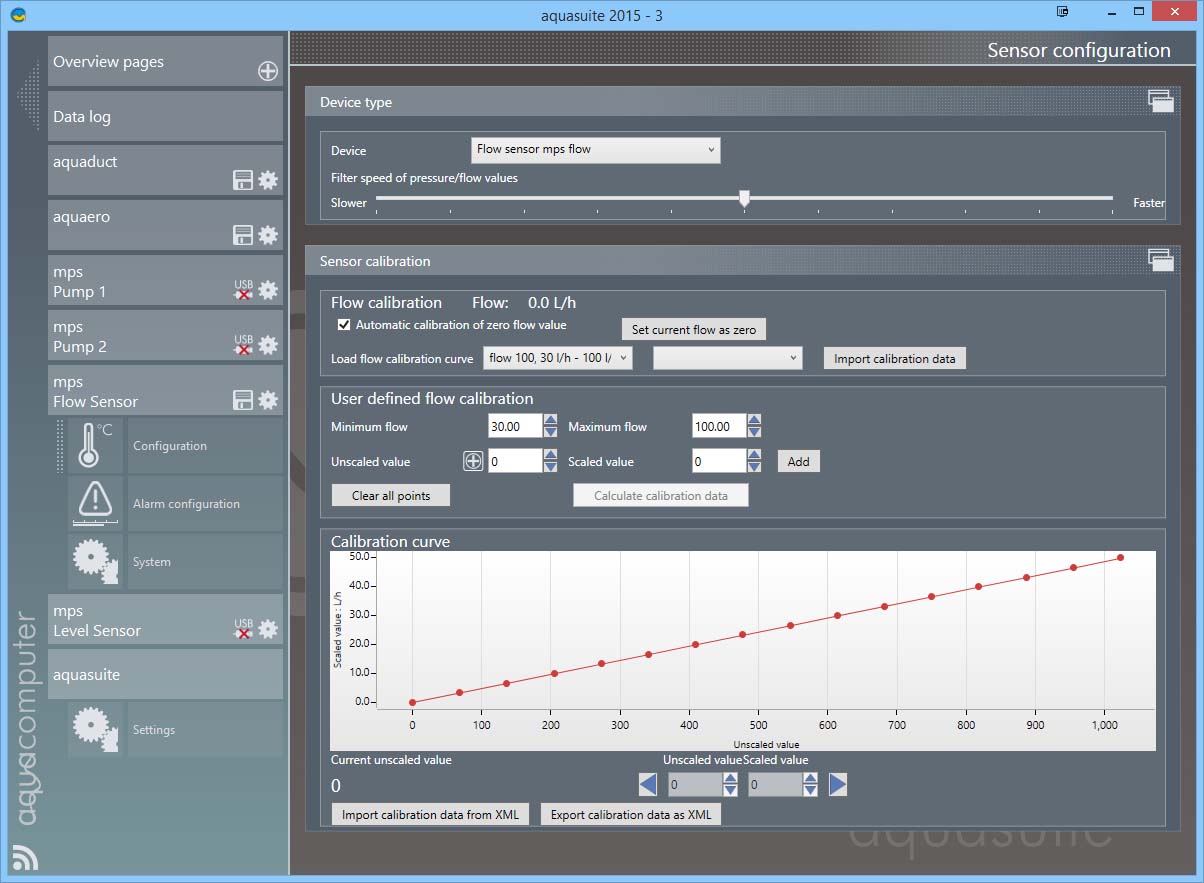

This "configuration" you speak of, that requires USB, what exactly is one configuring ?
USB is used to configure the device (screen shots below), and aquabus is used by the aquaero to read the device to use the sensor's output values for conditional control.
As an analogy, it is like using your video card driver to configure your video card and then using the output of the video card for your monitor.
