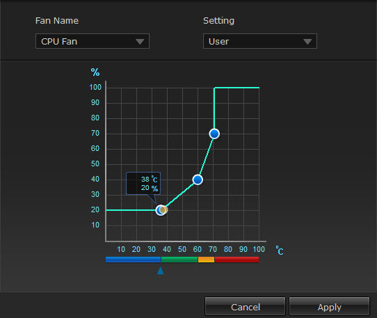

I'm sure.
I need increase in flow when cpu is over 4Ghz to 4,7Ghz (i7-3770k)
I have larger/broader steps for pumps than by fan, but pump still needs to be adjusted by cpu temp. (as I do now via MB)
Edit2: I have previously had my pump controlled by Water temp, but that is just too slow. The respons from the pump needs to be almost instant or the CPU is going to automatically stop.
Edit: this is my pump now:
»Dintid« hat folgendes Bild angehängt:
