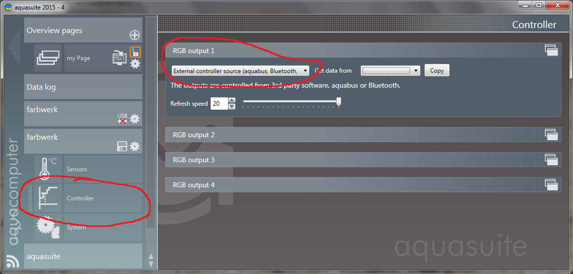

I just received my farbwerk. Connected it trough aquabus and USB.
My 5LT sees the farbwerk on Bus address 20. The device also appears in the device list. I can also adjust the color settings withint the device itself using USB, but how can I control the device with the aquabus with no usb connected?
Donnerstag, 26. März 2015, 14:05
I do not have a farbwerk nor the 5LT, but I believe under the 5LT tab, you select the "Controllers" Tab, click on the "+" symbol next to "Outputs" (upper right) & select "LED controller", and set it up there.
XenoMorpH
Donnerstag, 26. März 2015, 16:27
I did, but it does not work. I had 2 ledstrings attached to the controller, I could only select 1; Farbwerk(1) 1-R /G/B. But I was not able to control the colors either. What am I doing wrong here ;(
Donnerstag, 26. März 2015, 16:34
In the farbwerk setup you have to configure the farbwerks outputs as external controlled.
XenoMorpH
Donnerstag, 26. März 2015, 18:21
8| Is there any documentation on how to do so? I have no idea how to solve this (maybe I should make a different thread and not to hijack this 1).
EDIT:
Added the output and added the controller.....still not working.
Dieser Beitrag wurde bereits 1 mal editiert, zuletzt von »XenoMorpH« (26. März 2015, 20:29)
Railgun
Donnerstag, 26. März 2015, 21:11
Deselect switched output.
Freitag, 27. März 2015, 07:12
You have to set the output mode in the farbwerk to external.
XenoMorpH
Freitag, 27. März 2015, 15:40
:thumbsup: ...I completely overlooked that optinion :pinch: 8| All fixed now, tnx!!
