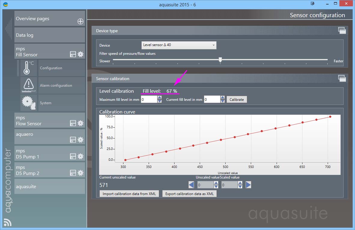

I believe the resolution IS the accuracy... 0.5 m for the delta40. The unit does not display mm of water column, but percent full.
To calibrate the sensor you provide the maximum fill level of the reservoir and the current fill level in the reservoir, from the bottom of the reservoir.
