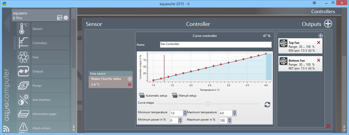

Mittwoch, 12. August 2015, 17:59
Not sure if this is useful for you, but I will toss it out in case.
I made a virtual sensor that is the delta between water-out of the radiator, and the ambient air temperature:
And then I control the fans with the virtual sensor:
So as the water-out temp rises above ambient, the fan power is increased, and visa versa.
This way the loop temperature floats with your ambient.
Dieser Beitrag wurde bereits 2 mal editiert, zuletzt von »InfoSeeker« (12. August 2015, 18:03)
