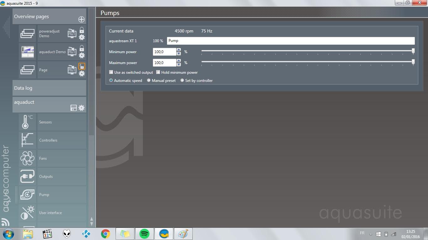

Can you post a screen shot of your pumps tab in aquasuite? (example below)

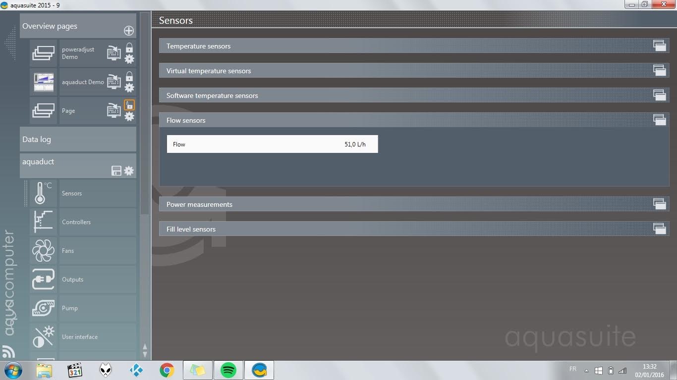

Thx for the answer, here the screen of the pump and the flow

I am not sure if the Minimum/Maximum power settings on your pump are used with the automatic control option, but having it at 100% for minimum and maximum could force the pump to 100%... which may have been your intent.
That said, the issue remains as to your relatively low flow rate.
Perhaps if you describe your system a bit... we know you have a CPU & GPU water block, but what size is your tubing, and how many 90° fittings, etc.,
Also, is there a way debris/dirt may have entered your loop during assembly causing blockage.
As a test, you could set your "Minimum pump value" to 30%, leave the "Maximum pump value" at 100%, then use the "Manual preset" option to move the pump power up/down and see what happens to the flow rate.

The 100% pump is intended. If the pump isn't à 100% the flow alarm ring cause the flow drop to less than 30l/h
