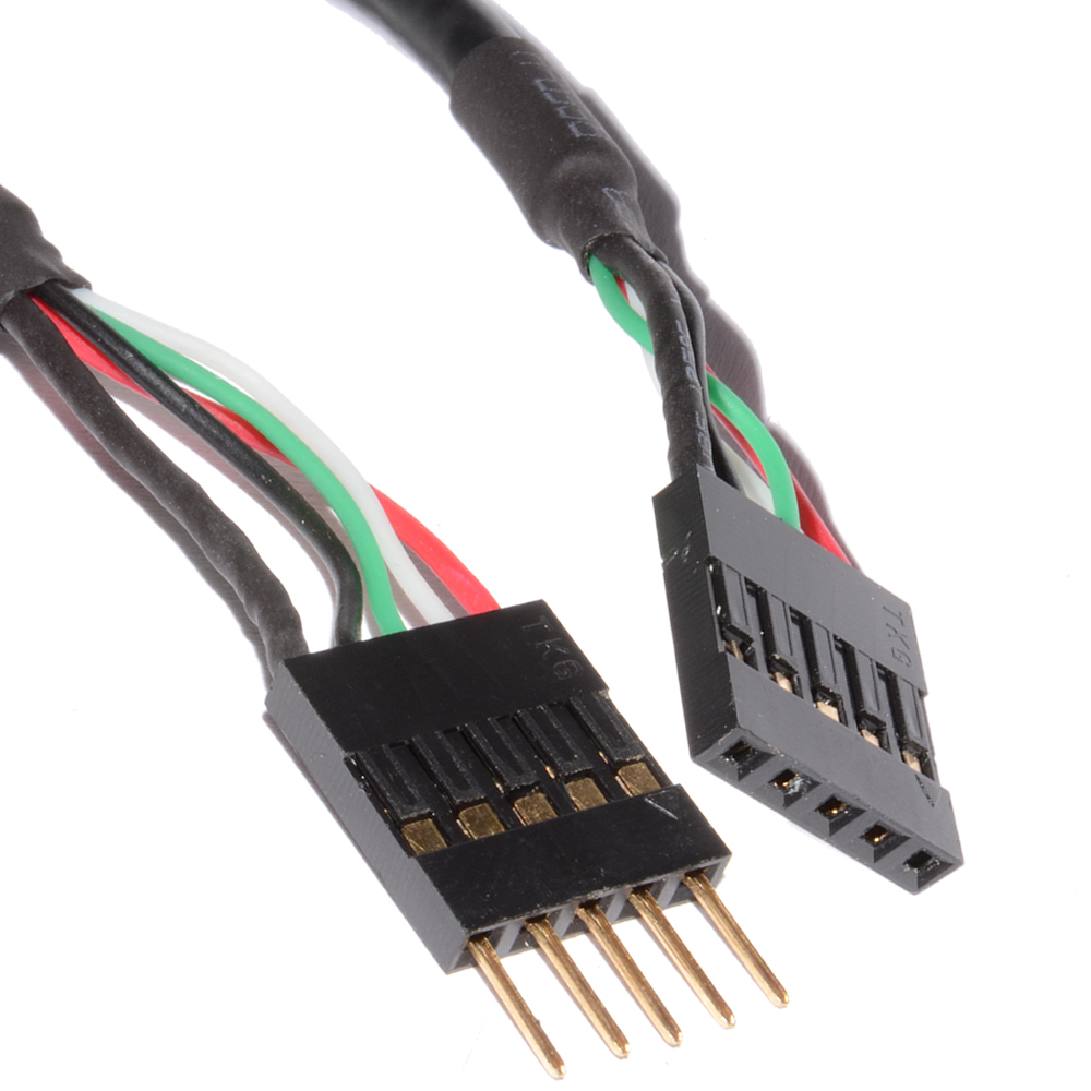

Railgun
Mittwoch, 6. Januar 2016, 11:38
Was the USB extender powered? How many devices were connected to it?
Which header are you connected to now? Have you tried using the other one? (If in USB11/12, use USB9/10 or vice versa.)
Don't know if the Asus boards actually ground pin 10, but ensure you're using the 5-pin side of the header and not the 4-pin. That NC/ground pin may help if you're not already using that.
ttrianon
Mittwoch, 6. Januar 2016, 23:30
Hi Guys,
Thanks for your help and sorry for this late answer.
@ InfoSeeker
To be really fair, I am not very keen in ground stuff...
I followed the installation guide and connected the AQ as it should be.
The ground connector is supposed to be connected if you connect the 5-pin
connector to the header... Am I correct?
I never had any problem with my rig before the AQ installation.
@ Railgun
I already removed the USB extender (it is exactly the one you listed).
So the problem was not linked to the extender.
My board is an Asus x79 one.
I confirm that I am using the 5-pin side of the header and not the 4-pin.
