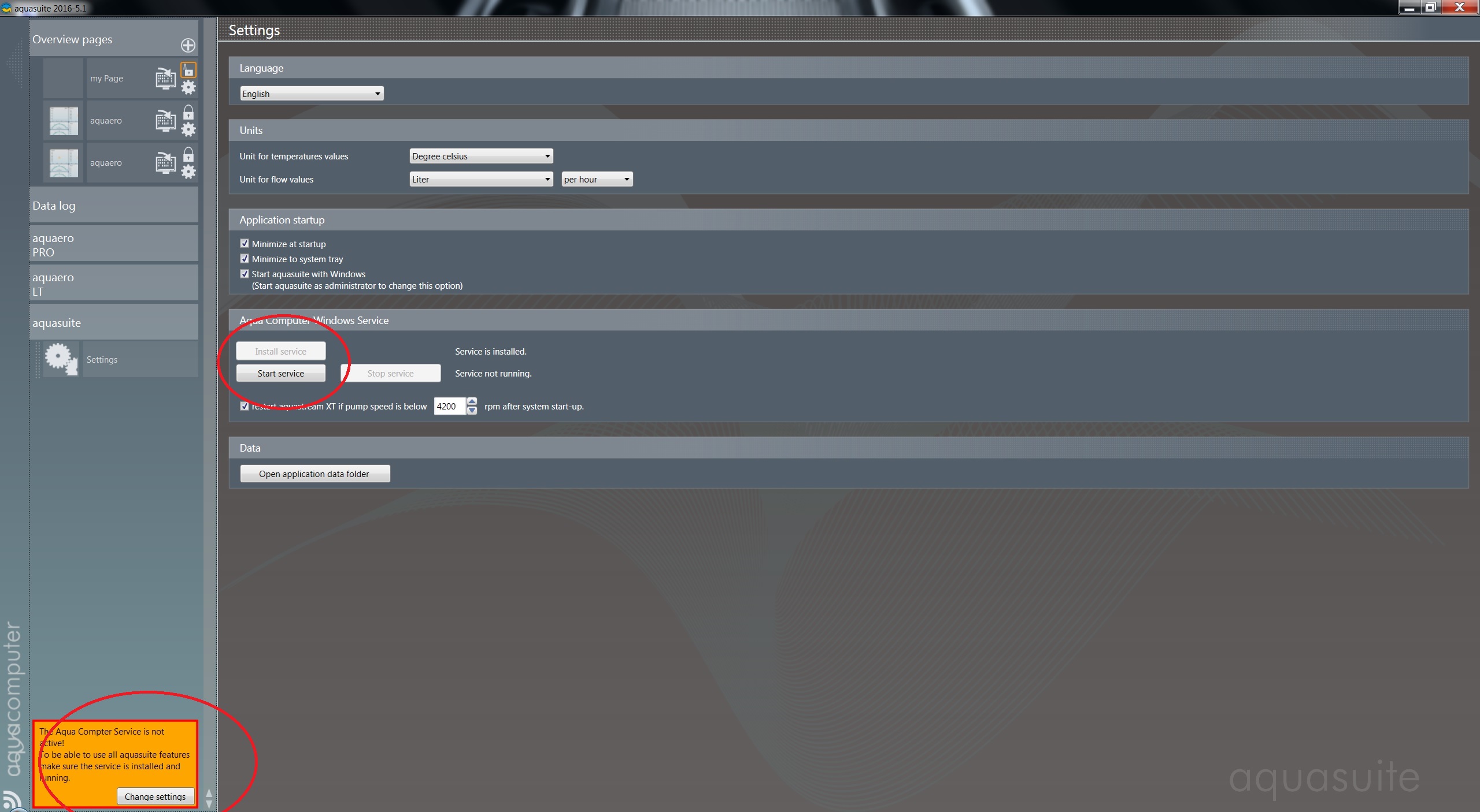

Hello All,
In aquasuite 2016-4 all worked good. I was inquisitive, so I installed the 2016-5 version.
Each time I start the computer, does not start AquaComputerService automatically, and I have to run it manually.
I tried a new installation (several times), cleaning registers ....., but without success.
Some ideas?
Exactly here demonstrates the truthfulness of the proverb: Do not fix what is not broken. :(
I thank everyone in advance for answers.
George

»AE5probigNGslave« hat folgende Datei angehängt:
Montag, 28. November 2016, 19:44
his version (5.1) did not change anything
post or send us an email with the errors from the windows event log. this is the only way to solve the problem.

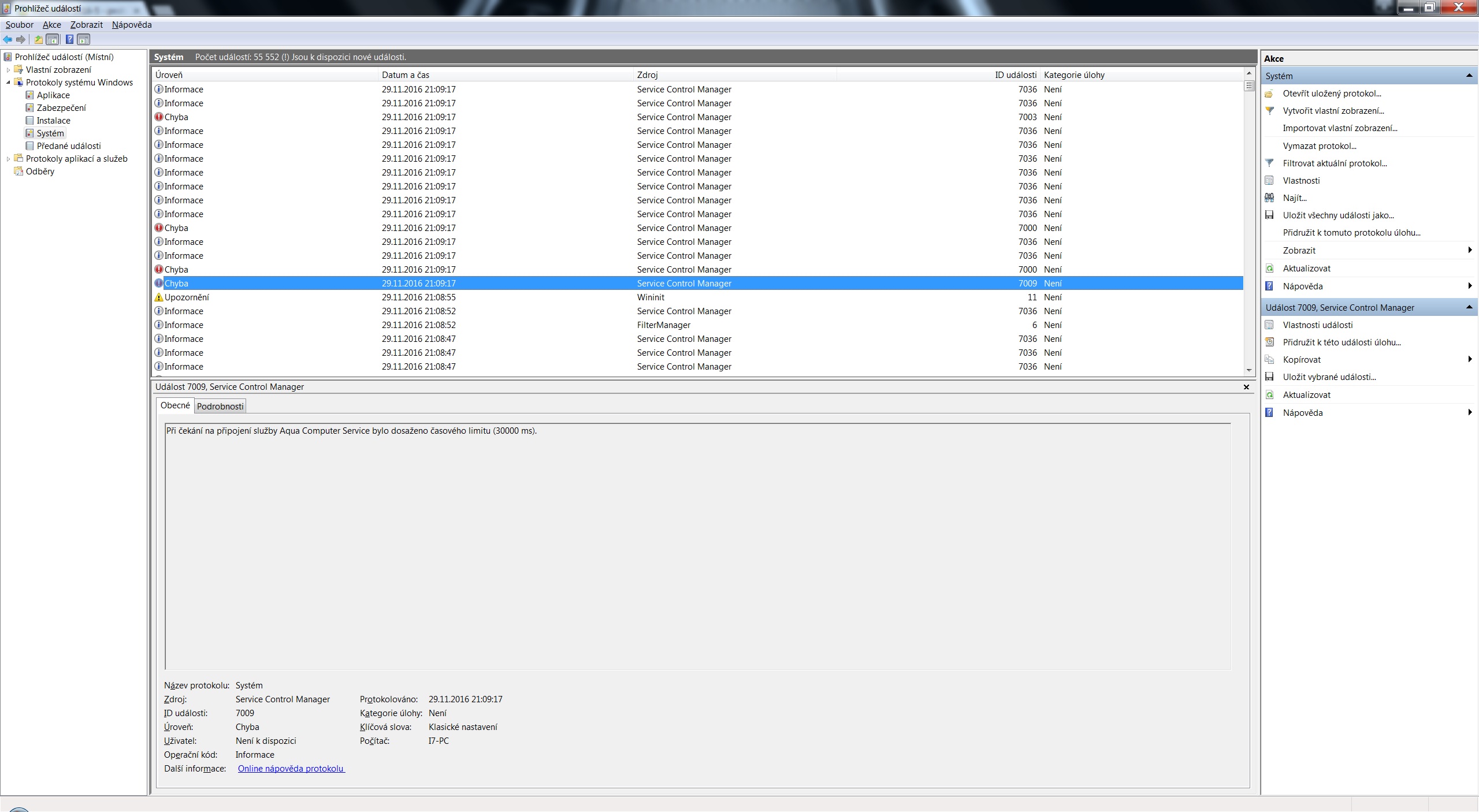

Hello Sebastian,
Please see attached 2 files with 2 errors.
Best regards
George

Dienstag, 29. November 2016, 08:42
This is not the message that we need. Please check again. There should be a short error report (the one that you have posted) which is not useful for us and an extended one. This is the one that we need.
Two examples:

AE5probigNGslave
Dienstag, 29. November 2016, 21:40
Two examples:
[attach]5858[/attach] [attach]5859[/attach]
Hello Sven,
Only two faults I've found on startup.
»AE5probigNGslave« hat folgende Dateien angehängt:
