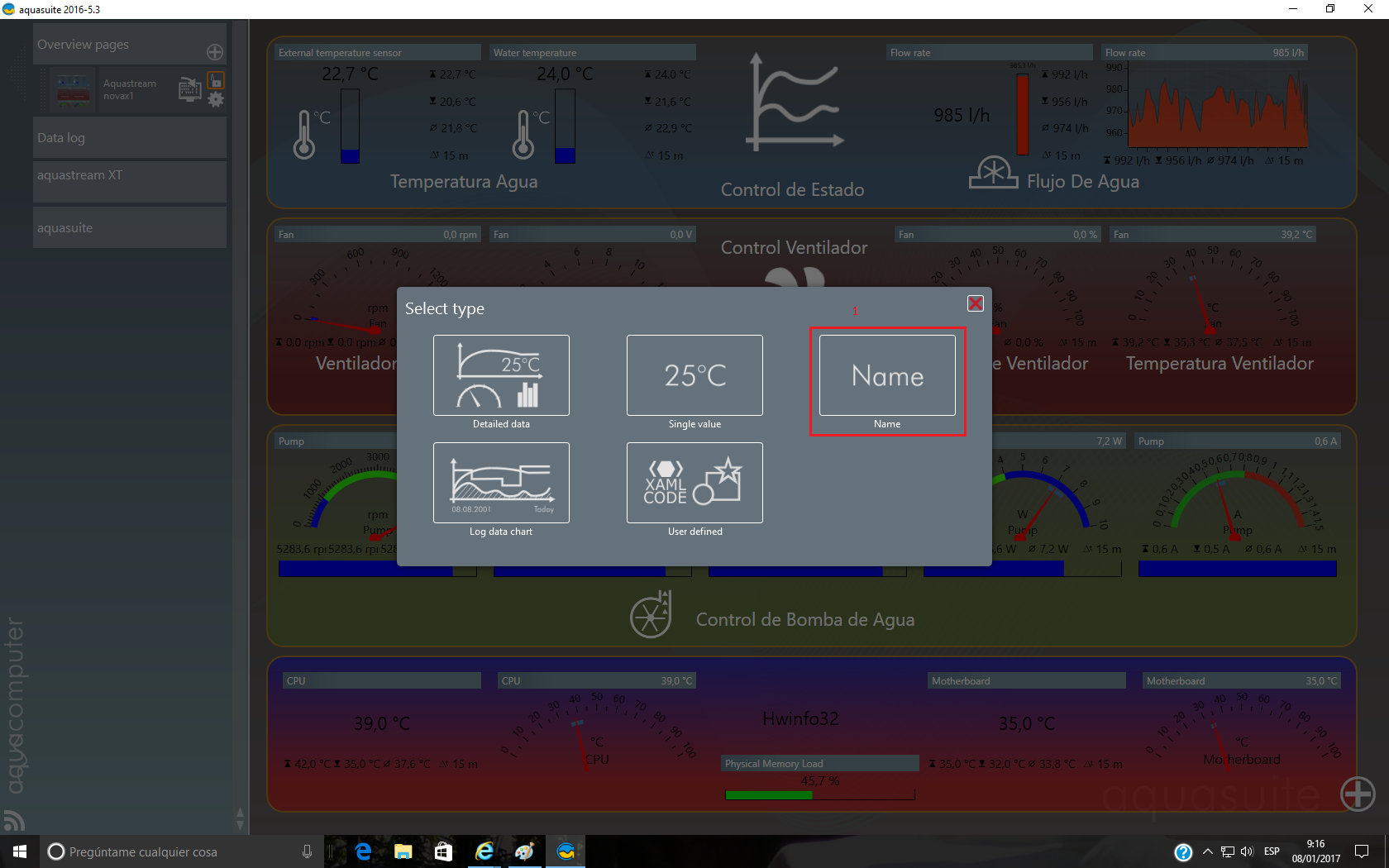

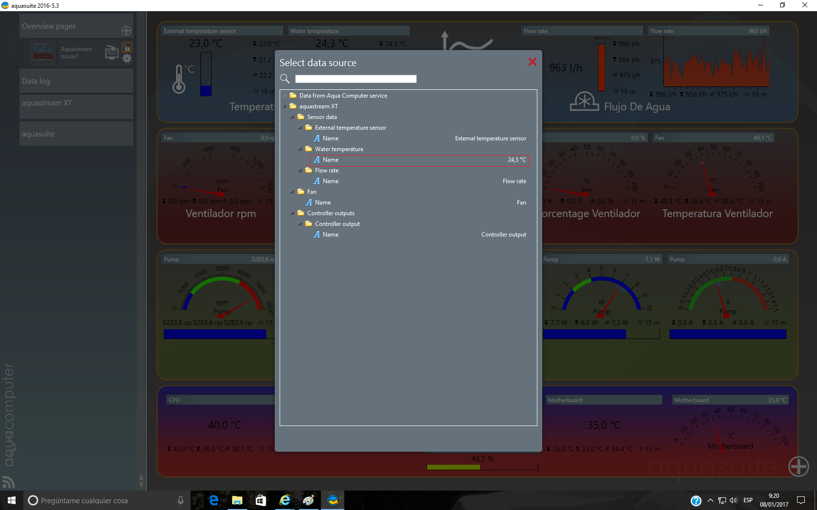

Hello everyone.
Happy New Year.
In the images that I show, and that indicates in red does not show a text, the temperature appears in its place.
regards
