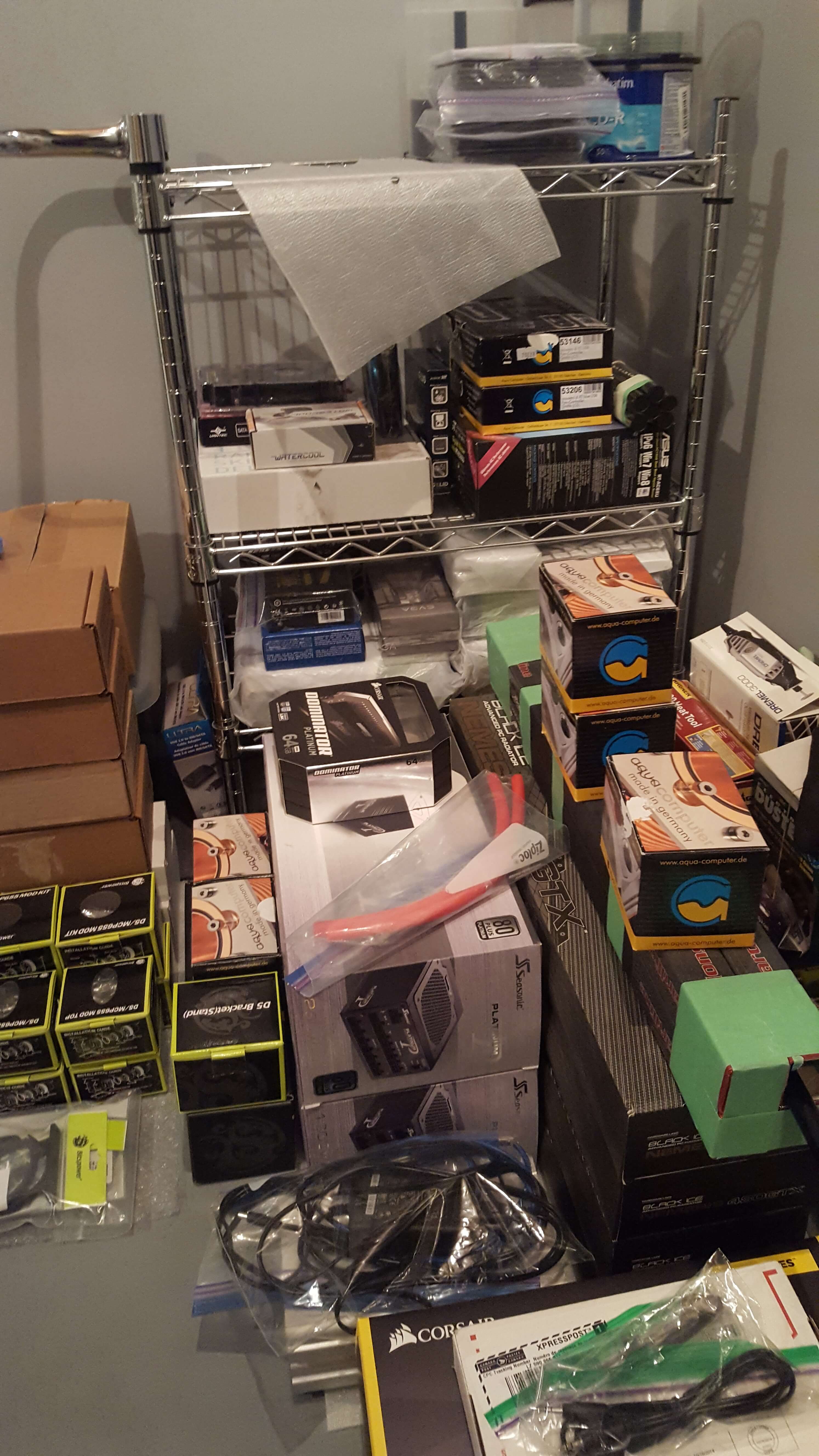

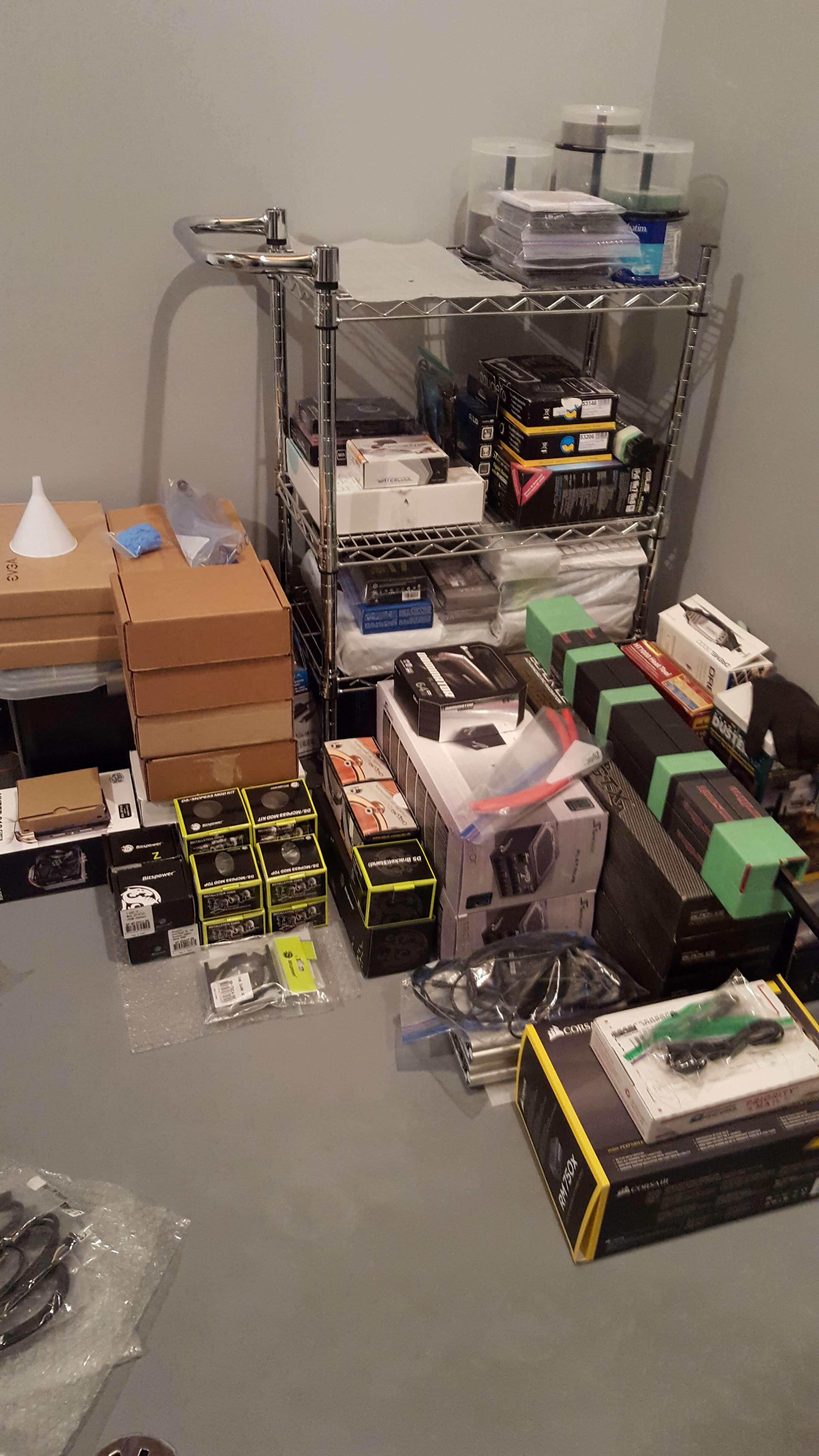

I have ton of components and I mean worth a bit, this is just few out of much more some in my storage, some at my office out of town :P most of the parts are been checked they don't require to take your system apart, pumps are little different, you cant run them dry and set up simple loop, even with just res.pump its time consuming, especially when you live busy life as is.
