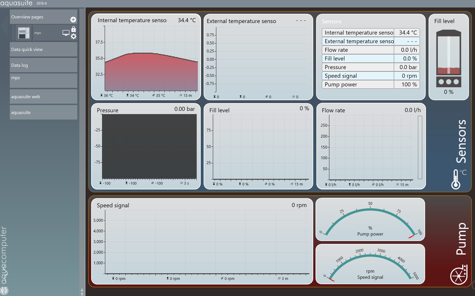

Long story short, I have the latest Aquasuite installed and I was prompted to update the device firmware which completed successfully. Everything seemed to be reading fine and I was getting a Temp reading, but I am not getting any information on my flow rate. I have changed my settings regarding flow rate to Litres per Min and Litres per Hour and vice versa but it did not make any difference to the flow reading as these sit firmly at 0.0. Even if I had installed the Flow Meter potentially the wrong way round, wouldn't I still get some sort of reading (Even if innacurate)?
Something worth noting, I also have the MPS 400 connected to my motherboards CPU Header and this actually reports a value of around 2700 RPM.
My Pump is currently operating at 3260RPM

Below the diagram you have an unscaled sensor value. What does it say?

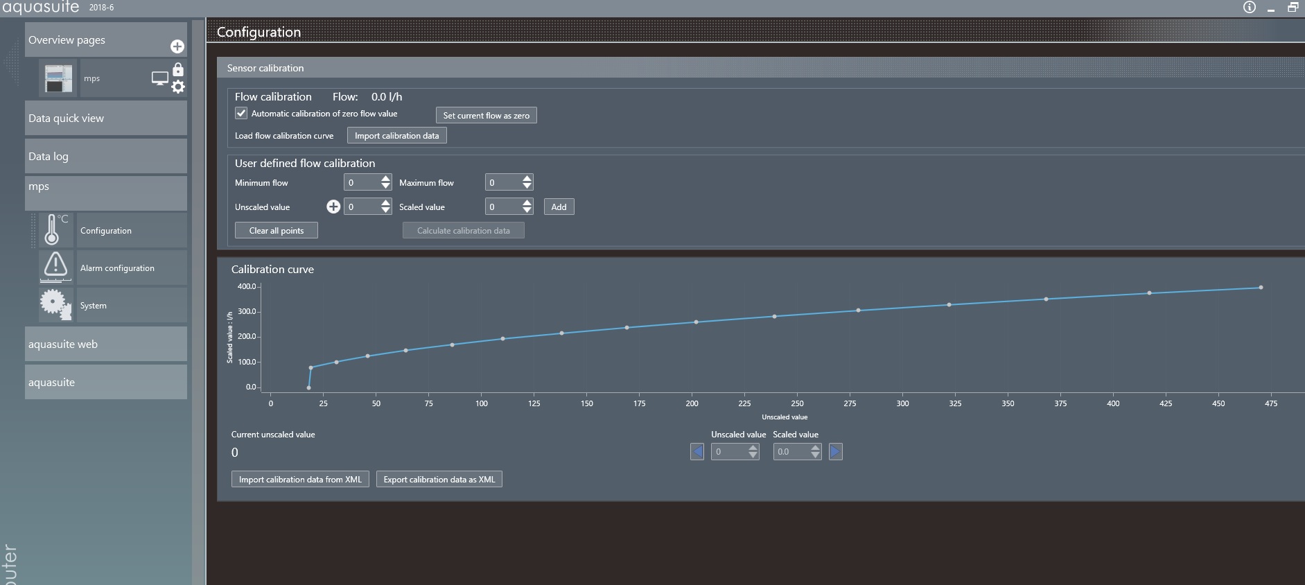

Thanks for your reply. It is showing 0 for Unscaled. For clarity I have included screenshots of what I am seeing.

I meant this one:

I meant this one:
[attach]6520[/attach]
Looks like my second attachment did not come through properly. However my ''Current Unscaled Value'' is 0
Thanks.

Maybe a problem with the automatic zero flow calibration. You could try to calibrate it manually. Go to the tab configuration and untick the automatic zero flow calibration. Remove power from the pump while the system is running (no problem as long as there is no load), wait a short moment to make sure that the water does not move anymore, click the button "set current flow as zero" and wait till the process is finished. Afterwards power up the pump again.

Hey, thanks for the advice, Tried that, 0 flow rate but do have an unscaled value of 14 now ?
