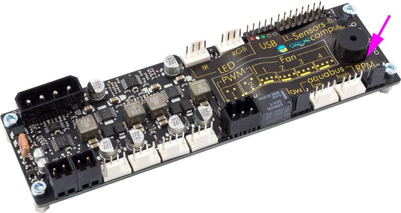

The aquaero RPM port generates a synthetic RPM signal that can be sent to the mobo CPU fan header.
[attach]7052[/attach]

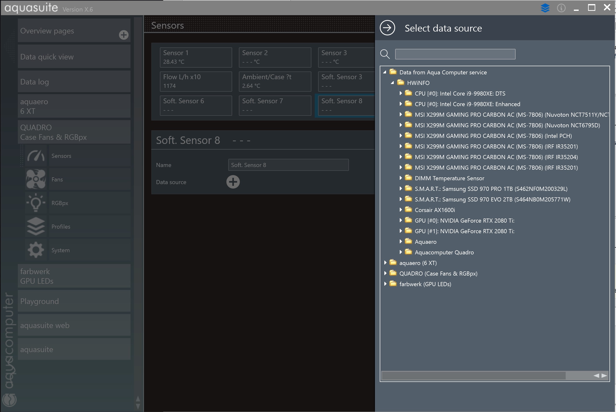

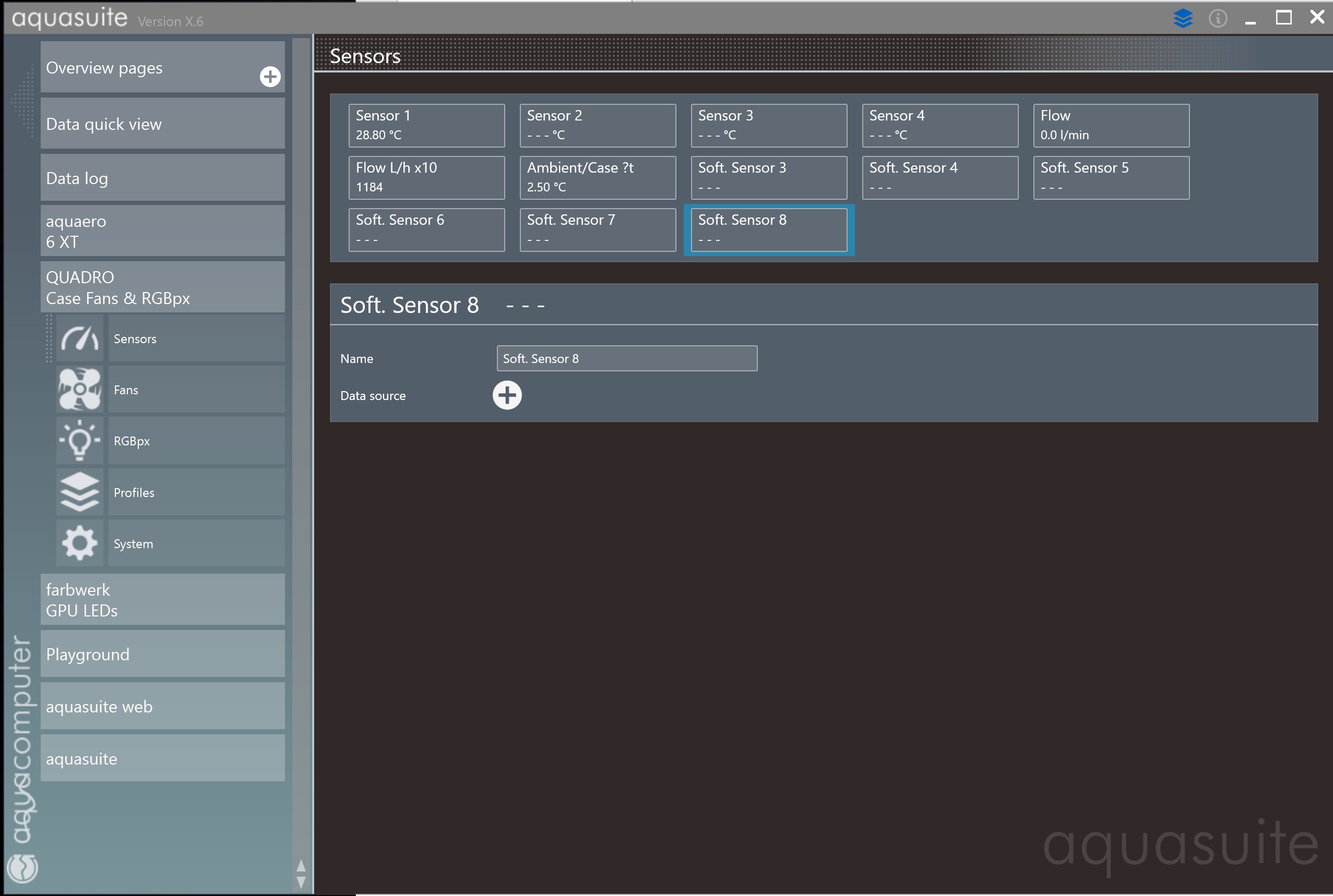

In aquasuite, under the quadro/sensors tab, select a software sensor (8 in the example below) and click on the + icon
Then select Data from Aqua Computer Service/HWiNFO/and navigate down to the CPU temp sensor

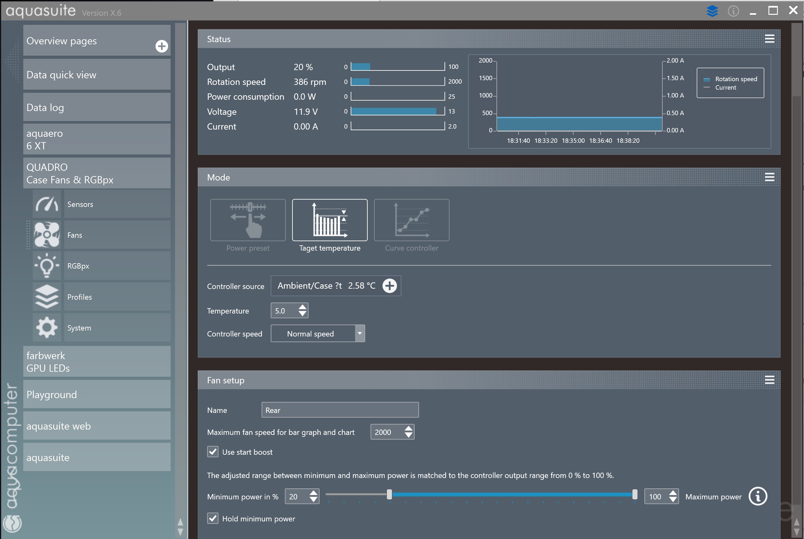

I used an existing fan controller for the screenshot, so the source shows Ambient/Case Δt (I guess quadro has same upper character issue as aquaero)
[attach]7053[/attach]
[attach]7054[/attach]
It should look something like this
[attach]7055[/attach]
Then go to the aquasuite/fans tabs, select the fan port (1-4) you want to control with this sensor, and set it up
[attach]7056[/attach]

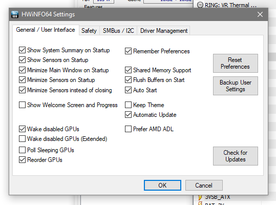

This seems to be working better than the AISuite 3 with the Asus motherboard. Thanks for all the help. I wish it would work outside windows, but the HWinfo program must be running. I had the change several settings if HWinfo so it would start on windows boot. I noticed my fan curve setting of -3 automatic keeps changing. Have I missed a setting on the Quadro/Fan setting menu? Thanks again!
»Hopper64« hat folgende Bilder angehängt:
