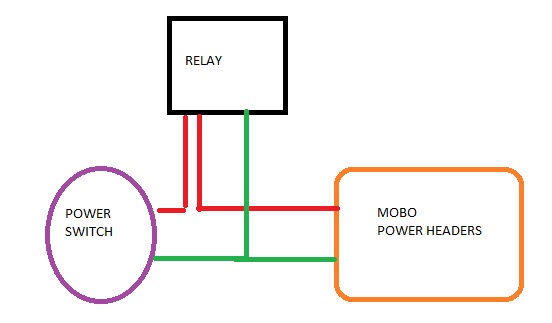

I'm running out of spare time to troubleshooting this, so, will the following diagram work? Theoretically, at least.
Do the power switch wires need to be connected like the red wire or like the green wire in the image that I've attached?
Thanks for your time.
