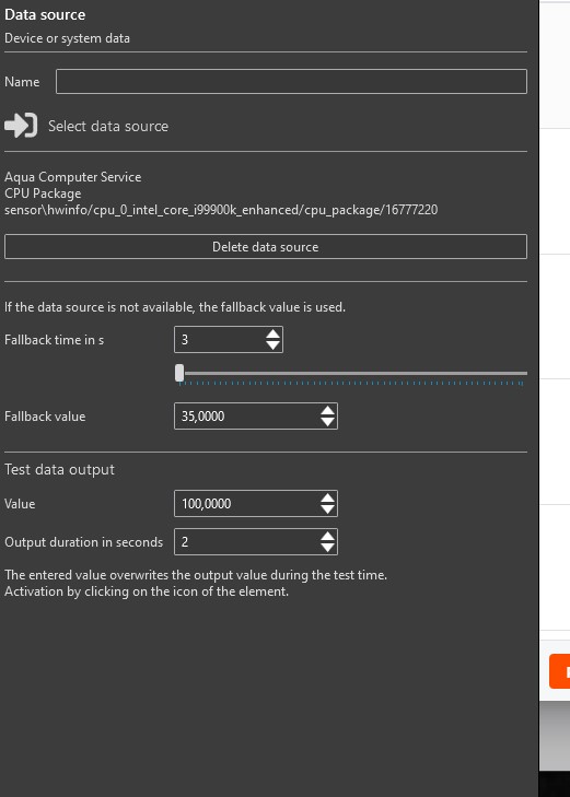

Also i've set up a custom one on which i do an average of CPU and GPu for intake and exhaust, do you think that's a good idea?
I've also a question about those fallback settings, it's not clear for me
thanks
Dieser Beitrag wurde bereits 4 mal editiert, zuletzt von »Asryan« (9. Dezember 2020, 14:44)
k2viper
Mittwoch, 9. Dezember 2020, 15:26
What is actually unclear with them?

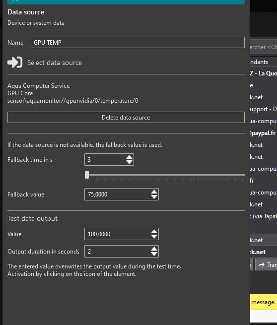

Read on your screenshot: If data source is not available, a value set as "fallback value" is used. The problem is that you start a PC, windows boot up and fans start running at 100%, making noise.
To avoid this, you need to set both your CPU and GPU data sources fallback values to the typical startup values. E.g. you start up your PC and typical startup CPU temp is 35C. Then set CPU data source fallback value to 35.
On your screenshot, fallback value for GPU is set to 75. I doubt you have such high gpu temp at startup.
Fallback time is the time fallback value will be transmitted to data source at startup or after the data source become unavailable (e.g. you uninstall the GPU driver and its temp monitoring becomes unavailable).

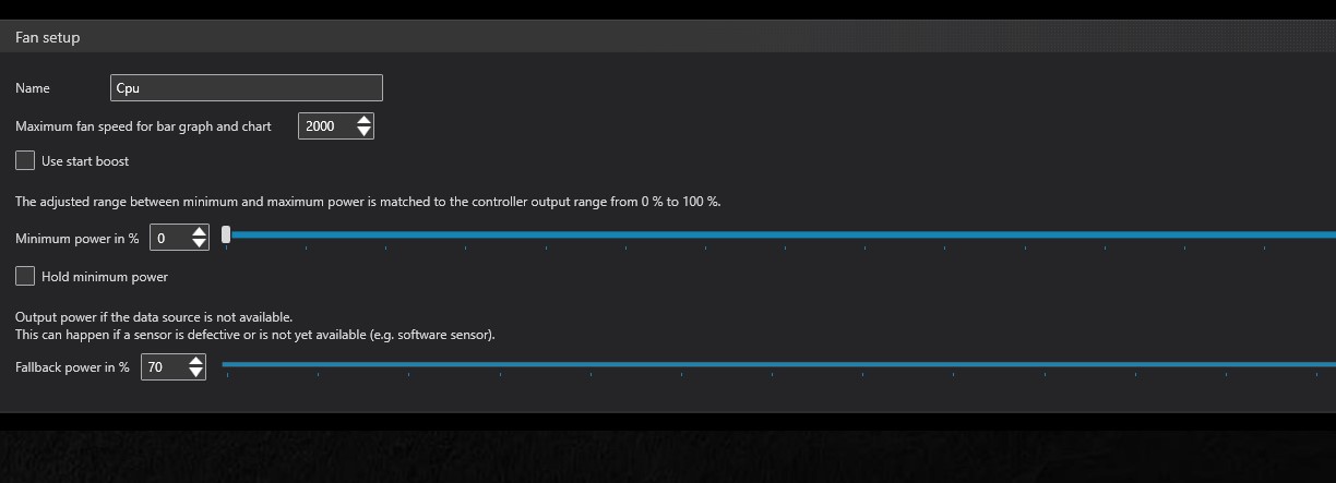

For fallback time it correspond to the time of what exactly?
And if the sensors are not working, it will use the fallback power set up in fans right?
And what about test data output?
Will it be good like this? thanks again

Fallback power under the Fan setup tab is used while data source (selected to drive current Fan's controller) is unavailable. E.g. you selected GPU temp or some virtual sensor created in Playground. But reading of GPU temp and Playground sensors are processed by Aquacomputer service, which is not running outside of Windows. So until Windows is start up or shutting down, this Fallback power will be used.
Test output value is for testing purposes when complex virtual sensors with many switches and dependencies are being created, outputting a set test value will help testing is output behave correctly with current scenario, or it needs adjustments.
Will it be good or not, you find for yourself.
