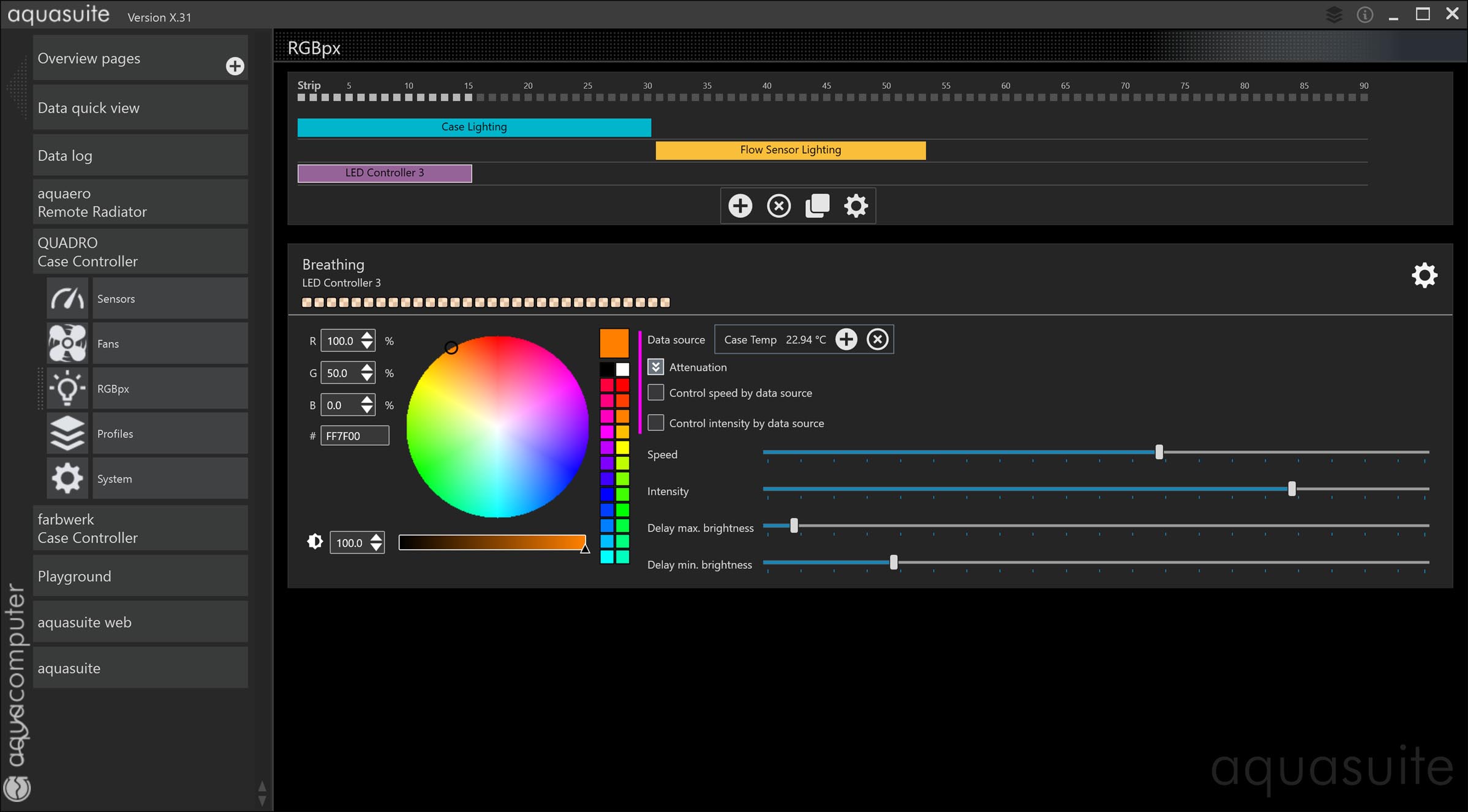

I have a quadro installed atm, probably similar to an octo for RGBpx, and some of the effects (didn't check all) may be controlled by a sensor such, as temperature.

So, can you set the rgb to turn red if your set temp is reached? Okay, just looked at your pic. Looks like it does what I want.To bad they are not in stock in the USA. Thanks...

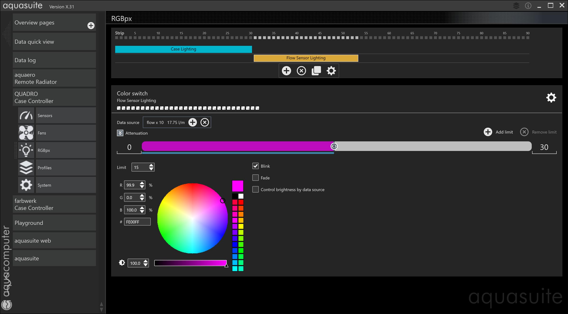

The effect you want is named "Color Switch".
It runs color 1 until the sensor exceeds the limit you set, then switches to color 2.

Not sure about Quadro/Octo RGBpx controllers, but with farbwerk360, "Color switch" effect gradiently changes set colors. Looks very good.
[attach]8017[/attach]
Yes, a quadro also has the Fade, Brightness controls available for those who prefer that.
