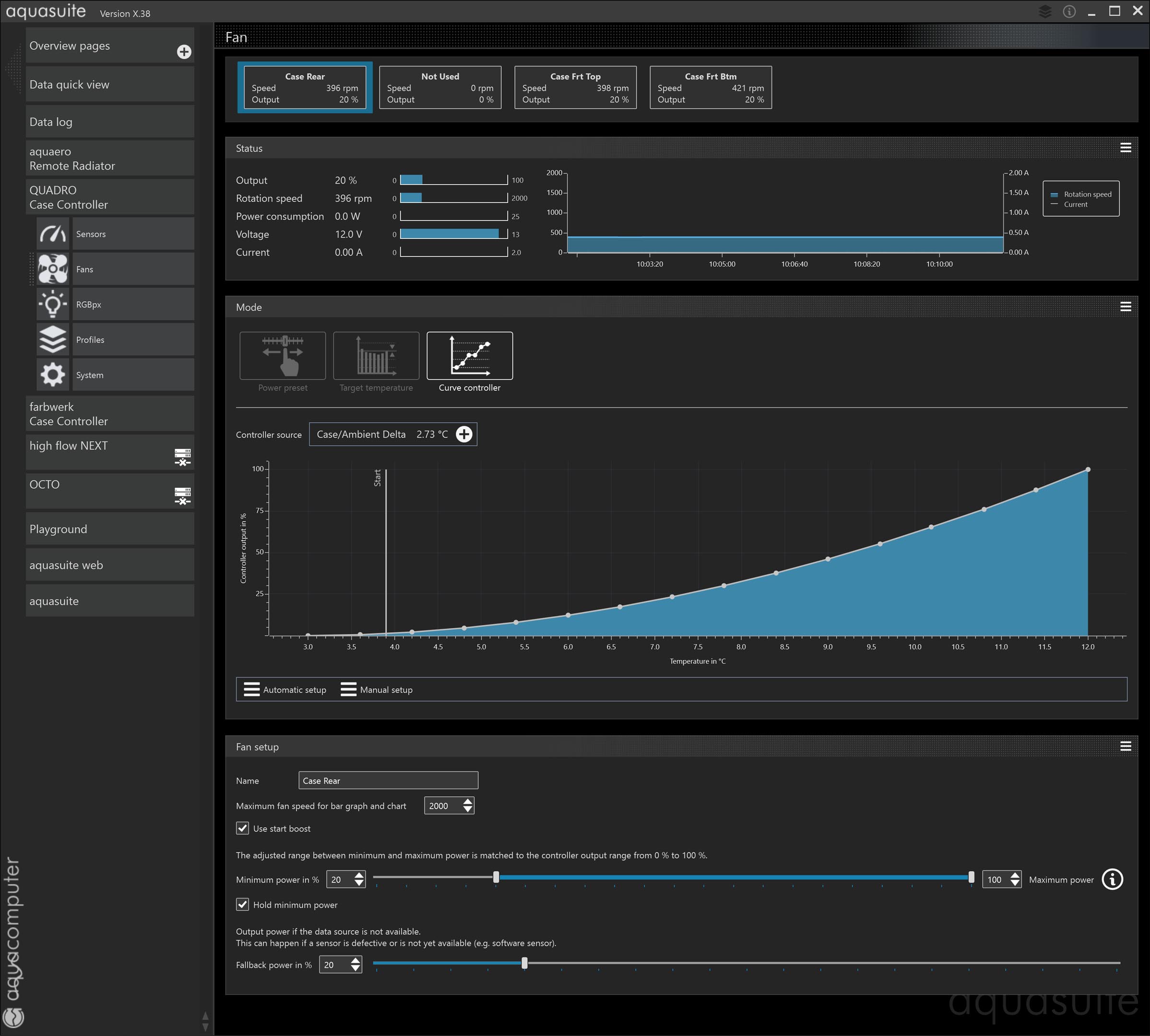

  • make a delta-t virtual sensor in the Playground (delta-t.jpg)

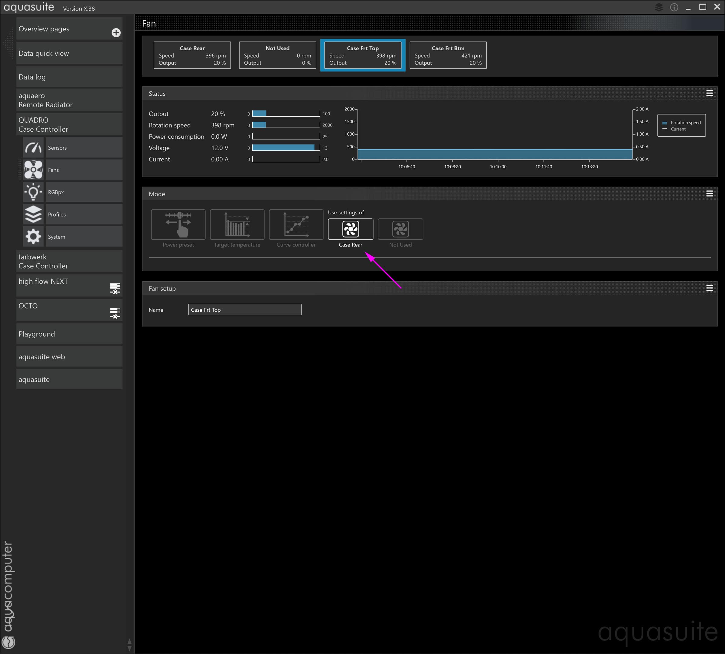

  • make a fan controller curve for fan port 1 using the delta-t virtual sensor to drive it (radfan1.jpg)
  • copy fan ports 2 to 6 from fan port 1 {all fans will perform the same} (radfan2-6.jpg)
You can do a similar thing for the case exhaust fan using a delta-t between the case and your taped outside sensor.

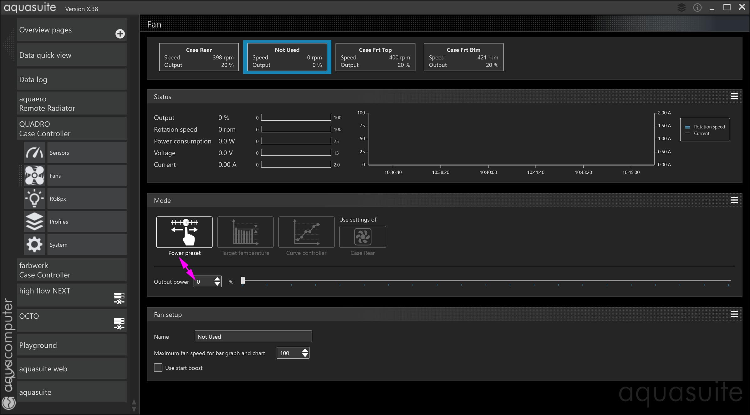

Hint: set the octo's controller for fan port 7 to a 'Power preset' controller, and set the power to zero to keep from getting a 'Low RPM' error message. (noerror.jpg)
