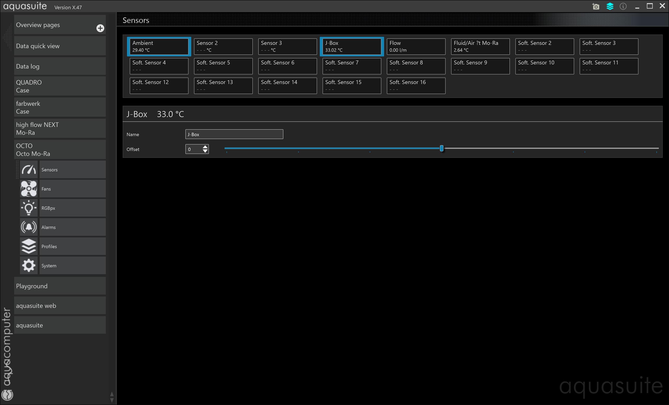

I have X47 and an OCTO, and it is reporting the two temperature sensors attached to it (x47_octo_t.jpg).
Not sure if it will help, but maybe reset the OCTO to factory defaults?
Difficult to believe both cables/sensors were damages during the upgrade.
