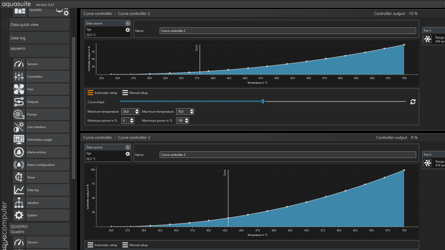

I have upgraded aquasuit from x.37 to X.47. My S.O. is Windows 11. Hardware is i912900k on rog maximus formula z690 + aquaero 6 + quadro + farbwerk.
Before the upgrade it worked fine. When the temperature dropped below the set threshold, the fans connected to that controller switched off. While now they continue to go indefinitely at the minimum speed. I also tried without aquabuss directly on the panel but nothing changes. Can anyone help me?

update all firmware on every device
Reset your devices to factory defaults.
Set up eveything.
When this is not working. Post screenshots from ALL settings you have changed in your devices.

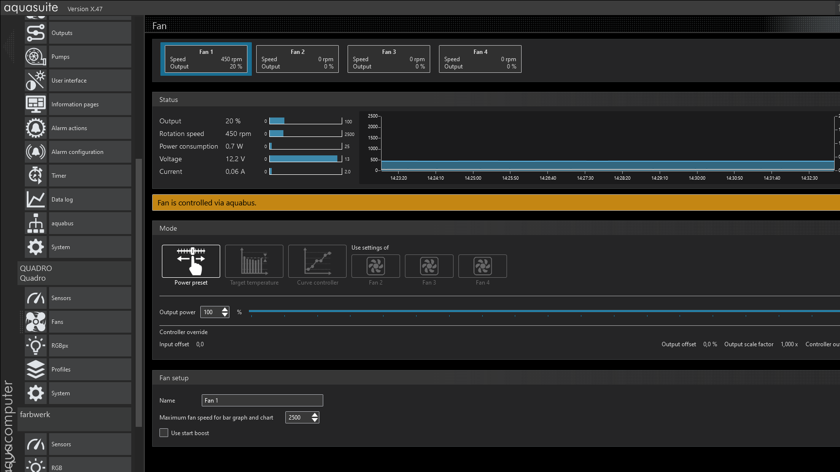

Asso
Mittwoch, 26. Januar 2022, 14:34
Done, but nothing changes.
It works fine 1-2 times then the fans don't turn off anymore.

Mittwoch, 26. Januar 2022, 15:53
The temperature must exceed the start value at least 1 time. Otherwise only the minimum power or 0% is output.
When the temperature fall below your first point in your curve, the fans are off.

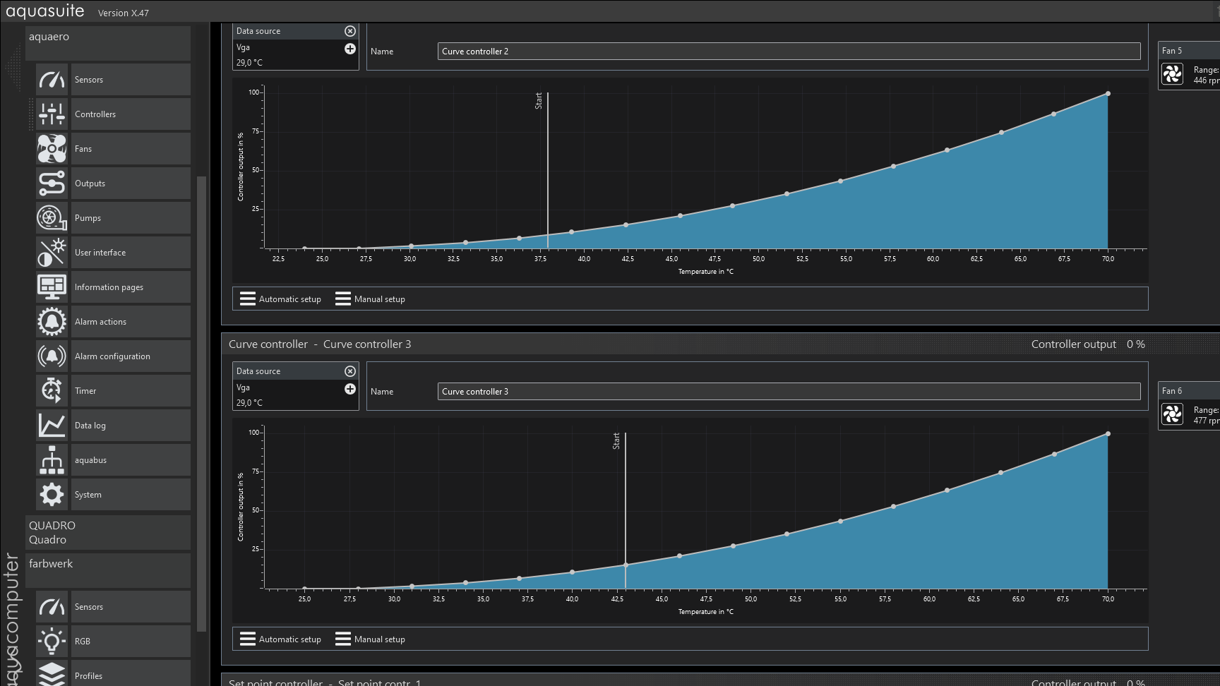

Asso
Mittwoch, 26. Januar 2022, 16:25
The fan never off.
You can see from the image that the sensor temperature is much below the starting point (Fan6), but the fan continues to spin.
And it was also in the previous screens.
Thx any way.

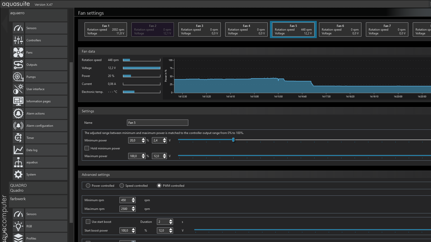

Remayz
Mittwoch, 26. Januar 2022, 18:36
on Fan5 settings you have the minimum power set to 20% PWM.
When the fan curve goes to 0%, it is 0% of the 20 - 100% range, which is 20% PWM
Maybe set the minimal power to 0% to allow them to stop?
Same for the minimum RPM speed just below on the settings screen
Mittwoch, 26. Januar 2022, 18:50
NO! Your temperature must be lower than 23..24°C (your first curve point). Your first cuve point must 0.0 not 0.1 or something like this.
Asso
Donnerstag, 27. Januar 2022, 00:02
Ok thanks, now it works correctly.
