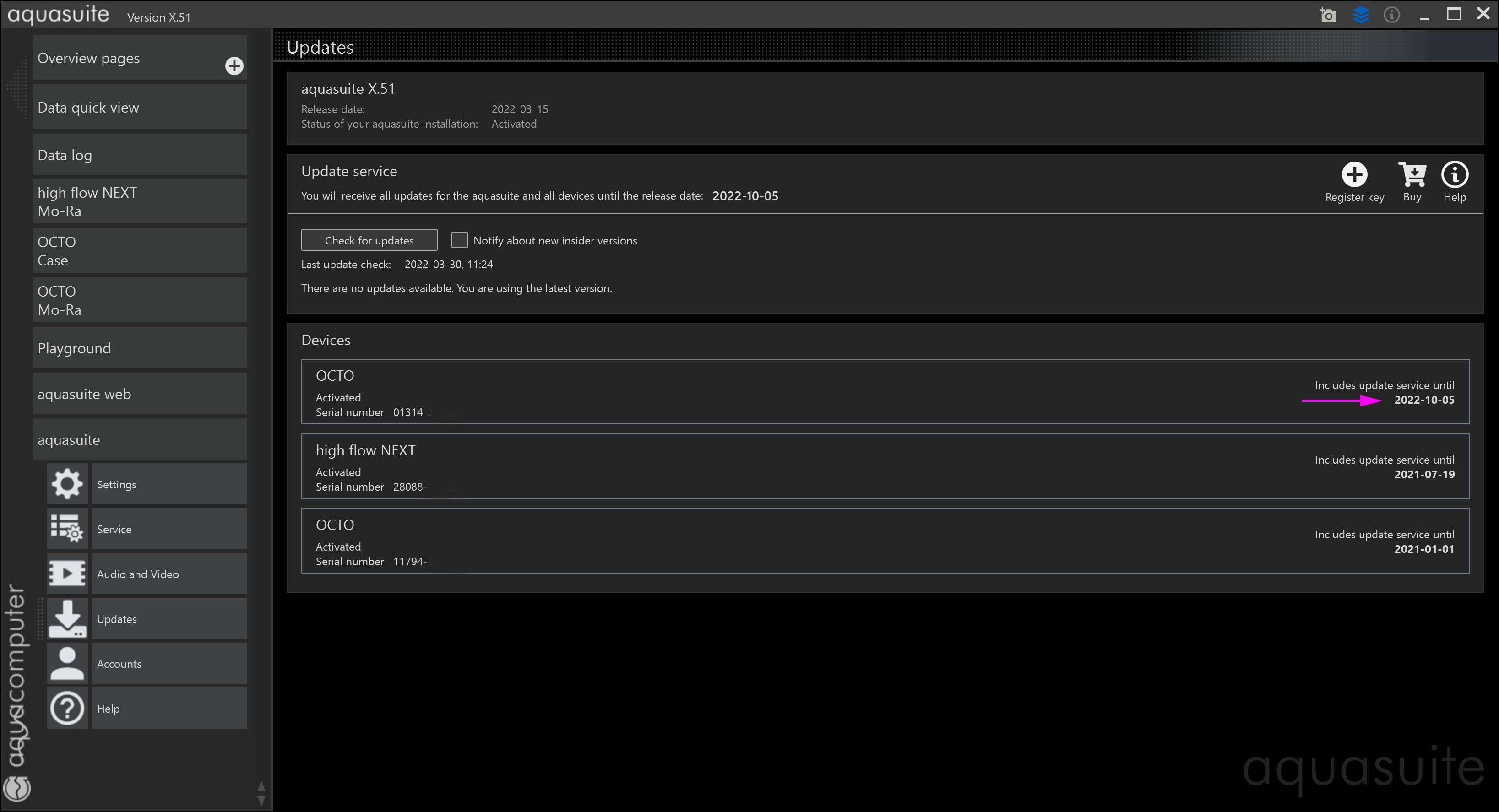

i've installed the latest update for Xsuite or whatever , which is released this month , if anything new releases and i update it will void my licence right?
Your license will never be voided. The license is tied to aquacomputer gear. You can see when your license expires on the aquasuite>Updates tab.
Your license (no cost updates) are good to the date farthest-out in the list. For me that is 2022.10.05. (license.jpg)
If you want to update after expiration (aquasuite &/or firmware), you will need to purchase another 1 year term.
Licensing is discussed HERE.
