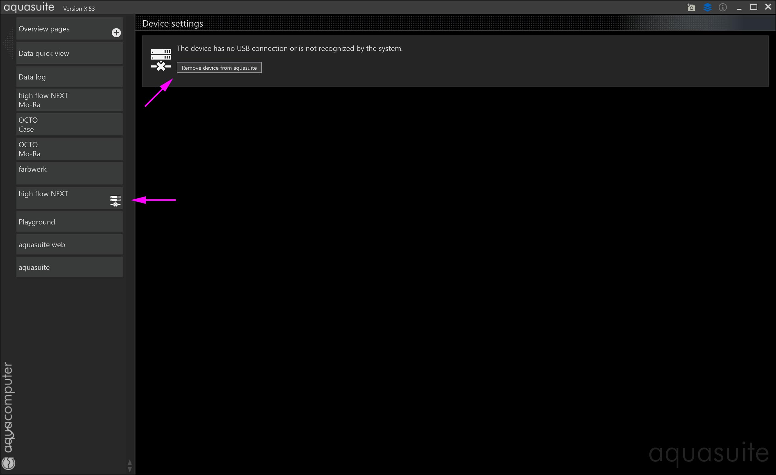

The devices aquasuite does not see have an icon with an 'X' on the right side of the device's tab.
Click on the tab, and you will be given an option to remove the device from aquasuit. (remove.jpg)
Click on the tab, and you will be given an option to remove the device from aquasuit. ([attach]9396[/attach]) . There is No X to remove the extra flow sensors. I tried to Screen Cap my Aquasuite , but the file is too large to send.

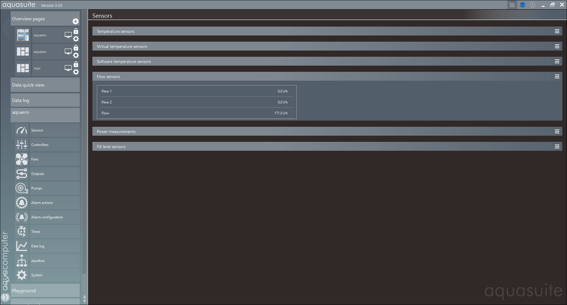

This is what I see in my Aquasuite.
Hufeisen
Donnerstag, 14. April 2022, 17:33
Is the Flow Sensor connected with Aquabus to an Aquaero?
If Yes, you have to change the Aquabus Adress in the Flow Sensor to the first one available (Bus Adress: 12)
If the current Aquabus adress is 14, it will show two empty Sensors in the overview page.

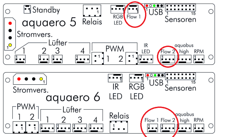

This is what I see in my Aquasuite. [attach]9398[/attach]
Flo 1 and 2 are the Flo connections on the AE, which are always there.
PS: Flow goes up as the water gets warmer!
