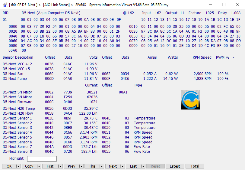

red-ray
Input Length has changed from 151 to 162
Samstag, 13. August 2022, 11:10
When I saw the posts about AIDA64 and the D5 Next with the X.57 update not working I checked what happened with my SIV utility and it worked with the 1024 firmware.
When I looked further the Input Length has changed from 151 to 162 so my guess is that AIDA64 assumes it's 151 whereas SIV uses the input length from HIDP_CAPS->InputReportByteLength. Given this I suspect AIDA64 should be updated to do similar for the D5 Next and all similar devices.
AFAIK none of the offsets in the first 151 bytes have changed and assume new items have been added in the extra 11 bytes.
When I looked at the AIDA64 dump it totally failed to dump the D5 Next data so I felt I would also attach the SIV dump.
»red-ray« hat folgendes Bild angehängt:
»red-ray« hat folgende Datei angehängt:
  • D5 Next.txt (5,05 kB - 311 mal heruntergeladen - zuletzt: 26. November 2026, 21:45)
